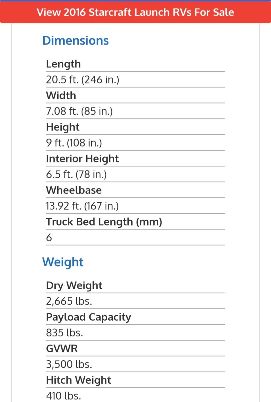

    Hey all. I have a friend that wants to take a road trip to the Grand Canyon with a camper trailer. This trailer has a dry weight of 2665 and, per my specs, my SR has a tow capacity of 3500. Would that be too much weight for a 1,000 mile trip?
    I don't have a tow package and I don't want to stress my truck out. Would you do it?

    The hitch weight is already over your max. (Max is 350 with the 2.7 and 3,500 capacity.)
    Plus you haven’t accounted for anything you put inside the camper.
    You also need to account for what’s in the truck.
    You’re asking a lot from the truck.

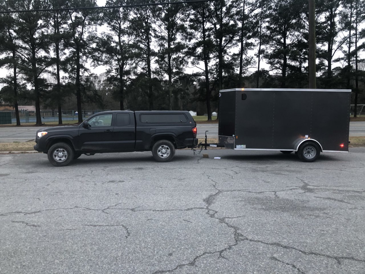

    added rear seats access cab LEER 100R Curt hitch receiver Curt trailer lights Carthart seat covers 255/85/16 Toyo MT for trails 265/70/16 W/ OR wheels for DD TRD PRO skid OR fuel tank skid Warn tubeless winch bumper Smittybilt XRC 9.5k winch HS 1/4 inch coil spacers RCI rock sliders Wheelers 1.5 AAL Bilstein 5100 rear Decked
    I have a 19 SR 2.7 4x4. I added trailer hitch and lights. This enclosed trailer weighs approx 2200 pounds loaded. Plus about another 400 pounds in/on the bed between tools/camper shell. I tow like this about 100 miles a week, 60% interstate 40% city. I have no issues. It depends on how much extra weight you’re going to add to the trailer/truck. But I would have no problems towing 2500-3000 pounds 1000 miles if it were me personally. Towing scares a lot of people in here for some reason.

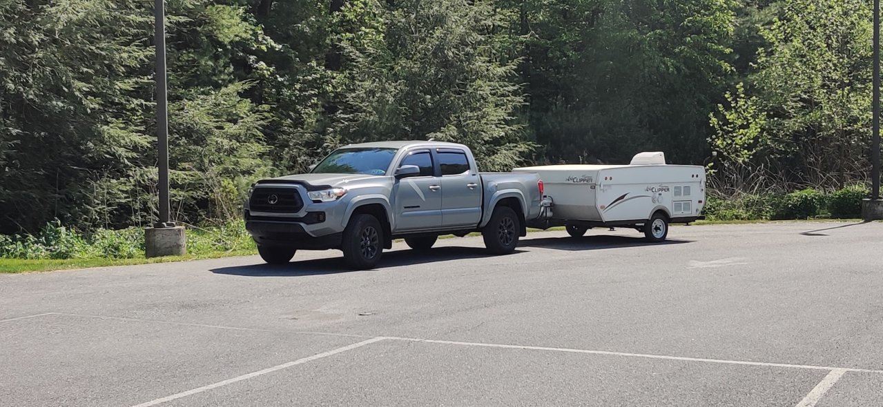

    I think with a hitch and a brake controller you could do it but it won't be comfortable.
    I think if you look for something else to camp in like a teardrop camper or pop up that would be lighter and have less wind resistance you would be ok with the I4 engine.
    I tow a Pop camper with mine but I have a v6 SR5 and it seems to do really well. It still doesn't match the low end torque my Liberty CRD turbo diesel had but it's got no problem keeping up with 65-70 mph highway speeds.
