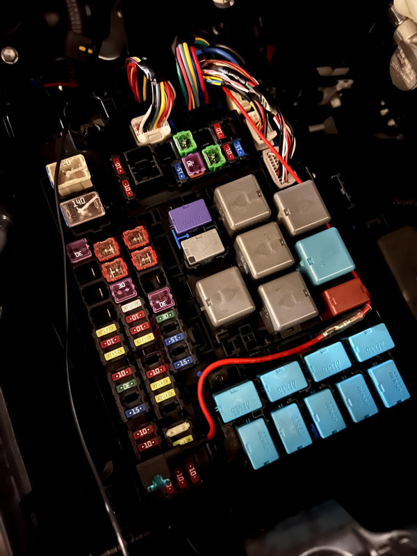

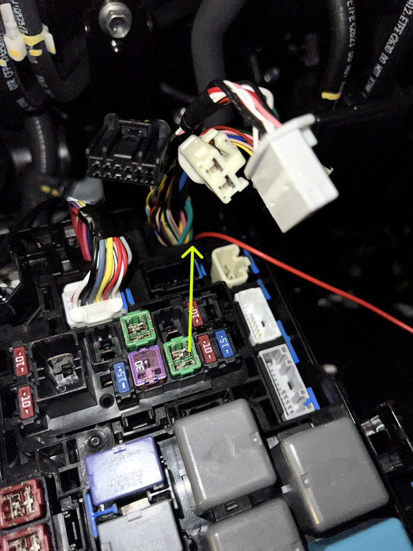

    There's so much conflicting information on forums, Reddit, and YouTube so thought I'd outline how I installed the "raptor" lights.
    I wired mine to my headlight fuse because I a. don't trust cheap lights anywhere near my ignition fuse, and b. I didn't want them running at all times when the truck was on. I just want them on with the DRL's and/or headlights. Once I narrowed down the fuse, I used the included Add a fuse tail.
    I'm including some photos because it was hard for me to see how folks got their wire into the fuse box. There are so many videos on YouTube where they're simply throwing it over the side of the box and shoving the cover down on top of it. Many people with sliced wires I'm assuming. I saw several actually cut reliefs into the box itself, just asking for water to get in there . I read mentions of feeding the wire through the harness, but couldn't find any photos or video, so hope this might help someone else.
    I unfortunately didn't take photos with the tape removed and before I threaded the wire through the surround, but there's electrical tape wrapped around the wires and surround that clips into the fuse box. I removed the tape to make it easier to pull the surround out of the box (also not shown :/). Then it was simply running the power wire in with the rest of the bundle and re-taping (I used self-fusing tape). Make sure the tape wraps around both the wire bundle and the bottom of the surround that clips into the box to make it water-tight.
    Pulling the four harnesses out made it much easier to work in there. You can see the red power wire threaded in with the rest of the bundle.
    I then routed the wire through some gaps between the fuses and popped the add-a-fuse to the headlight fuse. You'll see that my wire is a little tight at the top in this photo, but I gave it a little more slack before closing everything up.
    This is much easier than it sounds and way better than cutting a hole in your fuse box or crimping wires along the edge.
