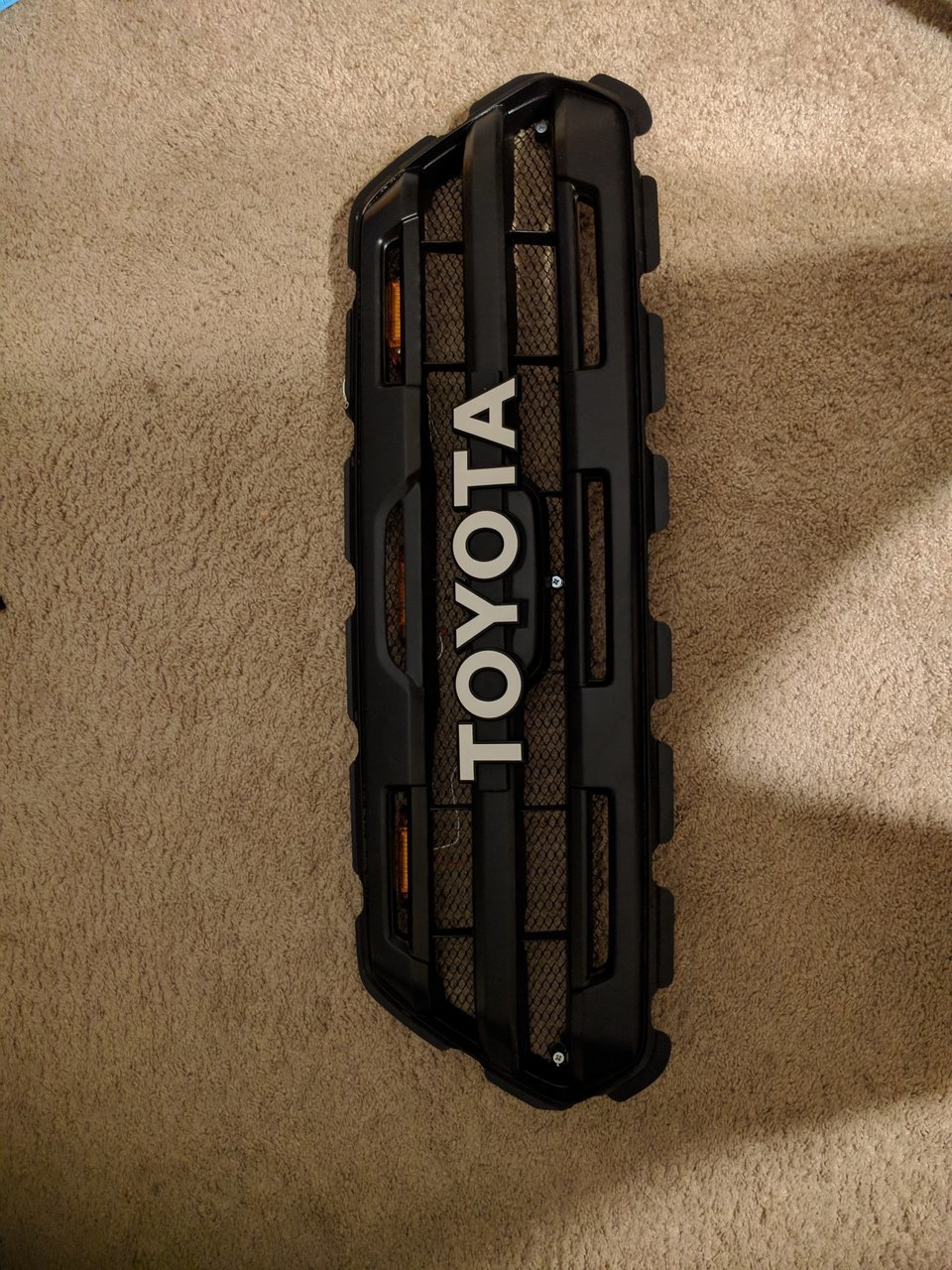

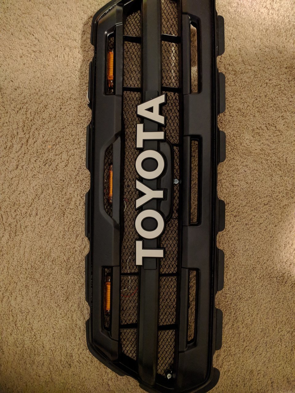

    I went a step further and glued abs pieces in the center because I didn't like the gap that remained after I removed the Toyota emblem. I used Goop, and I am surprised how well it help up. I put 8K in miles on the grille include going off once a month. Nothing failed.
    Well.. the center light failed because of how I mounted it. The metal grate in the back cut into the ground wire. I just removed the center light. I think it looks better and now, it's not "Raptor inspired" anymore, which I felt was bunk.
    I wired the three Amber clearance lights to the amber side marker. I used the stock ground terminal as a ground.
    I liked how it came out, but I just ordered a $90 Pro knock-off.
