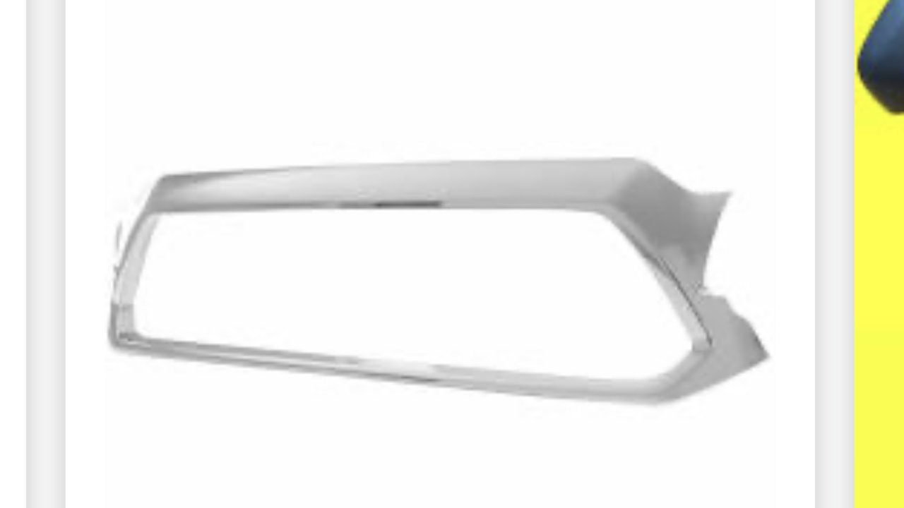

    This piece will fit 2012-2015 no issues. You’ll be fine. 03D5D52F-FCFD-4DCA-8552-6CEB7C62CB8D.jpg
