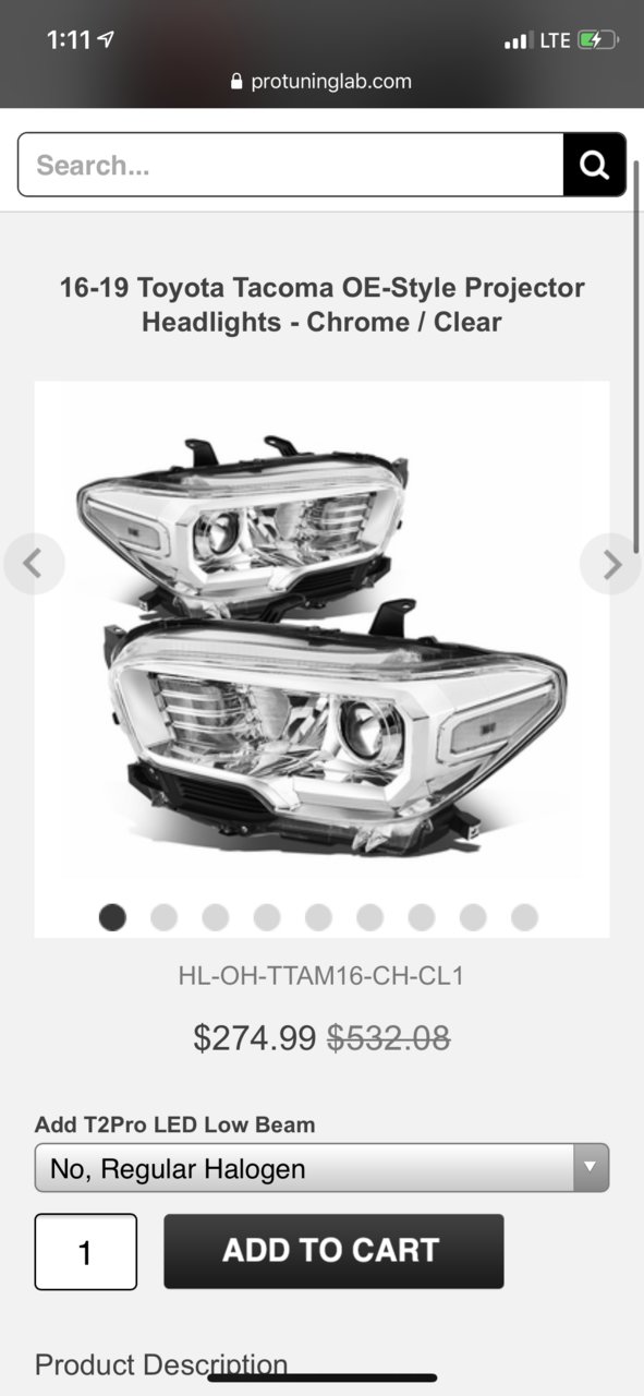

    Does anyone know if i can run a sr5 headlight on a trd off-road? because I like the way these look but they fit sr5 models. Could i just leave the drl wiring unplugged cause i don’t care much for the drl stripe?

    If you dont care about the DRL, it would be really easy to do
