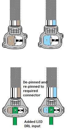

    Your reading needs to improve. The OP has a vehicle with LED DRL' s and wants to use SR/SR5 headlights. Disabling in this case is not using the wire in the 4 place connector.

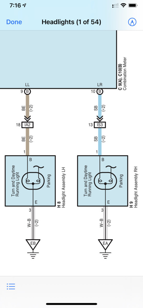

    I can read fine, perhaps you need to reread the OP:
    So if the OP wants the amber DRL then the turn signal and DRL need to be combined as the SR/SR5 amber DRL uses the same bulb and the same filament as the turn signal. So if the DRL is on the signal will not flash because it would still be receiving constant power from the DRL. Now that’s not an issue if the DRL is completely disabled but he stated he wanted amber DRL.

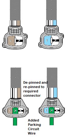

    No need to duplicate EXACTLY what the SR/SR5 headlights need. His vehicle has the input from the LED DRL already. He can substitute the parking input for the DRL, and he gets TURN & DRL.

    The dimming part is not the easy part of the request.
    Combining the input (DRL & Parking) into an available module does not dim the turn signal, just switches source and intermittent feature.

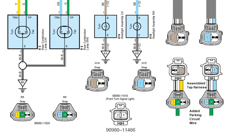

    That would just switch power input, not intensity.(dim)
    There is a way but it would be a little complicated. Adding a module to the Turn bulb to act as TURN and DRL. That would be using a dual filament bulb. Then when the DRL are Dim, the low filament could be ON for a dimmer look, while still having the HIGH filament as TURN still.

    The rear lamp assembly's Stop and Parking bulb holder fits into the headlight turn signal bulb socket without modification. The connector to it would need to be incorporated into the modification of the circuit.
