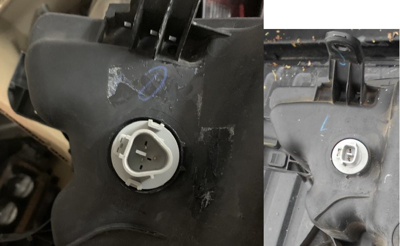

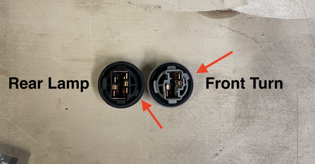

    It looks like this might not be the case at least on my '19 OR. I pulled the rear plugs and my front turn signal and they are slightly different. So the question is whether the SR5 headlamp turn socket is different (in that it matches the rear) or is the socket the same as the OR but I just need to use the SR5 plug?

    There are 3 bulb holders in the TAIL light assembly, one obviously is not the one, (Back Up lamp), you have the TURN & TAIL and the STOP & TAIL. Did you removed and compare these with the front TURN bulb holder?
    Headlamp TURN bulb socket with Rear Stop & TAIL. ---------------Headlamp with TURN Bulb Socket.

    Yeah I checked both non-reverse plugs and even on both sides to make sure. I can double check again later.

    i checked. neither of the rear bulb holders fit in the headlight housing. any chance the sr bulb holder would fit? is it an orderable part?thinking of depinning the harness side plug, adding a wire and switching the harness side plug to match the bulb holder.

    That's what I've been trying to figure out. I've posted a few times in the SR thread asking for a pic of their socket but no luck haha. I've tried to search parts online but the images and diagrams aren't detailed enough to tell if they match the front turn socket of a TRD.
