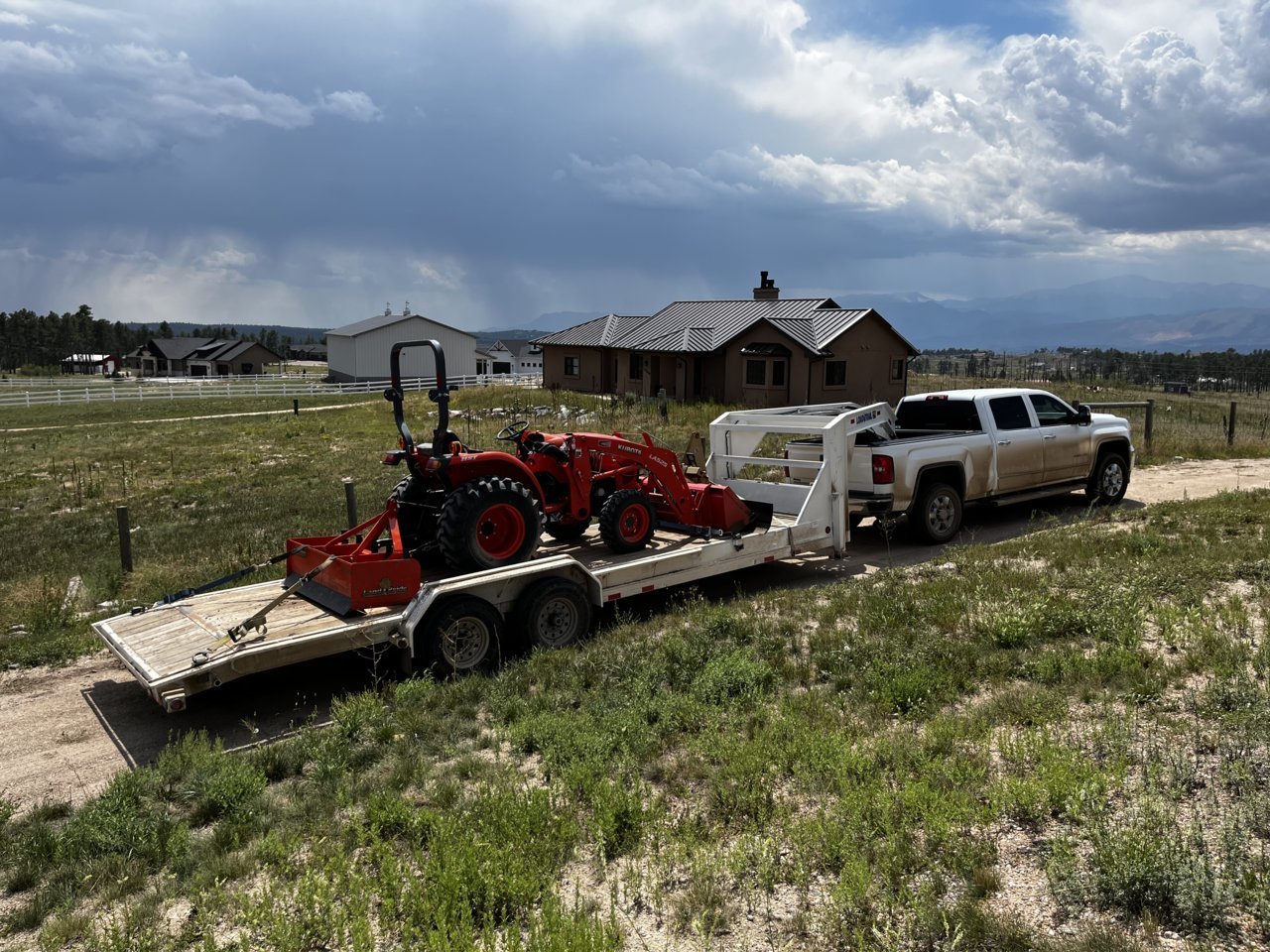

    Your manufacturer might have the axle further forward due to weight distribution. The OP's boat is a little heavier and may have to be further back for distribution proposes. Out of all my trailers, the ones with the axles (I have never owned a single axle trailer) moved further back:
    -Tow nicer with less sway (goosenecks really don't have that problem unless someone loads them up like a tard)
    -Backing is easier.

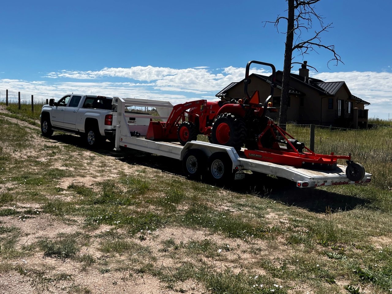

    I’m sure it’s heavy here in the pic, unstrapped and rolled the tractor back maybe 2”? You hear/fell the load change on the hitch. Actually towed very well but extra cautiously because of braking. I don’t think I would have tried without an MT.
    Edit:rear tires are calcium filled, so balance on the axles was not far off.

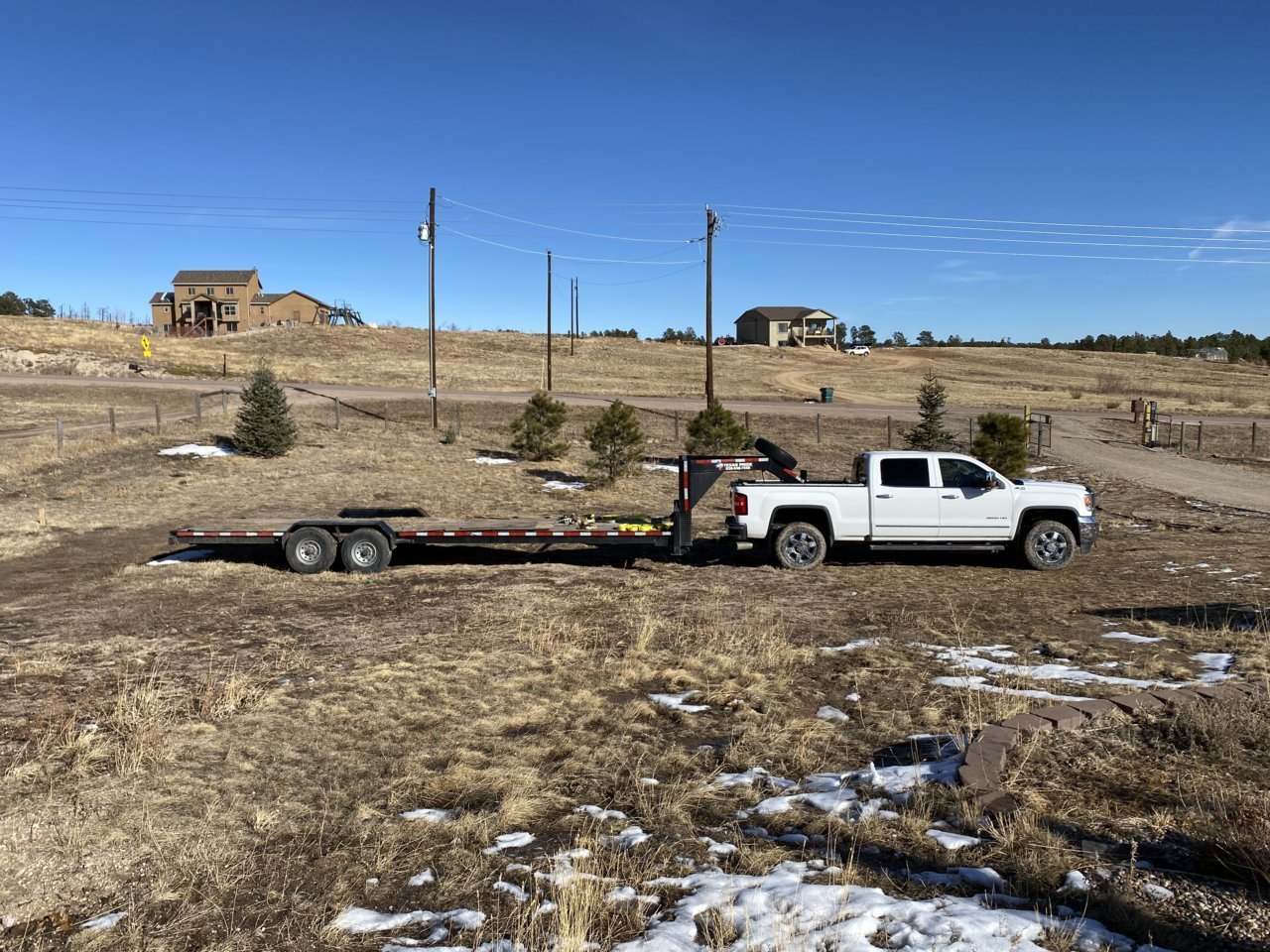

    I was just going to ask if the rear tires have counterweight. I load mine like you do as well due to having rim guard (beet juice) in my tires. In the event I had a bit larger tractor and needed all the implements, 24' gets short quick.
    In this one I just returned from a fellow TW members property to help cut his driveway and direct the drainage away from the house. The 7' blade was up front and with the box blade I had plenty of room.
    Now when I have the brush hog on it gets a little tighter.
    I haven't had to take all my implements but a few times. That's when the 28' trailer comes out.

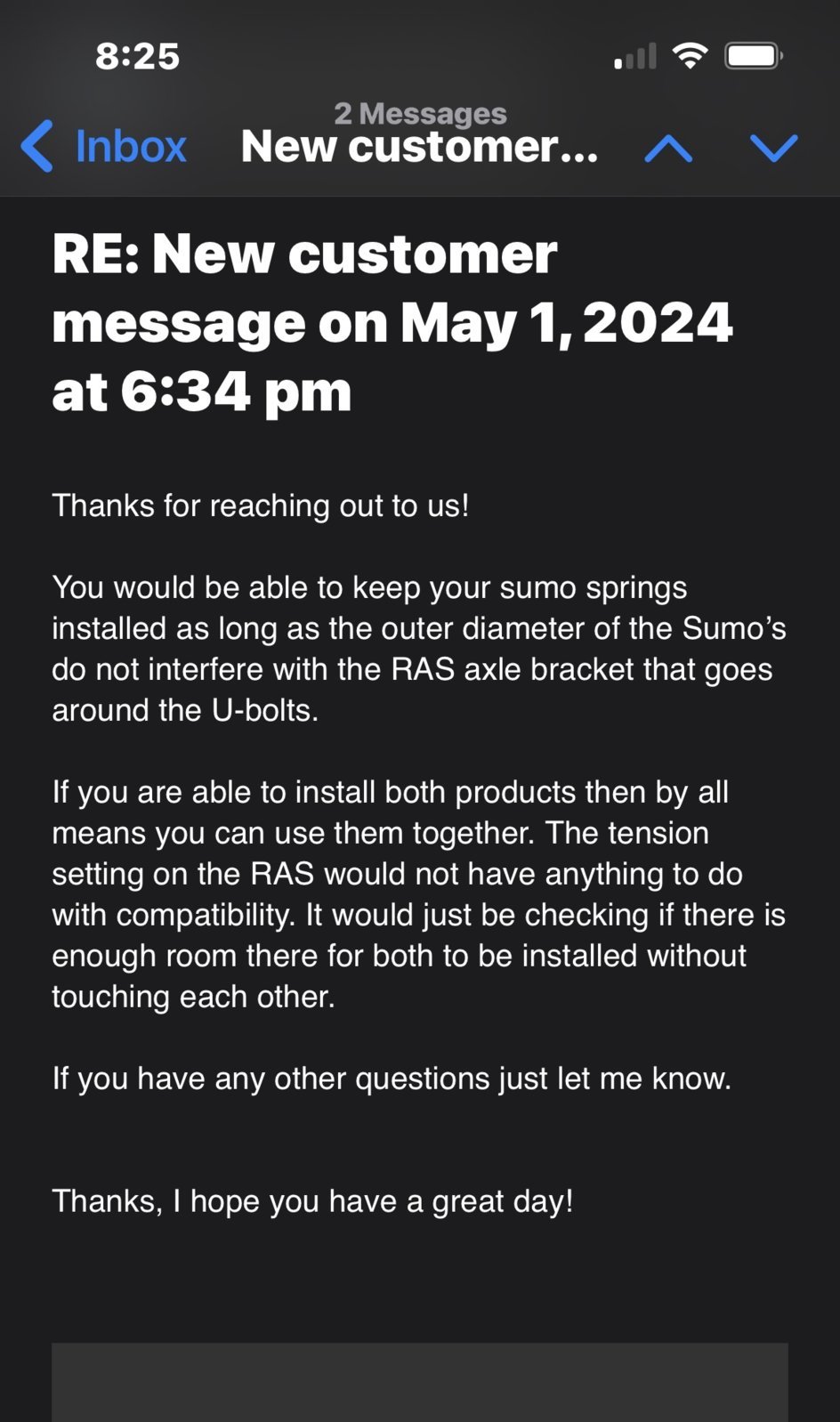

    Great info here. I’m swapping leafs and decided after a long ponder to stay stock height. But ya’ll know the story with the stock leafs.
    I was searching to see if anyone was using the RAS/Sumo set up. But it’s sounding like it’s best to utilize the RAS only after seeing that video. I doubt the blue sumos will allow it to do its magic as I have not found much info on both being used.
    I was curious to know if the U bolts are prone to being bent from the pressure of the RAS?

    Heard from the Technical Support Manager, fuck yeah!
