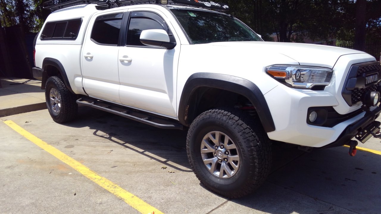

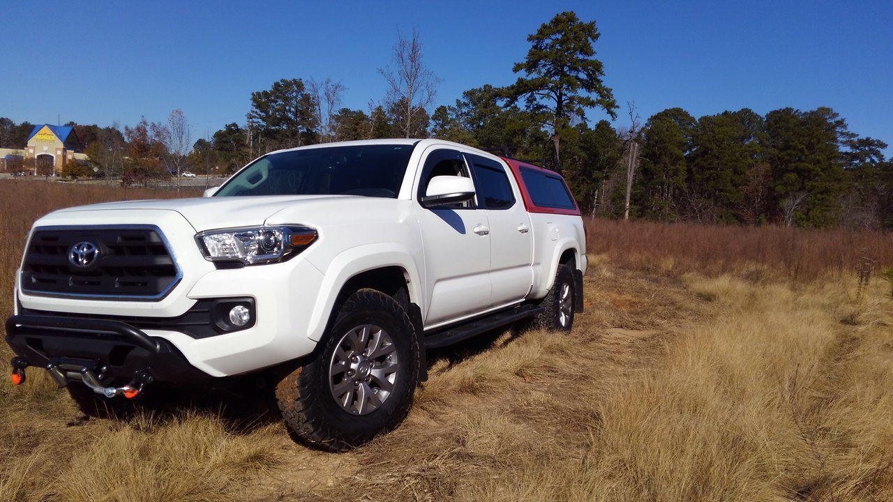

    I have two different sizes up from stock:
    The first is 285/75/16 - 33" Pathfinder AT tires. This is what I'm running now. They're great and have held up VERY well. Lots of trail miles and tow miles, and wearing as expected.
    That said, they rubbed bad on the UCA without spacers. I'm running 1.25" spacers to clear them, took off the mud flaps, and did a CMC. You can kinda see the spacers on the hub in this pic:
    Before that, I had 32" 235/85/16 BFG KO2s before I really started building my truck:
    I ran the KO2s with no spacer, no rub, and no lift, but they wore terribly - under 15k miles before they were all completely toast. They were smooth, great tires for about 5k... Then started cupping and wearing poorly. I tow and carry a lot of weight. They may have been too narrow for my application or I got a bad batch.
    All the above said, this may be helpful: https://www.tacomaworld.com/tirecalc?tires=245-75r16-265-70r16 - I already plugged in your size and the new size. You're going about an inch wider. The 33" Pathfinders I have are about 0.75" thicker than what you're looking at and are still fairly close to the UCA. You may be ok, but it'll be close.

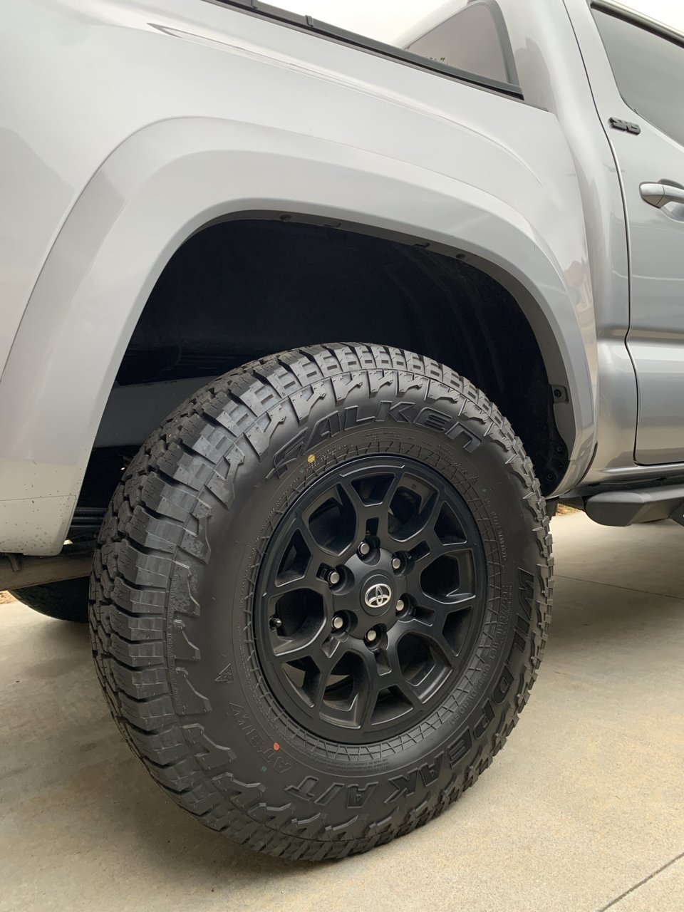

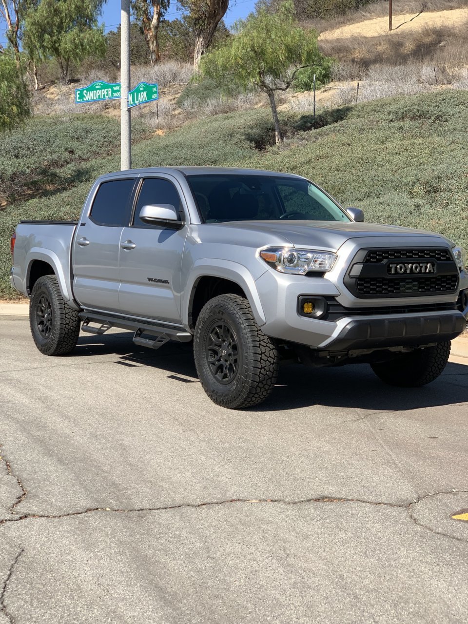

    Yes, it definitely matters on a 4cylinder. I went up from stock on my SR to 265/70/16 and it’s just noticeable. I wouldn’t think about going any larger. A lot of people do and say they’re fine with the power loss and that it’s not that noticeable. I think they’re bullshitting. Here’s my SR with 265/70/16. They look big enough and I could not be happier with the size. 265/75/16 I would not attempt. Just my opinion though and you know what they say about opinions.

    Taco 3.jpg taco1.jpg I went with 265/75/16 on my 19' SR5 stock suspension
