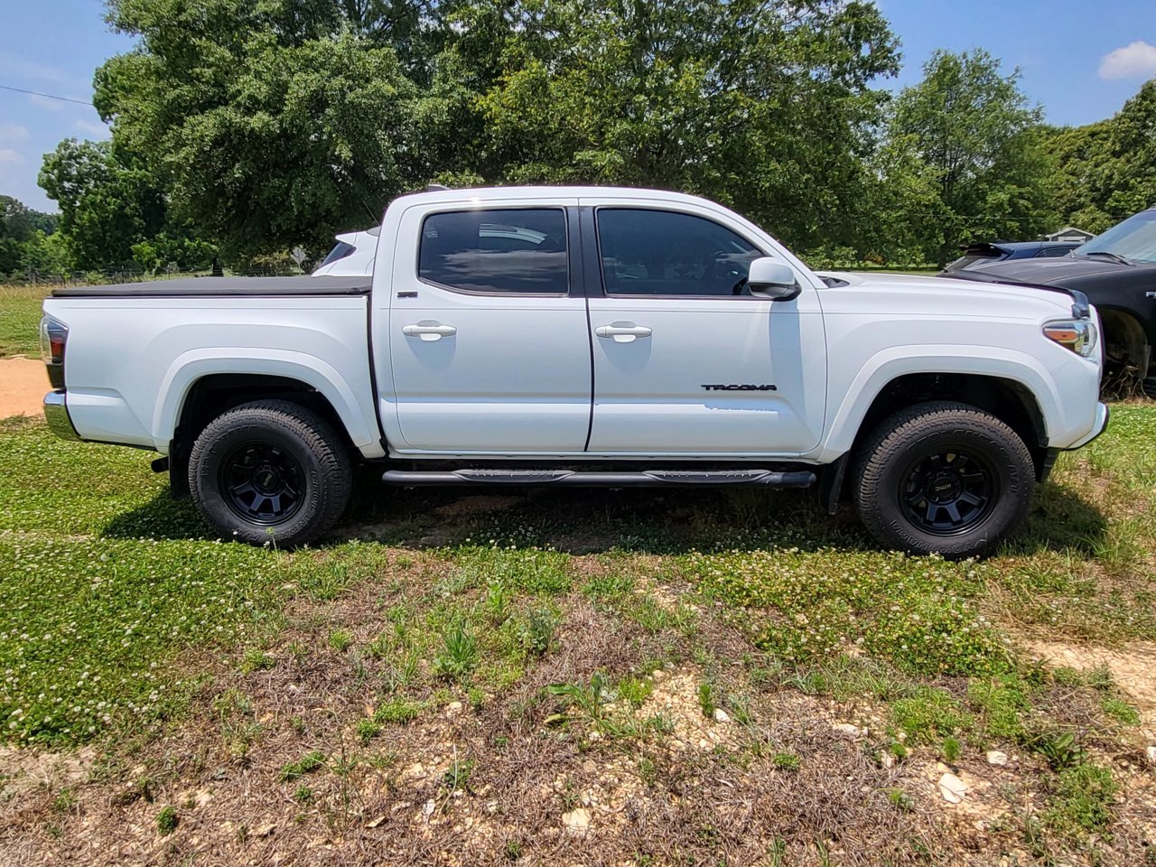

    24 Celestial Silver Sr 5 DCSB 4x4
    Just put 5100's on mine with stock springs and got it leveled out . It's rides a lot better than stock.
