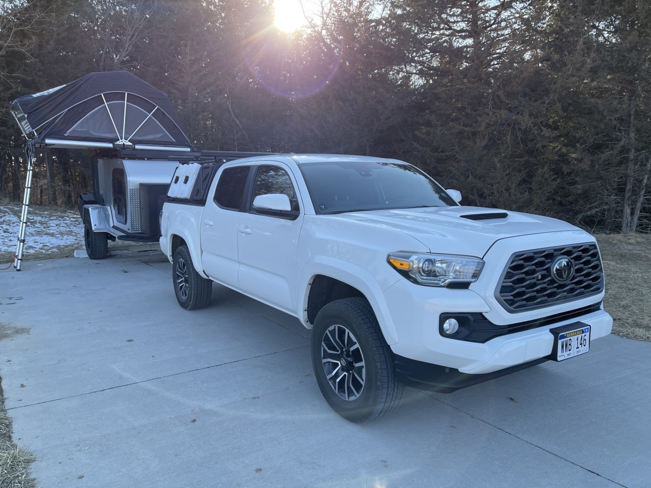

    You should be fine. Having carried a roof top tent on stock suspension while off-roading, then upgrading to a 3500# off-road teardrop your ride quality will suffer when towing. Your Taco will do fine but the suspension will feel squishy like your grandma's Buick. My recommendation is, at a minimum, invest in some Sumo Springs, a Helper Spring like the Hellwig 980, or air bags to keep your Taco level when towing. You are also right on the edge of being legally required to use trailer brakes which means you will need to have a brake controller. Those would be the two things I would be thinking about if I were in your shoes.
    I did a write-up in my build thread that is more in-depth. It is my experience and my two cents.
    Having just upgraded to an OME Heavy kit (2886 springs in the front and Heavy Dakars in the back) I can say the ride quality is night and day compared to stock with a helper spring. I'm happy I towed 5k miles on stock because I have a basis of comparison now.
    Below: my setup earlier this year (stock tires, stock suspension with a pair of Hellwig 980 Helpers)IMG_3663.jpg
