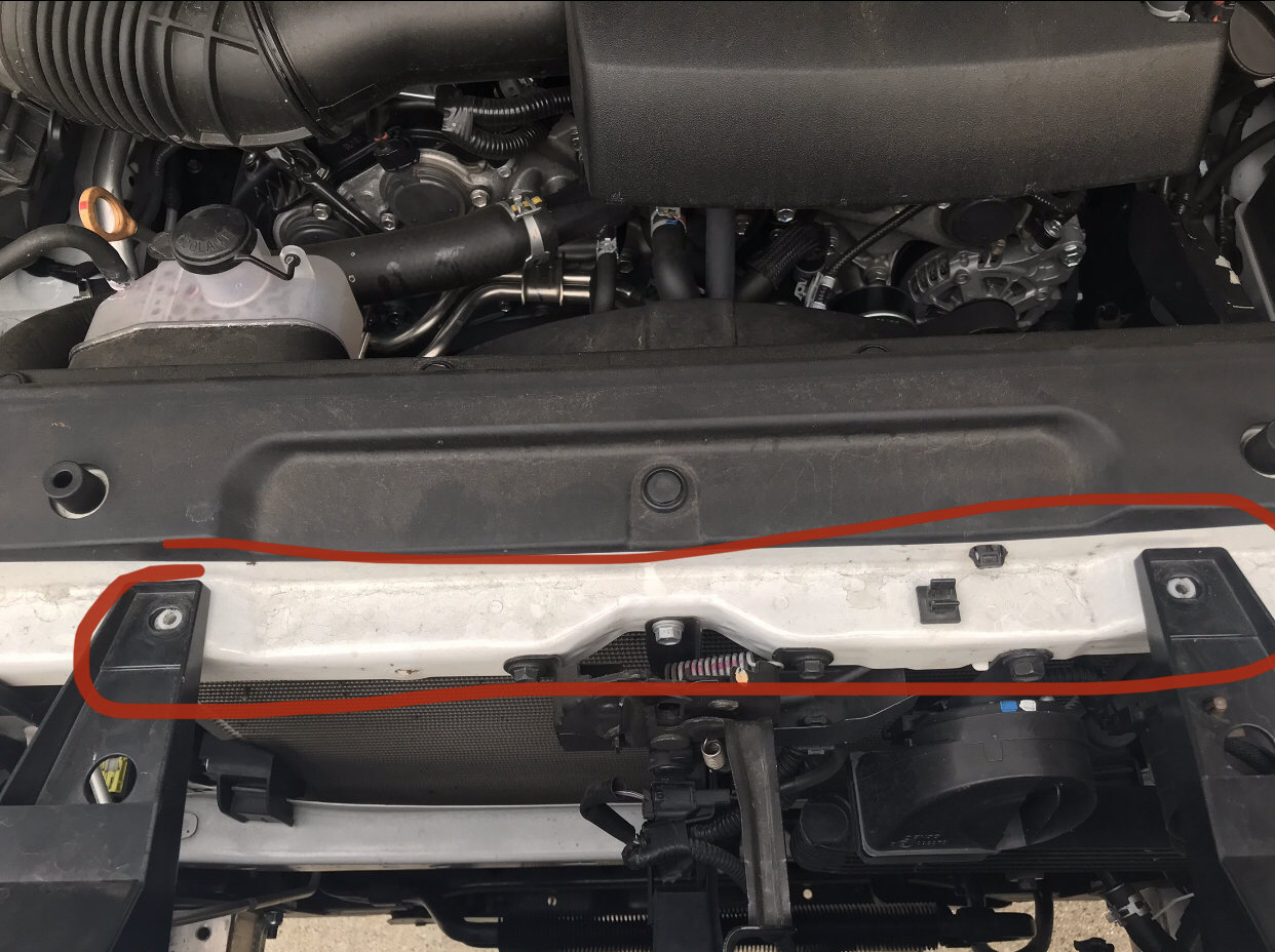

    Gotta give it a big yank the first time you remove it. I've removing my grille like 20 times so it falls off once the bolts are undone. Also, make sure you lift up on the grille housing mounts before you start pulling back, it might be stuck on this (circled in picture)
