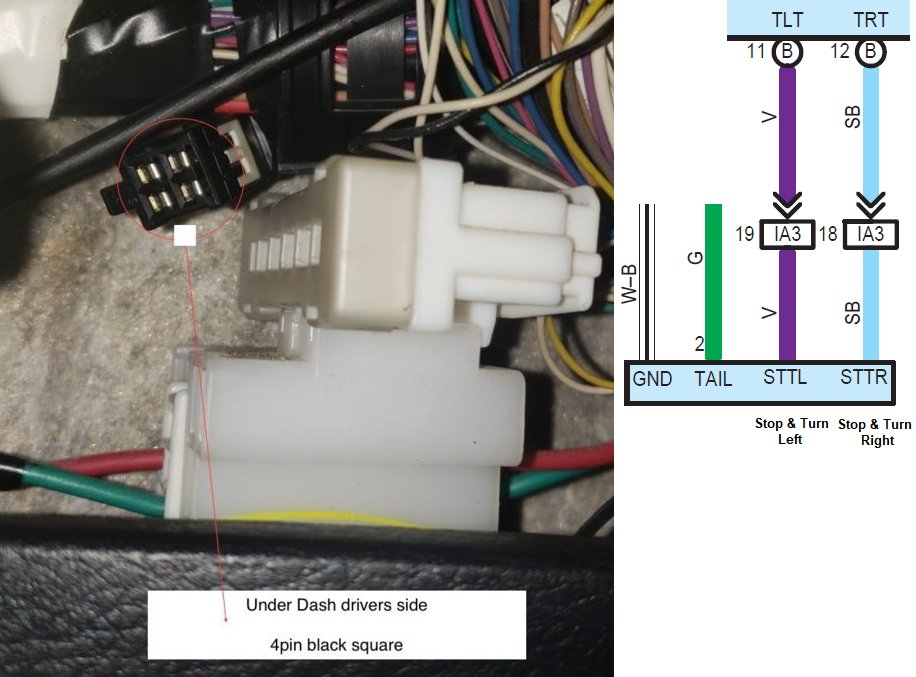

    SR 2.7 I4 has a 4 pin towing connector hidden behind the driver's kick panel.
    It requires the mating connector and cabling routed to the rear bumper.
