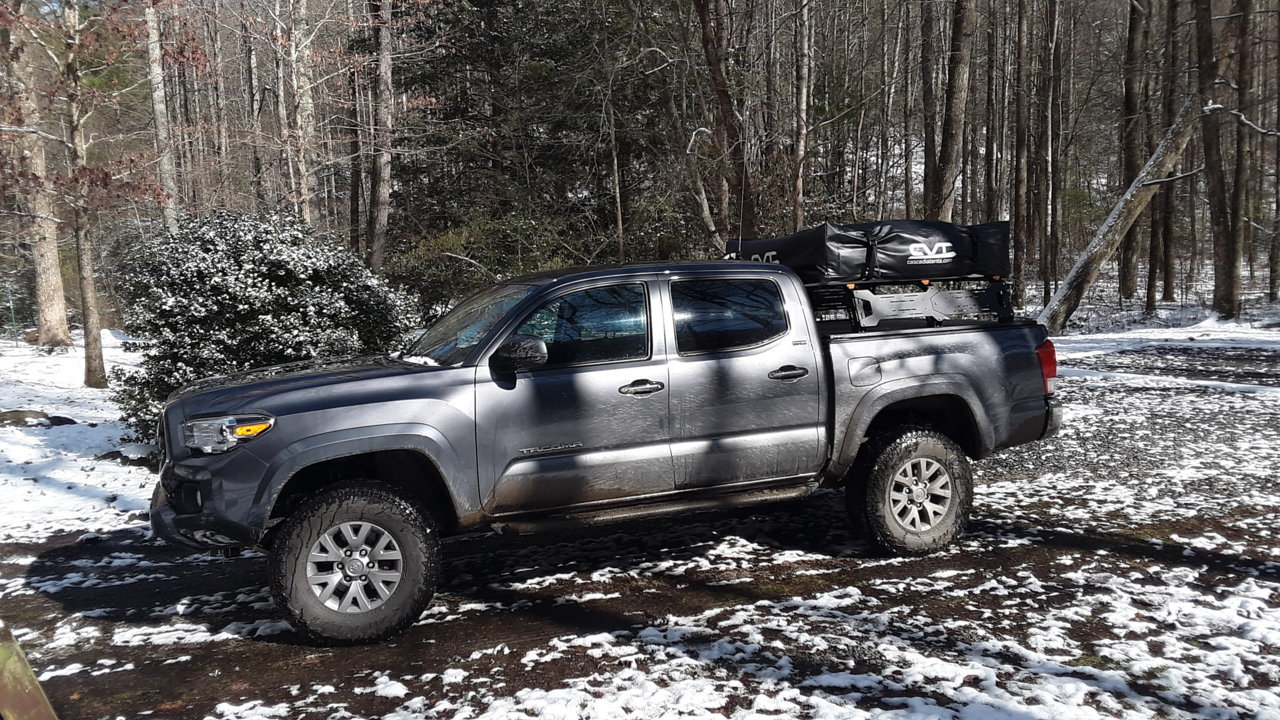

    20201201_123747.jpg I have a 17 SR5 that is my daily driver but I have also heavily modified it to be an overlander. I am planning a big trip out to Moab on the Trans America Trail.
    If you will be going off road any I would suggest going ground up order tires, armor then suspension. I did mine the following order
    1st. RCI sliders and full skid plates- any off roading you will need protection. Armor will also give you freedom to know you can go on some trail and not take damage
    2nd. Falken Wildpeaks 265/75R16. I upgraded in quality and size. SR5 comes with 245 all season tires. I believe OR comes with 265's. I went with an all terrain that is over and inch taller (>half an inch again in ground clearance) than OEM tires. The bigger gave my SR5 same ground clearance as an OR. Anything bigger than a 265 might require trimming or a cab mount chop to prevent rubbing.
    3rd. Fox ultimate lift. 2.5 front coilovers with DSC adjustor, 2.0 rear shocks with DSC adjustor. oem 660 leaf pack. This was overkill but the ride with weight on it is great. SR5 will definitely need a suspension upgrade for any quality offroading or overlanding. I have better travel and a smoother ride with the upgrade. OR already have an upgraded suspension with Bilstein shocks. I put the leaf pack on to prevent sagging in the rear but if I don't have my tent on and gear in the back the heavy duty springs have a very harsh ride.
    Will all the mods on, my gas mileage has dropped to the 15 mpg range, 16 mpg range if I'm carefull.
    With enough money you can mod a SR5 equal or better than a OR or even Pro with the exception of crawl control and Multi Terrain Selector.
