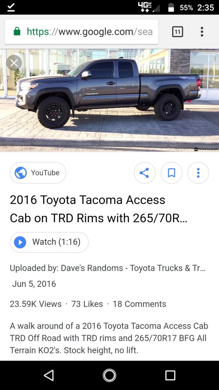

    Just wondering if there is a significant difference in height between these two trims? I know the suspension is different..
    I have an sr5 on the way and saw this photo of a trd and really like the wheels and stance. Just wondering if I got these rims and tires if my truck would sit the same? Thanks

    Suspension is same height between the models, sr5 comes with same size rims as TRD OR, but smaller tires. If you put those wheels and tires on your sr5, it’ll look the same.
    Additionally... all trims have their own unique suspension set up. Different rebound and dampening, but they all sit at the same height. If you boost up the wheel and tire size on the SR5s, the shocks and struts will need to be replaced as well. Not immediately, but it will need to happen. SR5 suspension doesn’t handle the extra weight well.
