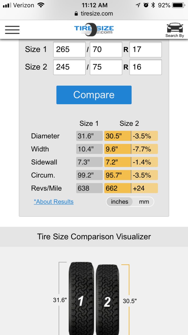

    Dude you are so off it’s funny. The size difference is very minor and won’t effect his SR5 suspension. Real numbers for you.

    Ok. I was off in the tire size. Congrats. Pretty sure you are comparing the size of KO2s in that figure, and different tire manufacturers with different tread patterns do differ in actual size, but I’ll overlook it. The issue is weight. Not tire size.
    SR5 wheel is 24 pounds.
    Toyo open country h/t tire is 35 pounds.
    Total wheel weight on stock configuration is 54 pounds.
    TRD pro wheel is 25 pounds.
    BFG KO2 E load is 53 pounds.
    Total wheel weight of pictured truck is 78 pounds.
    Read what I’m saying. I’m saying the weight of the wheels and tires are causing the problem. You are adding in about 50% more weight. While the tire is spinning, it creates way more than 50% more force. The hitachi shocks will handle it, but they will wear out faster. Expect about 6 months, maybe a year, and they will be bouncing! Not completely shot, but they will need to be replaced.

    No, good lord it’s like a 4% increase in size, he will not need new struts. OP asked about the stance of those wheels. If he gets those TRD 17” rims he can put a ton of different tire options on that won’t adversely effect the suspension. Hell he could go with a 265/65/17 and it wouldn’t be an increase at all. Hell the 265/70/17 Dynapro ATM I ran was 38lbs on my SCS wheels. Total weight was only a few more then stock.
    @jmauvais keeps throwing out random ass info like they are facts. I get that you don’t want to add a ton of weight, but to make a blanket statement about having to swap struts is total BS. There are tons of members here with SR5 trucks who have switched to bigger rims and tires with no issues. Look at the huge pizza cutter thread where members are running 255/85/16 on STOCK suspension. Those tires are like 57lbs and no one is reporting issues at all.
