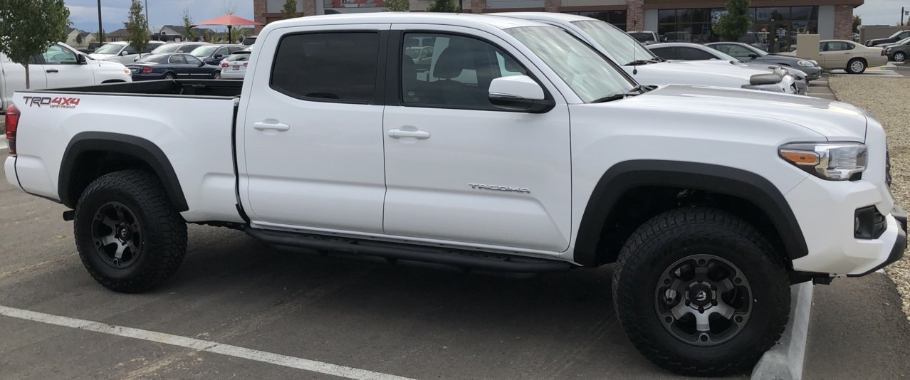

    What’s the wheel offset?
    I have 16x8 0 offset with 265 75 16 and they didn’t rub at all, even at stock height. I don’t have mud flaps. Have heard they can slightly rub on those. I suggest the 75 series as if you get the 70s you’ll probably have wished you went larger.

    Thanks for the quick response! Offset is -12MM and 4” backspacing
    Your truck looks clean!

    I have stock rims with 265/75/r16 no rubbing, everything works perfect. I’d imagine with the rims everything would be fine
