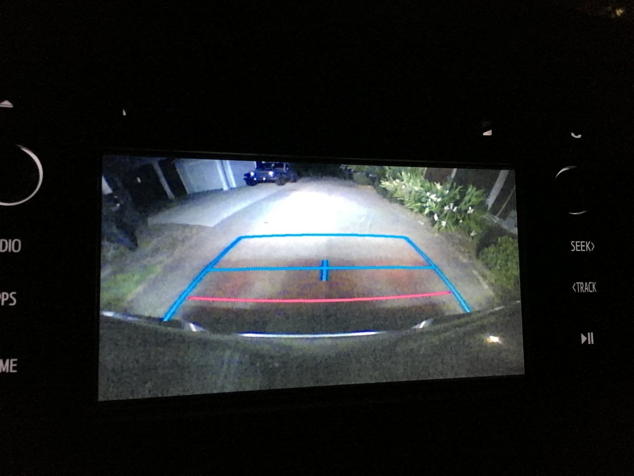

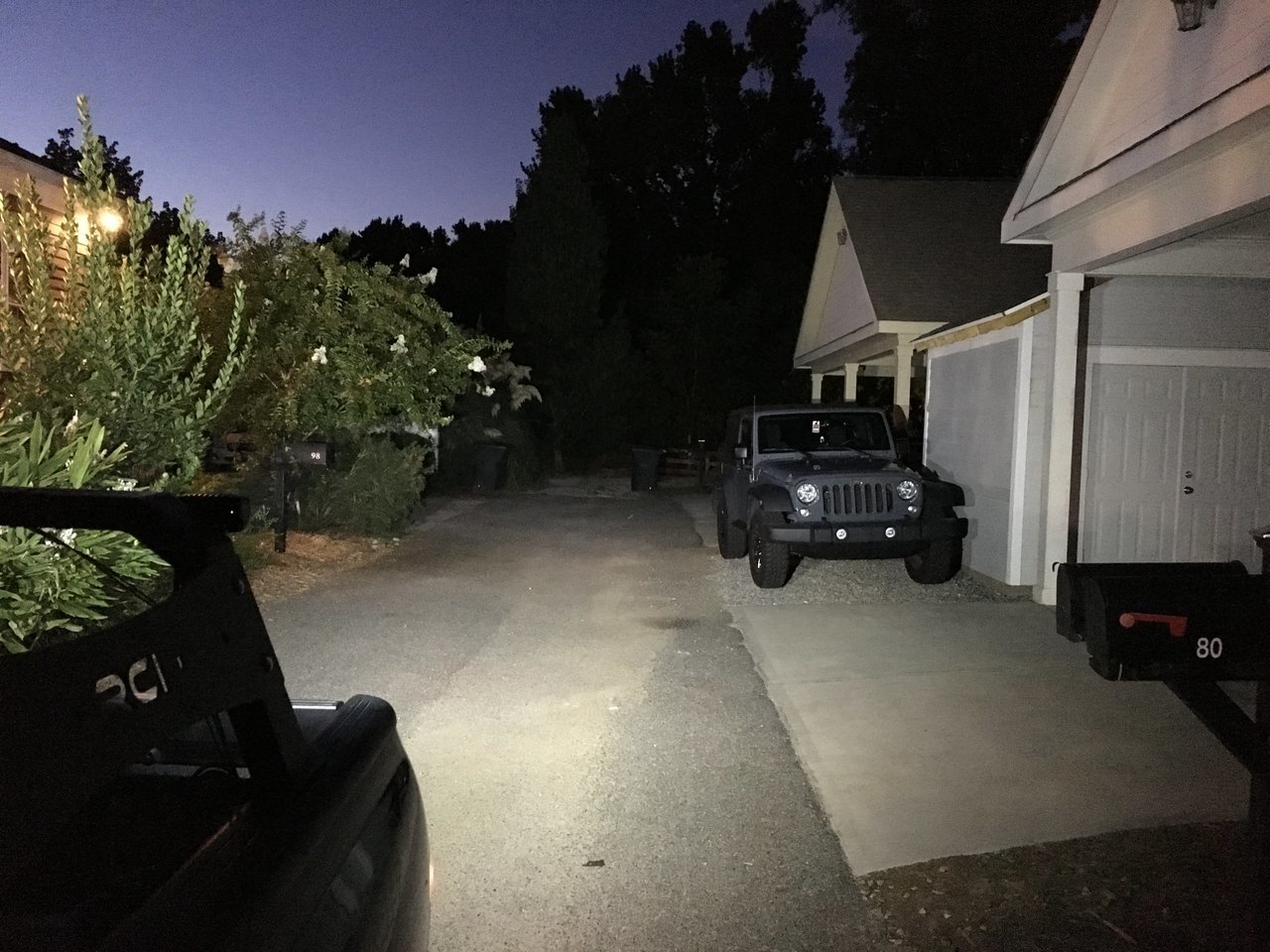

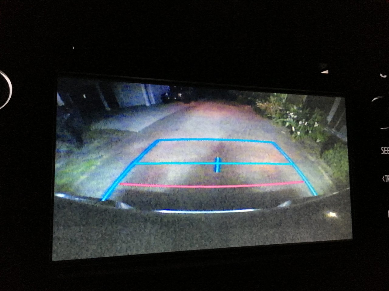

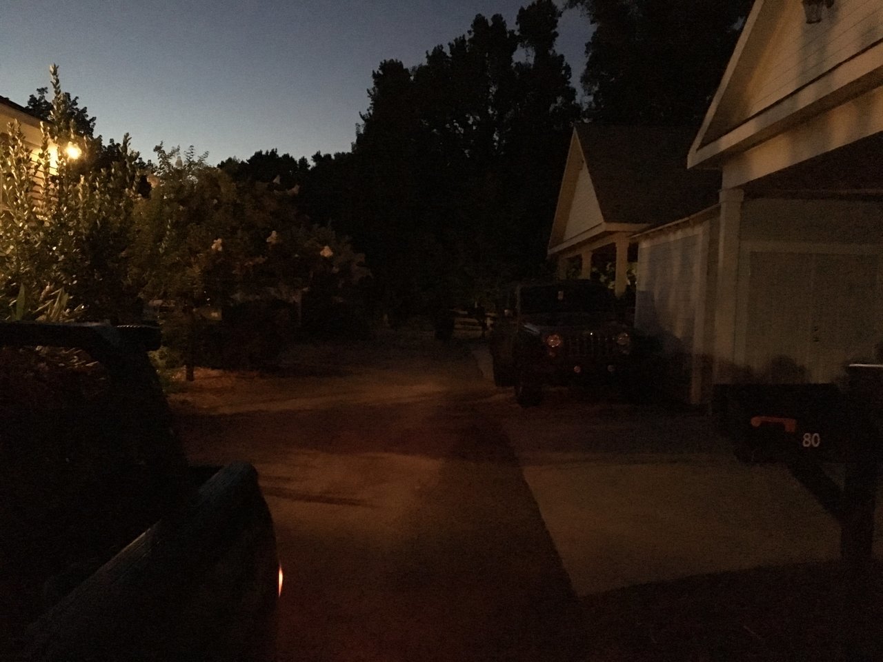

    I wanted to post this thread because I found very little when searching for rear facing lights, specifically when getting an idea of what the back up cam would pick up with the bright LEDs. So, here are some shots of the output from the part # 98000 SRM back up kit. These are mounted up high on my bed rack, so obviously flush mounts in the bumper will change the output a bit.
    Led reverse bulbs only
    Reverse lights + SRM's
    No lights at all
    SRMs only
    I struggled for a while trying to decide between flood or diffused patterns. As you can see in the last pic, the diffused is pretty much perfect. Gives light everywhere so you can see through the camera and all mirrors (even through my 15% tint).
