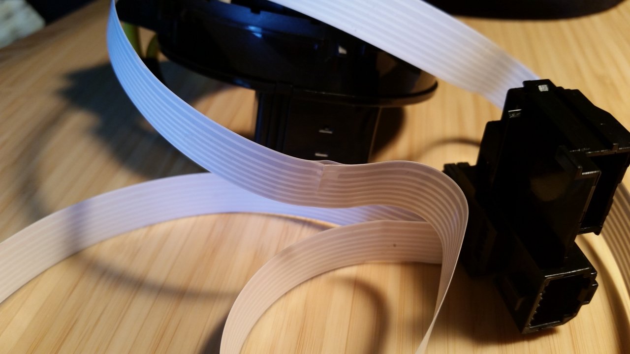

    I took the old one apart to see if I could find the failure point, and this is what I found:
    Looks like the ribbon cable was kinked, and a couple of the copper traces broke. Up until I replaced it this morning, the horn, cruise control, and steering wheel controls all worked - the only thing that was an issue was the constant SRS light on the dash.
