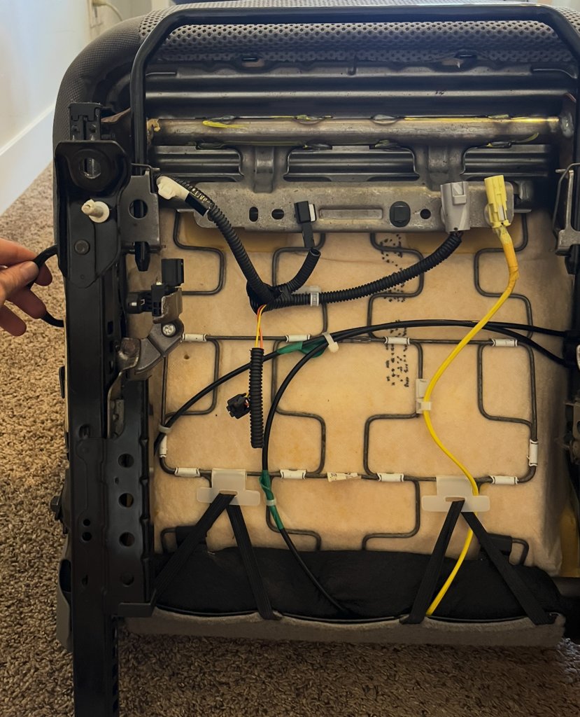

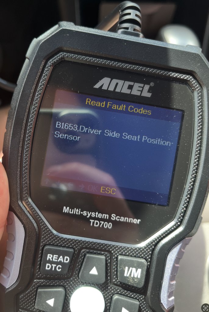

    3. Needed a little help narrowing down where it could be so I bought an ANCEL TD700 OBD2 scanner for $140
    The scanner was able to read everything and showed that it was the connection for the driver seat position was down. The SRS system uses seat position to deploy/not deploy the steering wheel airbag.

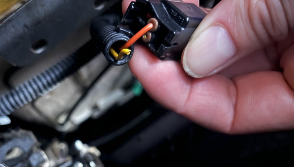

    I looked under my driver seat and sure enough, that connector had a wire that was completely broken off, it was this same issue described here
    4. I found that you can replace the wiring harness the seat position sensor connector is on relatively easy and pretty cheap. OEM from Toyota is about $50
    Front Seat Belt Assembly Inner Left Hand
    Part Number: 73240-AD011-B0
    5. I took off the seat
    Front seat removal video
    6. Replaced the seat belt harness
    7. Put the seat back on
    8. Turned on the truck and after running the SRS check the light turned off
    Not mentioned is me trying to solder the old wiring harness and it failing to fix the connection xD
