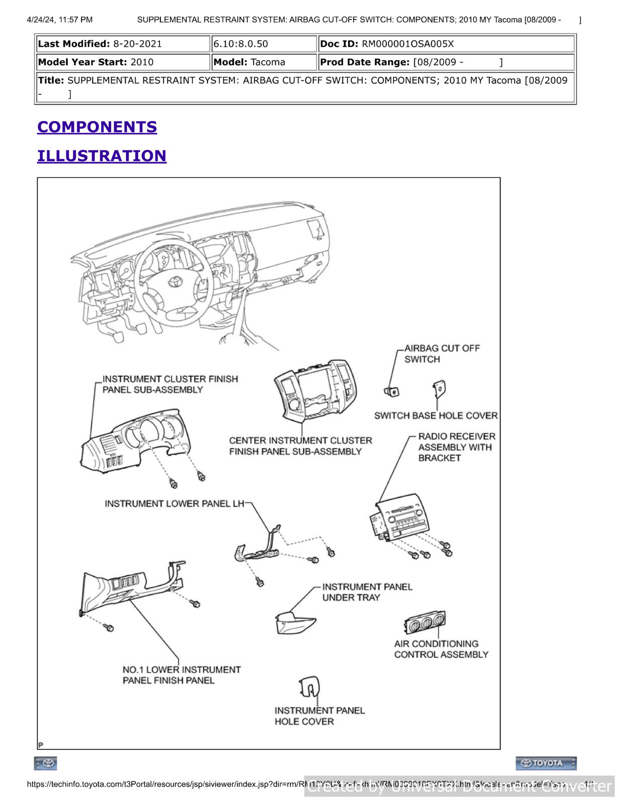

    SRS light is on continuously. The passenger "Air Bag Off" light also illuminates constantly. I checked connections under the passenger seat and they seem to be good. The weight sensor on the passenger seat definitely works..
    Using this procedure, I get code 33. Any idea what this means? I haven't had luck finding a comprehensive list of codes. https://docs.google.com/document/d/...JunZjxW5i8XqhF70GPgx9zQgZ1ZB-NN3Hlt-582FM/pub
    I had previously removed both seats and pulled most of the dash apart to get access to the evaporator. Looking up into the glovebox, I can see the passenger airbag is plugged in as it should be.

    Did you plug the passenger airbag cutoff switch back in?

    I SWEAR I did. …but no, I evidently did not. Thank you.
