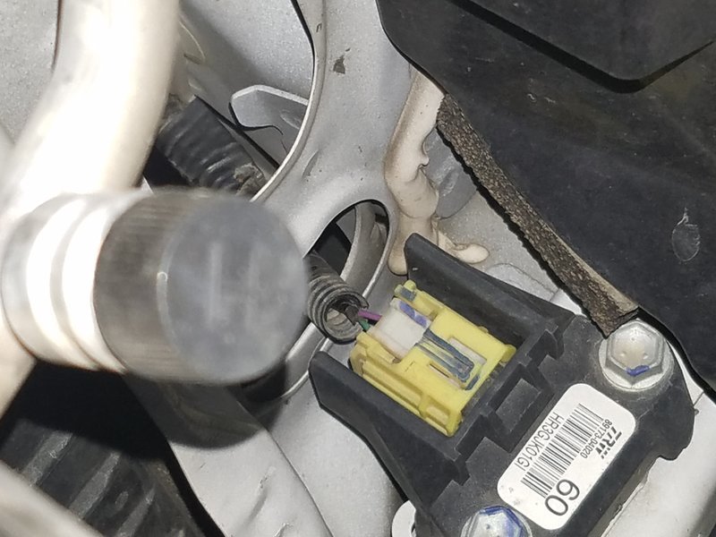

    My truck tacoma 2016 was in shop for long time, I did get everything put together, while it was at shop and they were taking front end off, they broke passenger side srs sensor plug, where the wires just came out of it, I did soldered the wire back in and plugged it in but airbag light is solid on, can anyone take picture of the plug from top so that I can see the color codes on plug is in right order ?

    What shop? You shouldn't be fixing anything that a shop broke.
    I'll snap a picture in a minute.

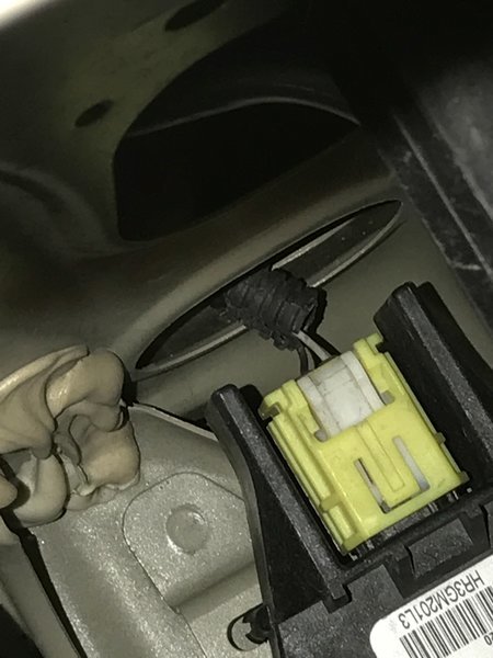

    I really appreciate that one looks correct, if you don't mind can you also take picture of the left hand driver side, yes you are right, I should't take anything back to them but he is good friend of mine and really charge me what he does, one his new body man broke it and I don't want to put it on him since all on all he was trying to help me.

    yes I tried that, I took it toyota and they tried to clear the code but it would't, they stated that I would have to bring it in for complete diagnosis, if I can just get picture of left hand side sensor driver side that would clear all the doubt about wiring harness, apparently sensor has polarity itself, so wire has to be right otherwise it would not be read by srs ecu which is what one of sensor is doing, I also had srs module reset too just in case module had any hard codes stored and shop could't clear it, sill no help so somehow I think I have plugged the cable wrong on sensor plug, I thought it was right hand side plug but I forgot it was the left hand side.

    20170104_190150.jpg drivers side
