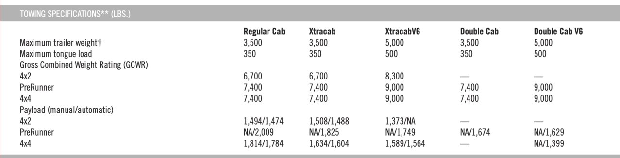

    I want to tow my 240z from san jose to sac (127 miles ) with the srunner. Trailer and 240z it will be a little under 5k lbs. For some reason the 2001 srunner is only listed at 3500 the same as the smaller short wheel base 4 cycl tacoma. Which is strange since the prerunner which is the same size and engine is listed at 5k.
    Any reason the srunner can't tow 5k lbs 127 miles even though the same size prerunner with the same engine and same wheel base can ? I wonder if Toyota just made an error on the specs.
    https://www.edmunds.com/toyota/tacoma/2001/st-100001895/features-specs/
    2001 srunner
    v6 190 hp / 220 lb-ft
    3500 lbs towing
    wheel base 122 inches
    2001 prerunner
    5000 lbs towing
    2001 4 cyl single cab
    142 hp / 160 lb-ft
    wheel base 103 inches

    It's not power, it's suspension/tires.

    your rear suspension would probably be done after the trip. Look at the ford raptor. the first gen had less towing capacity than my V6 Tacoma, but the same engine and transmission in a standard f150 was rated at almost double. It's all about that suspension.

    Sounds like even if I can tow the 240z it would be a lot of wear on the srunner. I am not going to use the srunner then.
