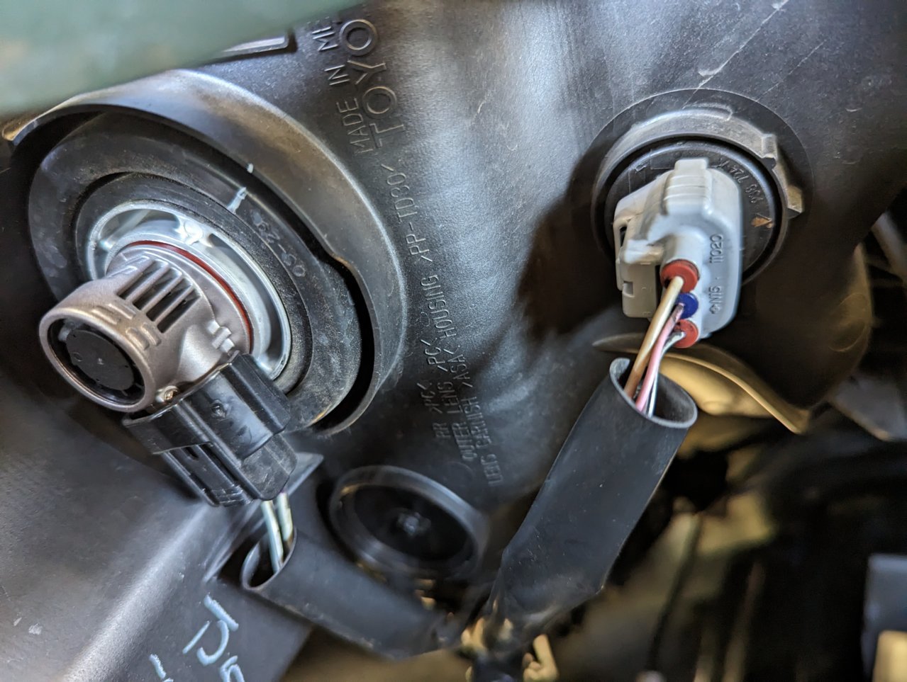

    I have a 2022 SR5 Trail edition halogen headlights with the diode dynamics SS3 pro with backlight. I purchased the plug and play harness from them but it doesn't match and of the plugs. Do you have the adapter to make the backlights work? I really don't want to use the t tap. Thank you so much. @daveeasa

    DD’s harness is for TRD.
    https://fbchs.square.site/product/tacoma-sr-sr5-drl-parking-light-t-harness-for-backlight/38
    https://fbchs.square.site/product/diode-dynamics-backlight-plug-and-play-harness/12

    The one on the right is park, DRL + turn and ground. The T’s for backlight are color matched.
    LED bulbs in halogen projector? That one makes me sad.

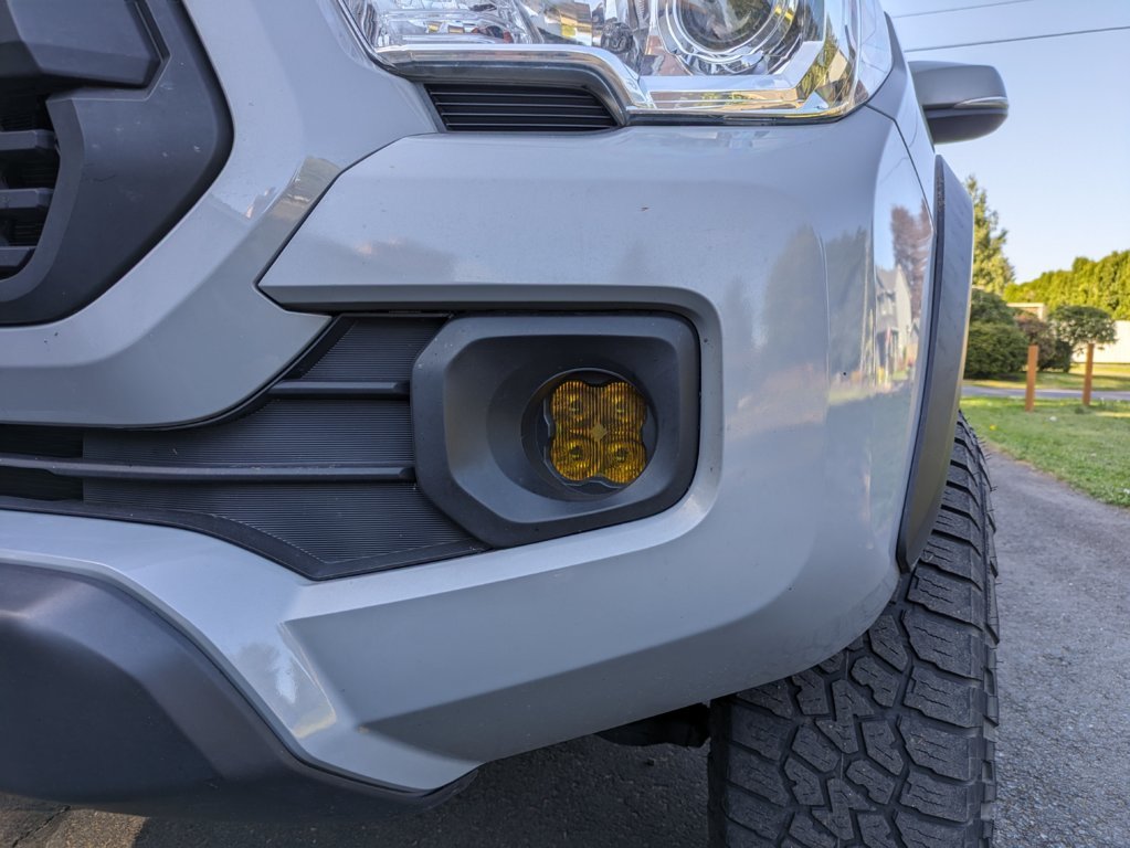

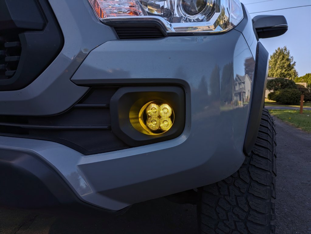

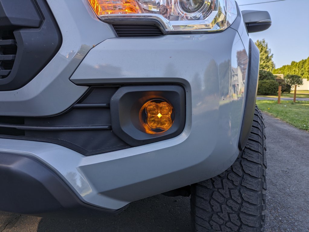

    Off:
    Amber back light:
    Yellow fog light:
    I would say the back light is just as bright as my amber marker lights.
