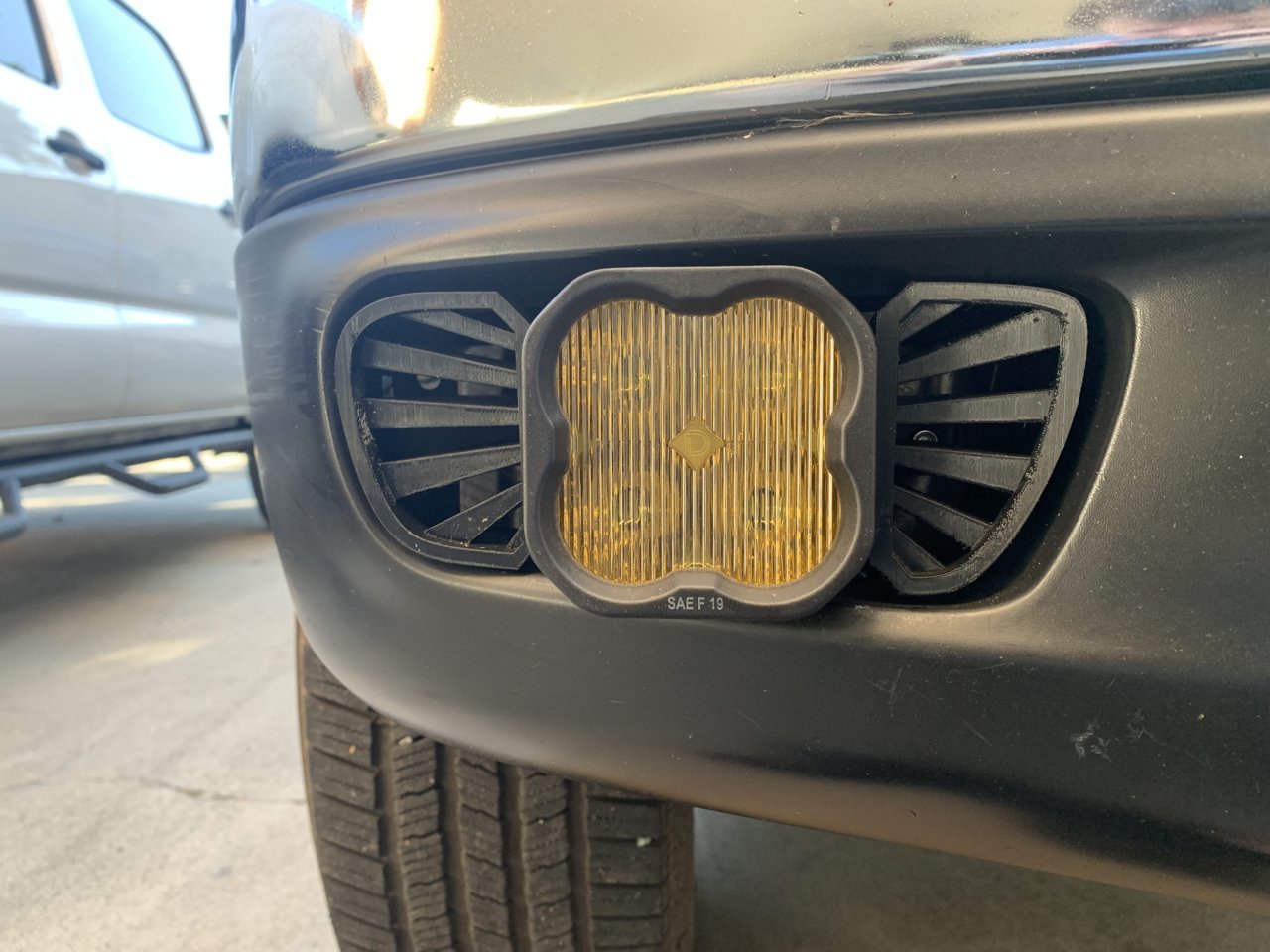

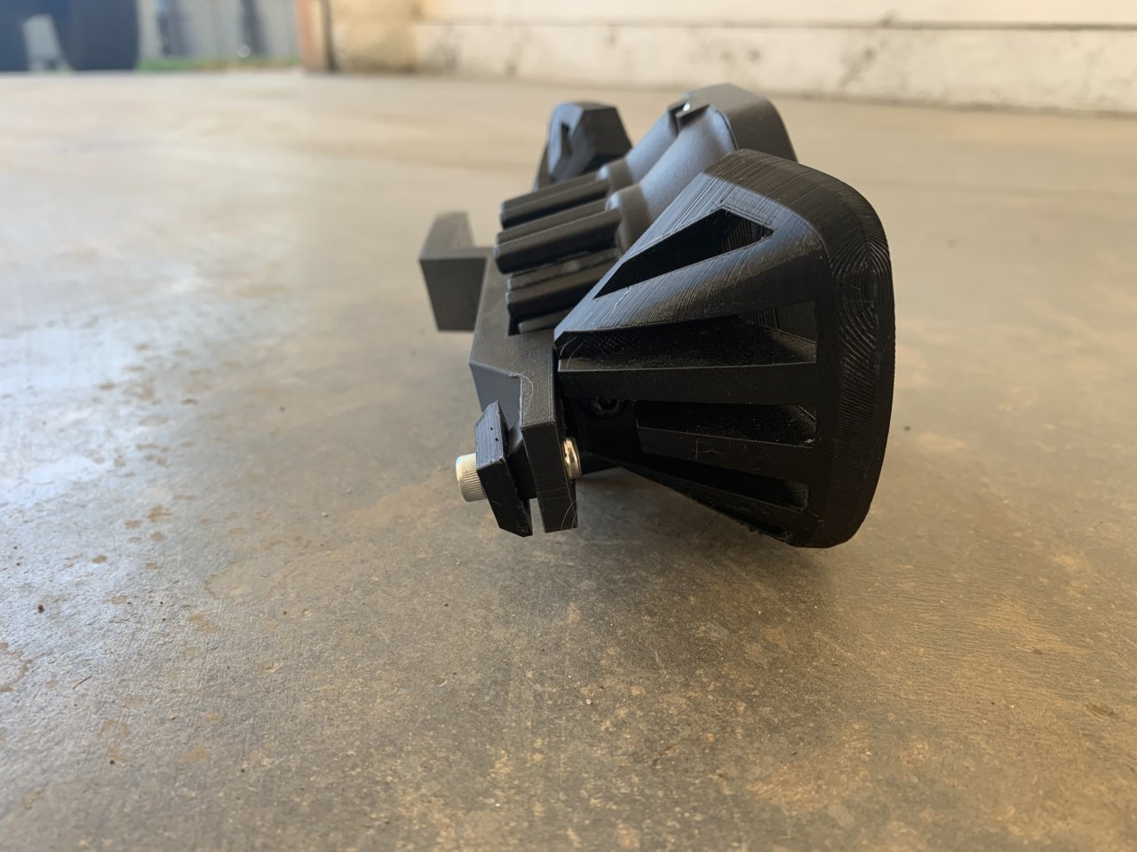

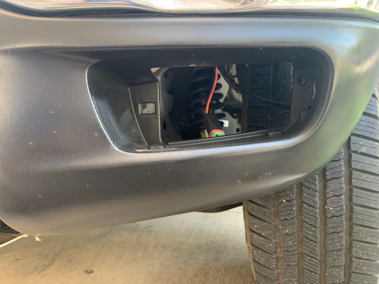

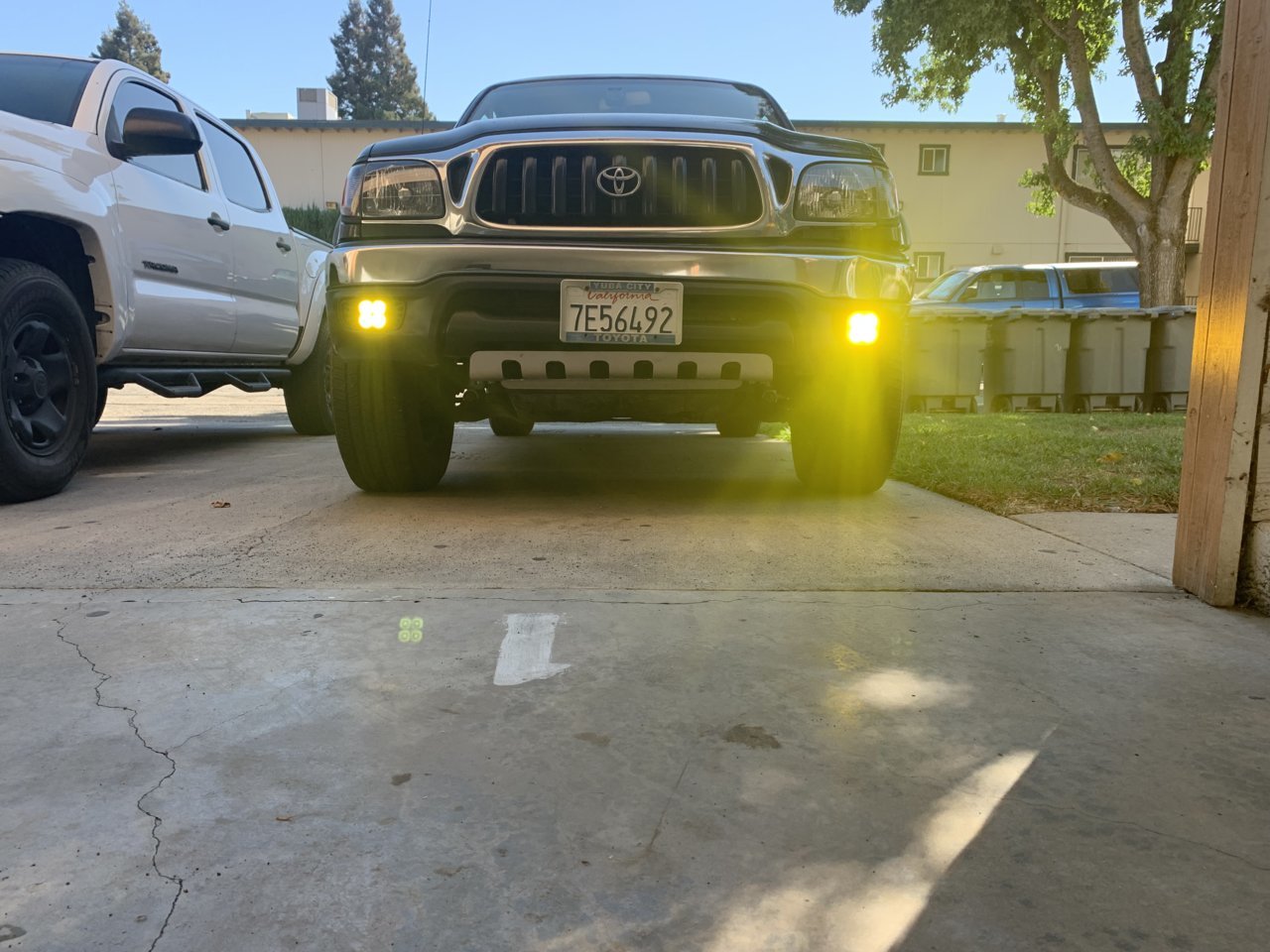

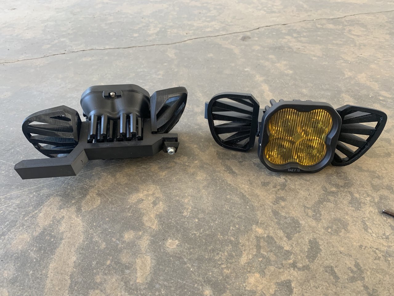

    A while ago I bought a set of Diode Dynamics SS3 Pro fog lights after reading the fog light thread and seeing decent reviews for them popping up. I had them mounted previously on my 95 2.7L MT Taco before with a few simple holes drilled into the old bumper but wanted a more elegant solution on my 2003 Taco. The factory turn signals seemed to be in the best place for fog lights and a lot of other posts were showing different retrofit options using those factory housings or other fog lights. In order to put the SS3's there I needed to come up with a bracket that not only held the lights in place but also still looks like they belong on the truck. After many months of tinkering I believe I finally have something elegant enough for me to be happy with sharing.
    The main section of the bracket fits into the same mounting points as the turn signal, but since it weighs a bit more I wanted to use a nylon locking nut with a bolt instead of a clip solution like the factory signals.
    I came up with two side piece "fillers" to add to the look of the mount without restricting airflow to the cooling fins on the lights. Splitting the filler into two parts also made it a lot easier to 3D compared to my initial designs.
    I've been playing with some SEM chip guard paint to see if I can get the coating to come out nice to hide the print lines from my 3D printer and also protect the plastic, but so far I haven't had any problems with damage or the heat of the summer effecting the brackets ability to hold the lights securely.
    There's a couple things left to tweak on it but other than those minor fixes I think it came out pretty well. In case anyone's wondering I moved my turn signals into the parking light housings in my other thread.

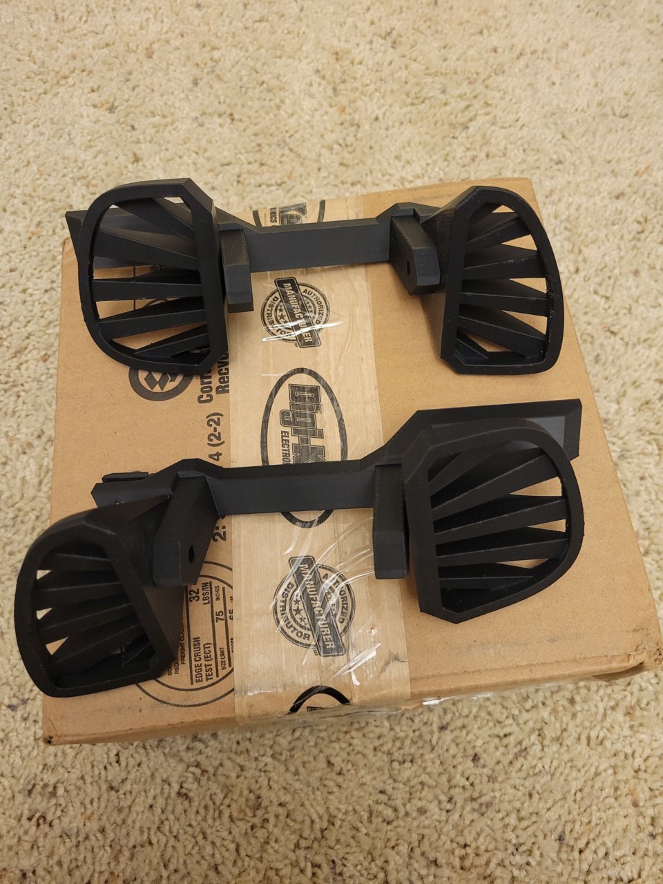

    Got my pair in today! Still gotta decide which ss3's I'm gonna run on this truck, but I'm pretty excited to get them on the truck. Thanks again @drewmox !
