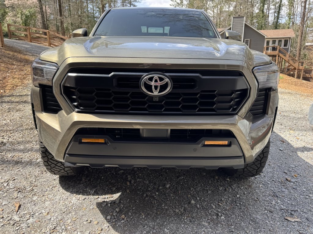

    I did the Amber street legal ones from Diode Dynamics. Getting to them and esp getting the screws in and tightened down is a pain. They don't sit flush with the back of the upper bumper face but they line up well. I'm happy with them overall.

    Installation looks like a process compared to many other vehicles.
    I've run Rigid SAE pods and still have a spare set. Their output is great as well but the Tacoma front end is limited for install options that look clean.
    Does leveling the lights without accessible adjustment screws and does prying the bar work ok? Doesn't look ideal although the front end design restricts any other access.
    Overall are you happy with the output compared to the factory lights and do they project light much further?

    Frankly, it’s a pain in the ass to level them. You need to snug the mounting bolts tight enough to hold them in place but leave them adjustable enough to move them once back together. I’m happy with the light output though and now that they’re pointed where I want them, I don’t expect to have to move them or for them to move.

    For leveling, to the post above, you want them tight enough not to move. I leveled them by measuring each edge from the top to the contour of Toyota's body panel before putting the bumper trim piece fully back in place (a bit of back and forth)
    I'd like for them to sitting closer to the upper bumper face trim panel but haven't quite figured out best approach for that... If @mthopt9n has ideas. Theirs look to be sitting closer, or it's just not as obvious.
    Trying to take the front of the truck off as few times as possible!
