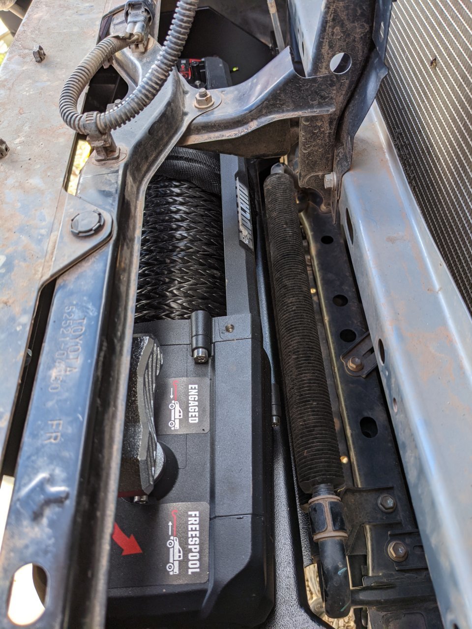

    Has anyone done this? I just I stalled my bumper and the solenoid doesn't fit. By a long shot. I've seen someone cut the cross member, which I'm ok with but I'd like to see if anyone has relocated the solenoid somewhere else first. Please feel free to post pictures!!
    Huge thanks in advance!!

    Pretty much everyone mounts it elsewhere. Some can fit still on the winch, but i dont think many do.

    I'm trying to find pictures of where people mount it. Options are a little limited

    I am hoping to recieve my sso bumper in the next couple of weeks. During production I have secured a Smittybuilt winch and I am planning to relocate the solenoid box up toward the driverside area near the fuse box. I am making a custom bracket this weekend and I could post up pics if you are interested.

    got that setup, Just cut and reinforce the bar. life easier that way.
