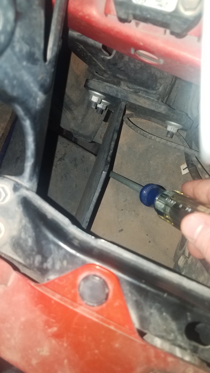

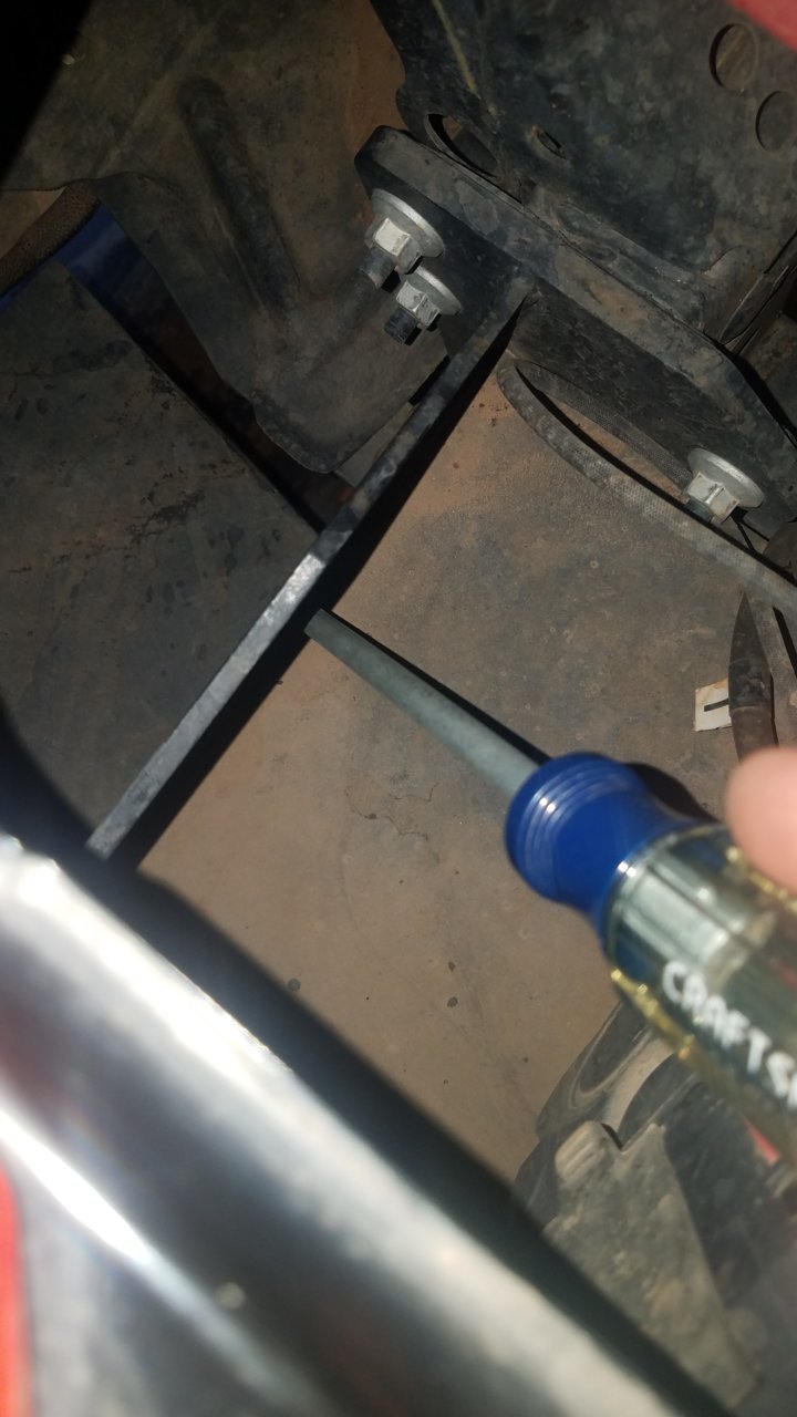

    I actually just popped my grill assembly out to look. It's really easy 2 screws and 2 clips. I'm going to attempt to install in place. I have one of the first generation slimlines so I'll need to drill. I believe I'll have pretty good access with the grill assembly removed. Also not sure I'll need to tap the lower 3/8 hole but I'll have to wait for my HC kit to make sure this is the mounting surface. Also once I make the body cuts I believe I can get a full size drill in there but may need a 90° drill.
    * edit looked again. Definitely going to have to tap the lower hole.

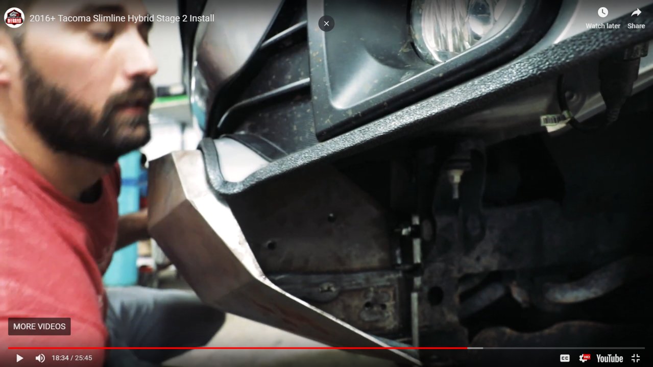

    I watched the video again. Based on this screen shot, I think you're right! If you make the cut first, with the Slimline in place, you'll have plenty of room for drilling and tapping the holes on the Slimline. The only question would be, "how difficult is it to make the cut with the Slimline in place?"
    If you're careful when cutting, I think you could get it done.

    Yes, I'm going to use a rotary tool again. Lots of control so im not worried about the slimline getting int the way. I also have a nice ratcheting tap and die set that uses socket extensions so it should be no problem getting in there.
