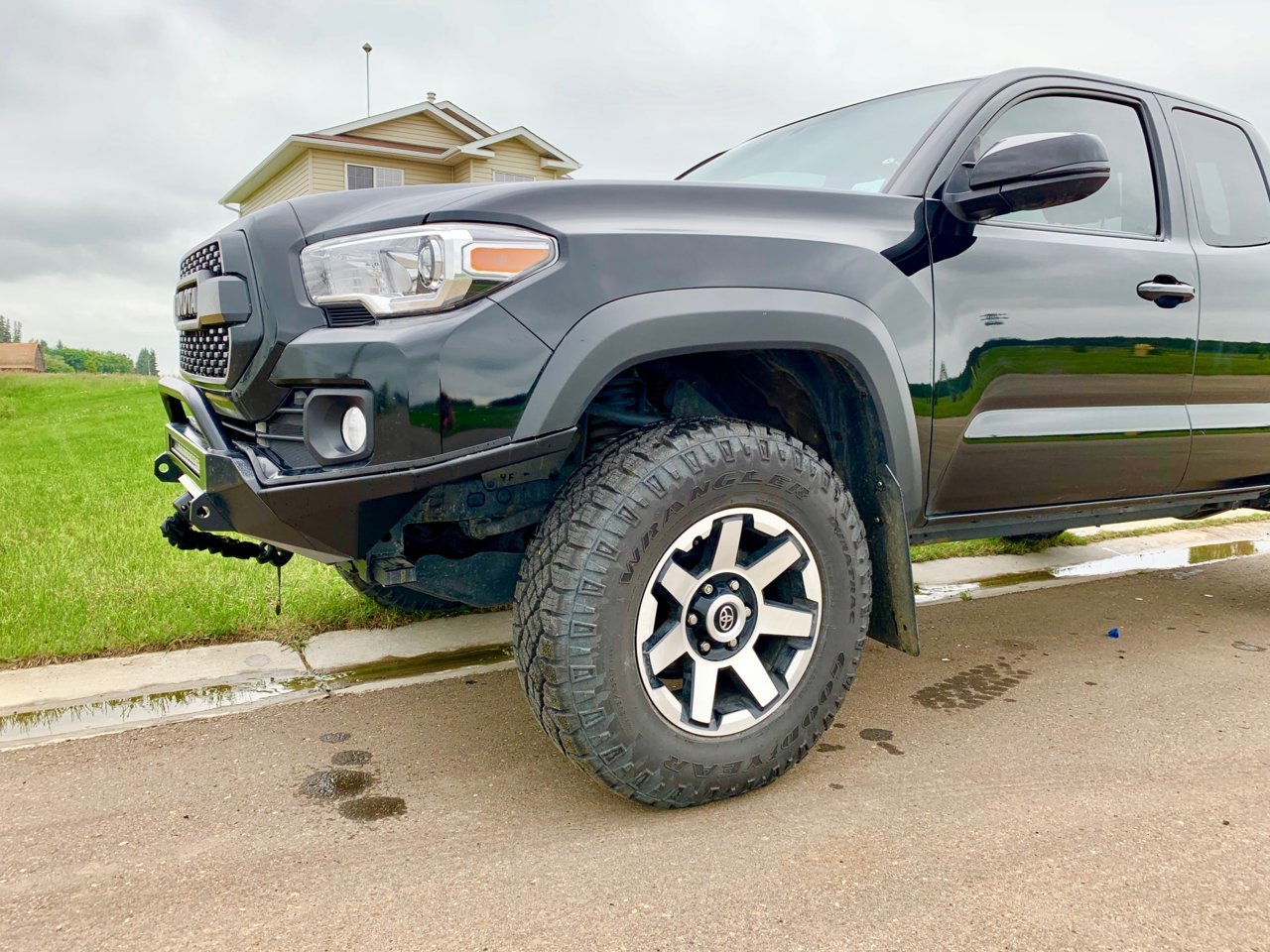

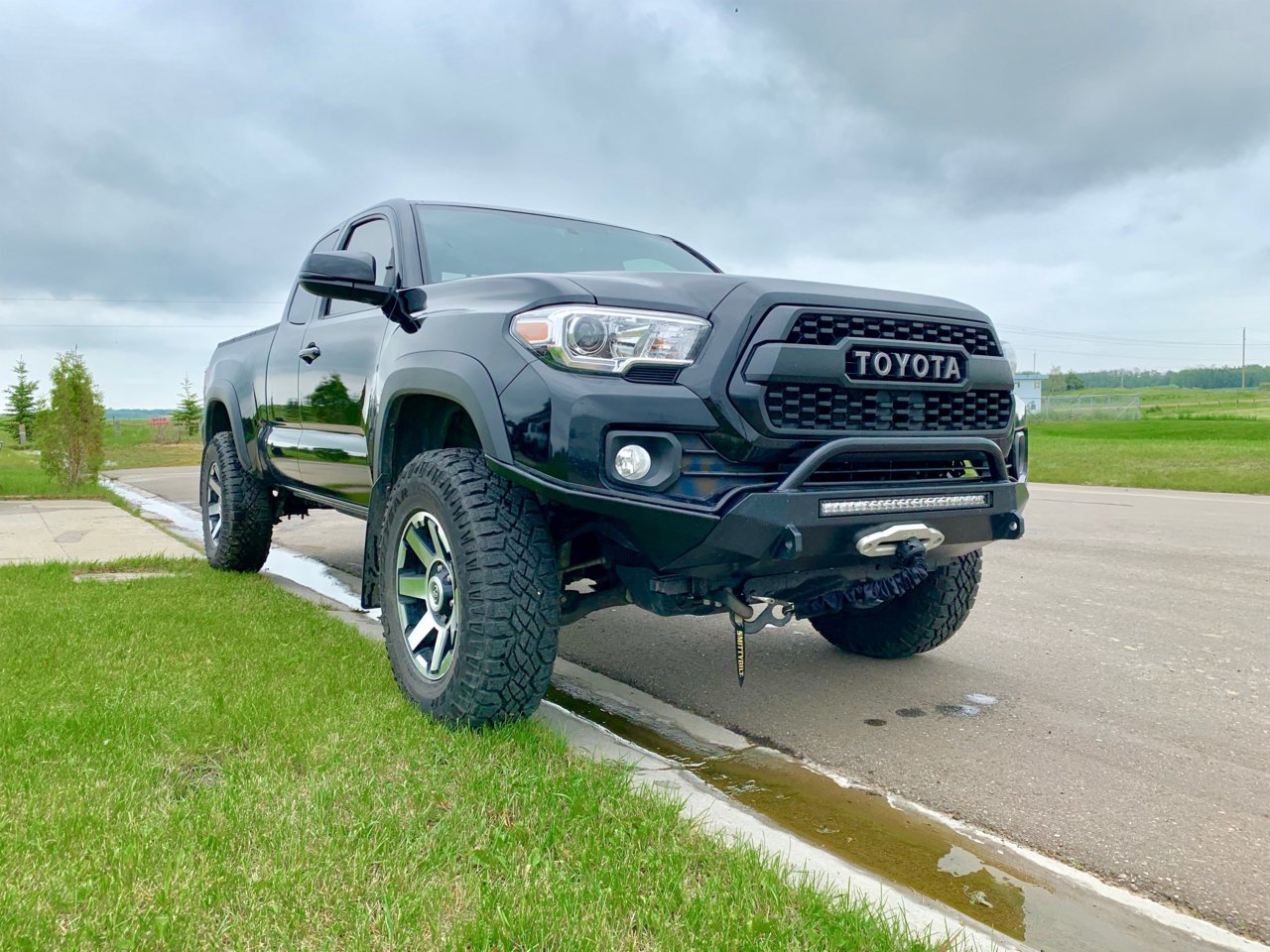

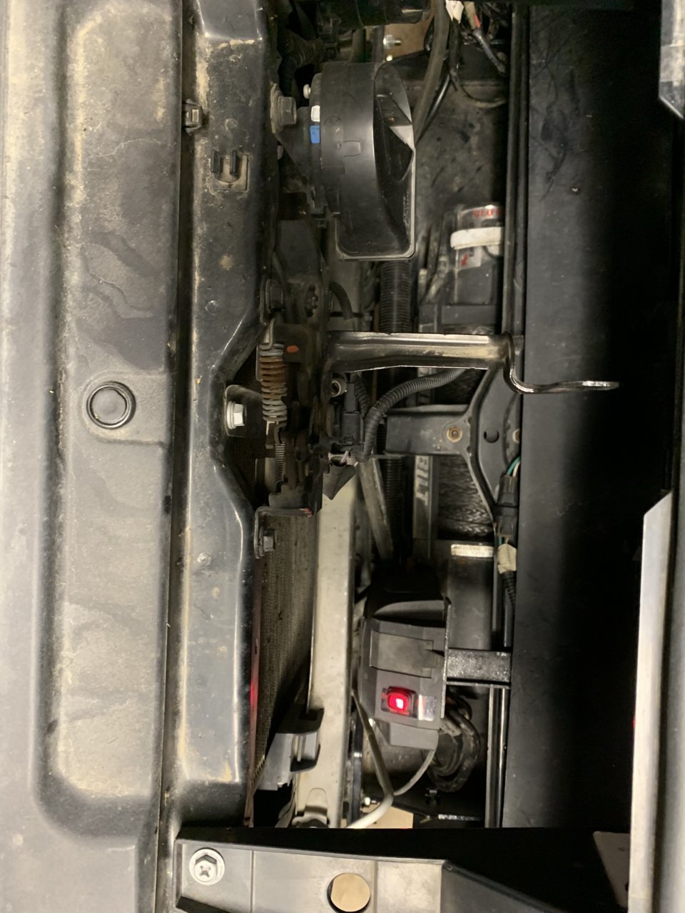

    Got it finished up last night. Tried to get some decent photos, but black bumper on a black truck with an overcast day. Had to over expose and blow out the shadows, but you should get the idea. All in, it wasn't that bad of an install, for anyone that has a block heater installed, you may have to relocate it, you have to unplug it from the element and pull it out through the bumper and reroute it.
    One big tip, for anyone running a Smittybilt X2O waterproof winch, or anyone planning on running one. Replace your wireless switch with a waterproof one, it's a common failure and very easy to fix. Mine hasn't worked for the last couple years, either of these is a direct replacement.
    https://www.amazon.com/GAMA-Electro...tch/dp/B0039KZP4Y?ref_=bl_dp_s_web_2592348011
    or the illuminated one (which is what I went with, just had to add the ground wire)
    https://www.amazon.com/GAMA-Electro...ker/dp/B0039L0GKG?ref_=bl_dp_s_web_2592348011
    I relocated my control box, with the wireless not working, wife had a had time getting the remote plugged in, the mounts had also rusted to the point they snapped off when I was removing the bumper.
    The only other thing I would add, for @SouthernStyleOffRoad is if the hardware was 1/4" longer it would have been ideal, I added two shims and the included bolts were just barely long enough.
