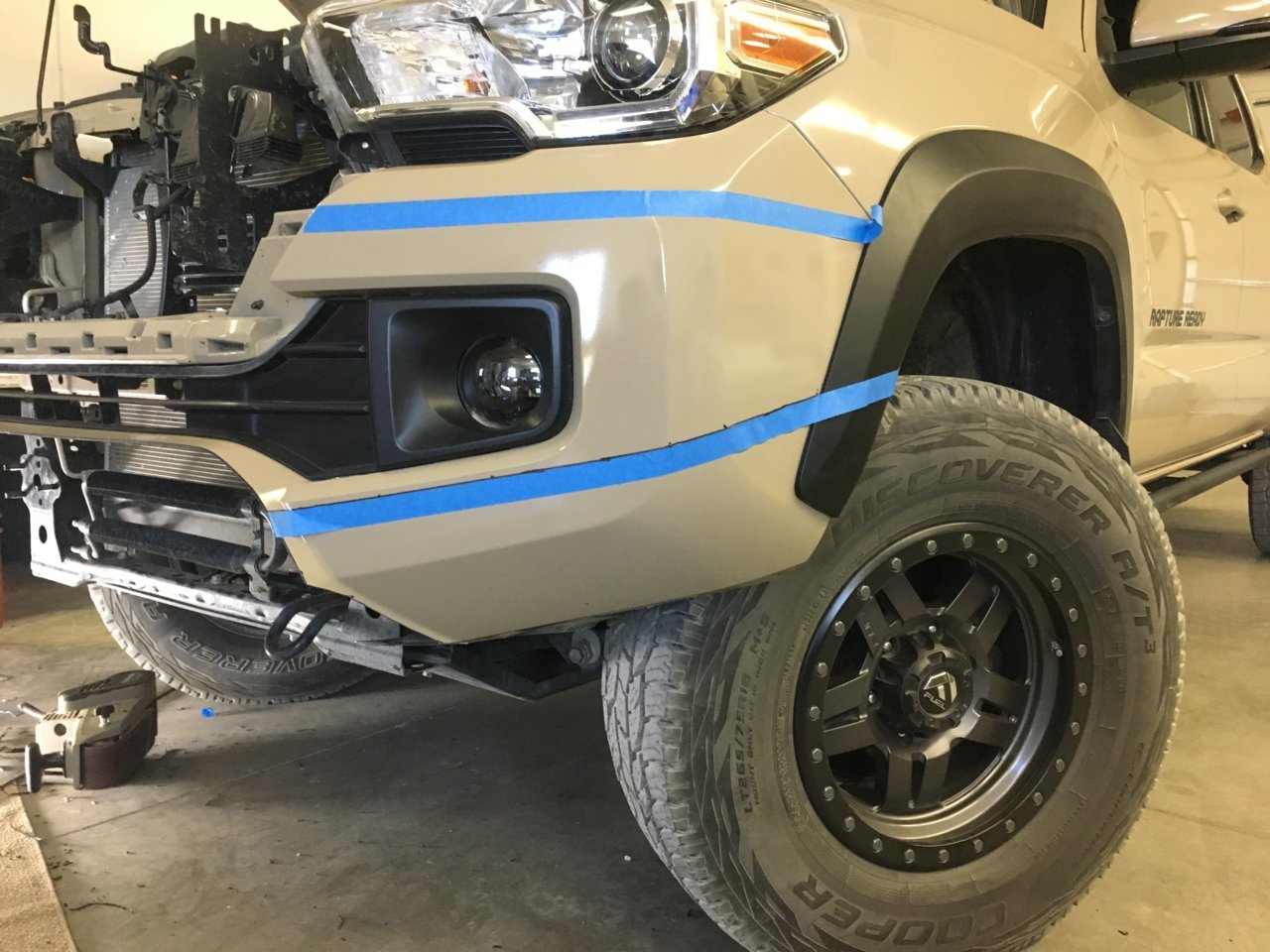

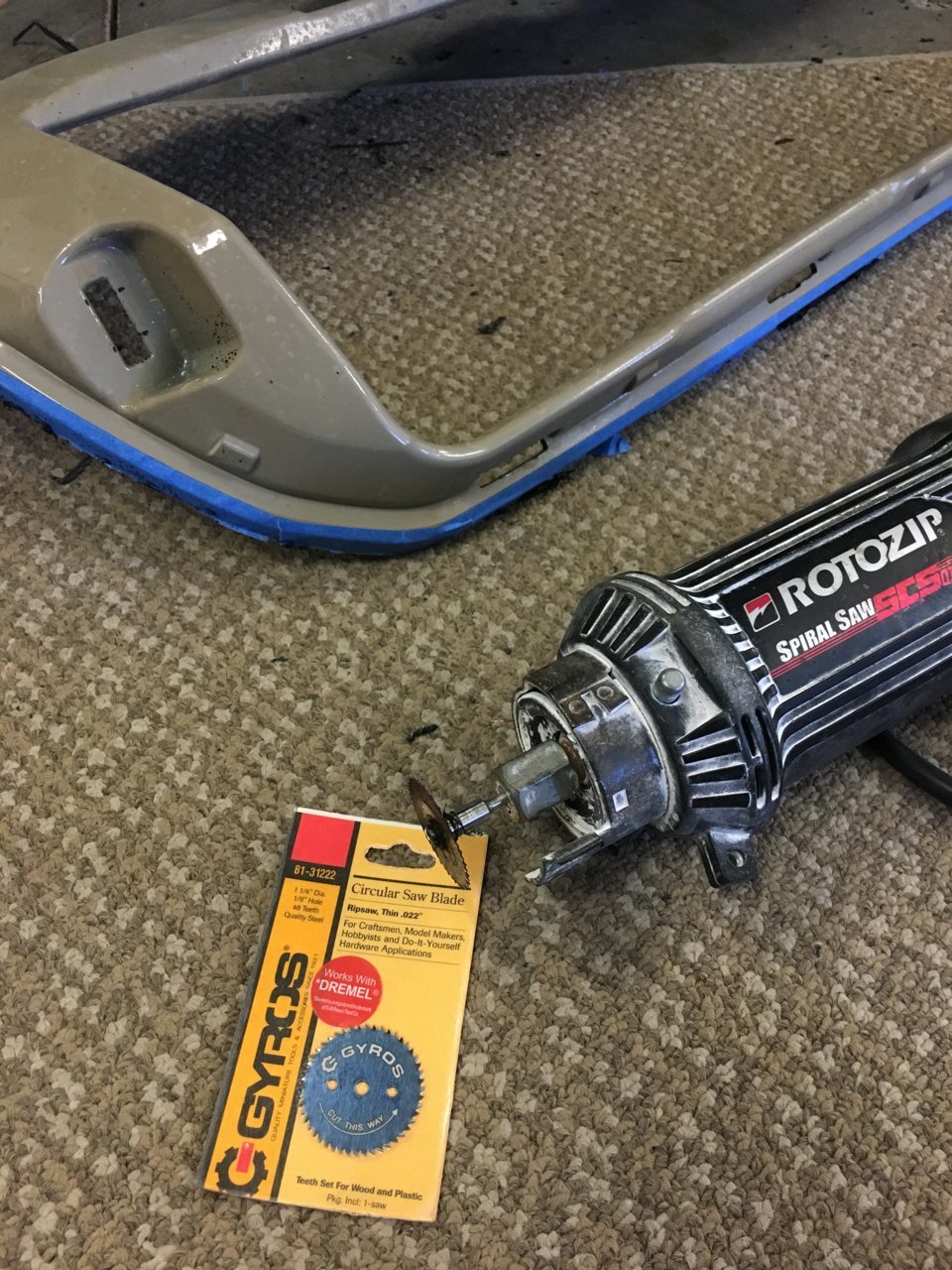

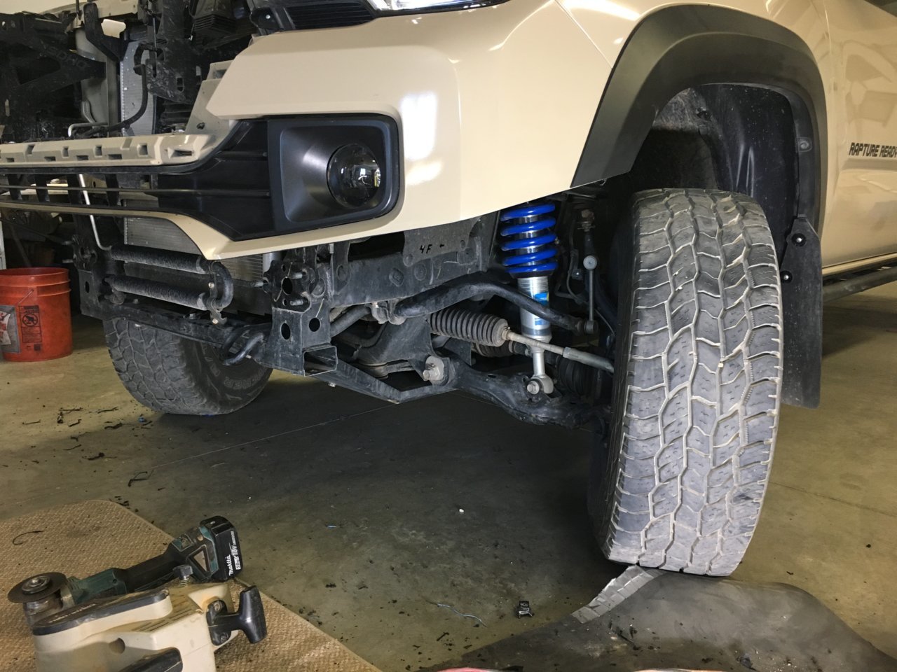

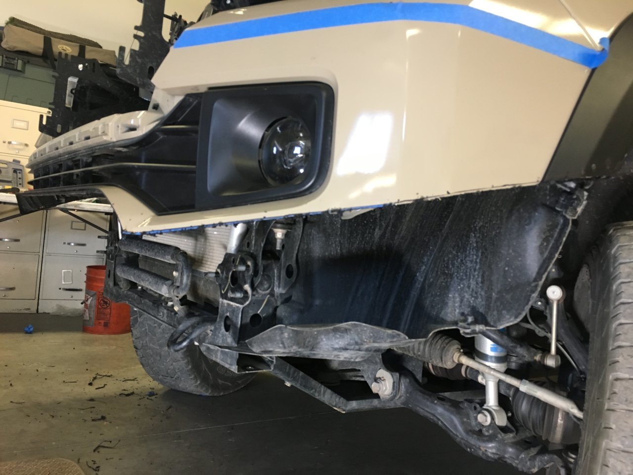

    I started my install yesterday. I’m finishing cutting today and dry fitting bumper tomorrow. I’ll be welding stage 2 kit to bumper, painting and installing next week.
    Here’s what I’m using to cut plastic, working great. 1DBBDC91-7508-4603-B887-FEDFFFA7B763.jpgB48AC1FC-6F9F-4E60-A114-95F53B4EF3F6.jpgC87772C0-8B63-4B01-8F13-E1E4ACB4ADA5.jpg

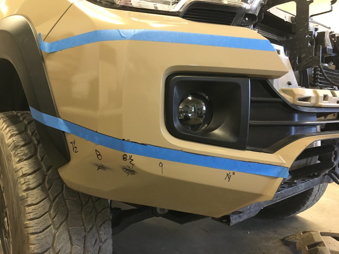

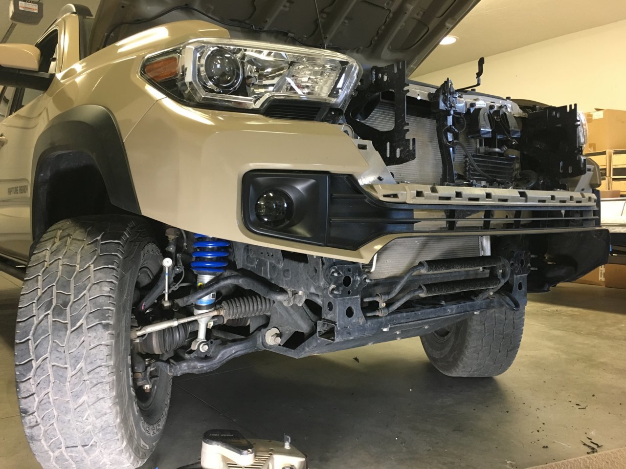

    Got some more work done this evening. Finished cutting plastic.
    I switched to cutting with a makita cordless grinder with a metal cutting wheel, it worked better than the Roto zip. I used a belt sander to finish sand and a block with sand paper to fine tune.
    A utility knife to cut inner fenders.
    I'll post a few more photos tomorrow

    Those are some clean cut lines! I like the idea of belt sanding and then blocking them back to final positions. I'm defiantly stealing that idea.

    You've got to be gentle with belt sander, but it worked great because it's got 6"-8" flat surface to keep thing level and square. I cut everything +1/4" and will sand to fit tight today. I'm planning on welding everything up so I won't have much adjustment with the stage 2. Measure twice cut once.

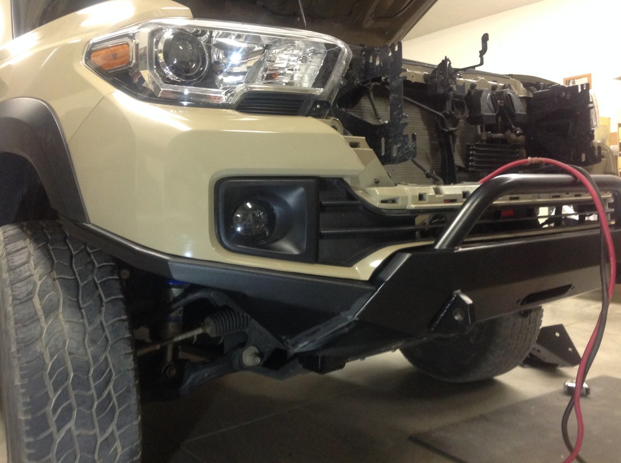

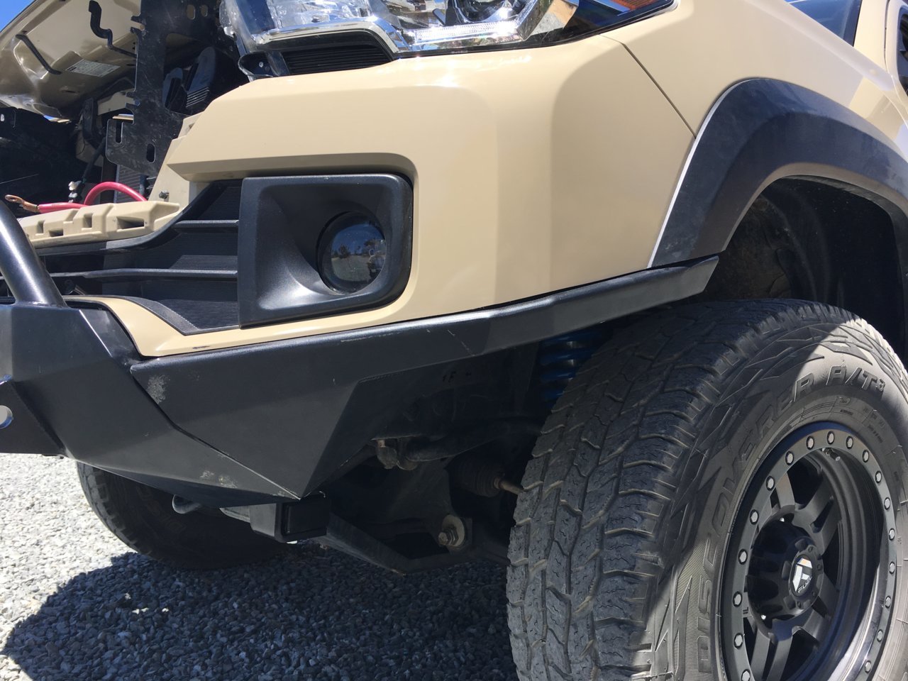

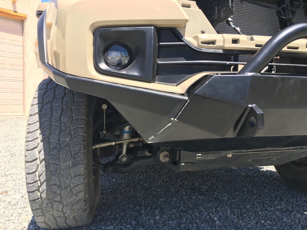

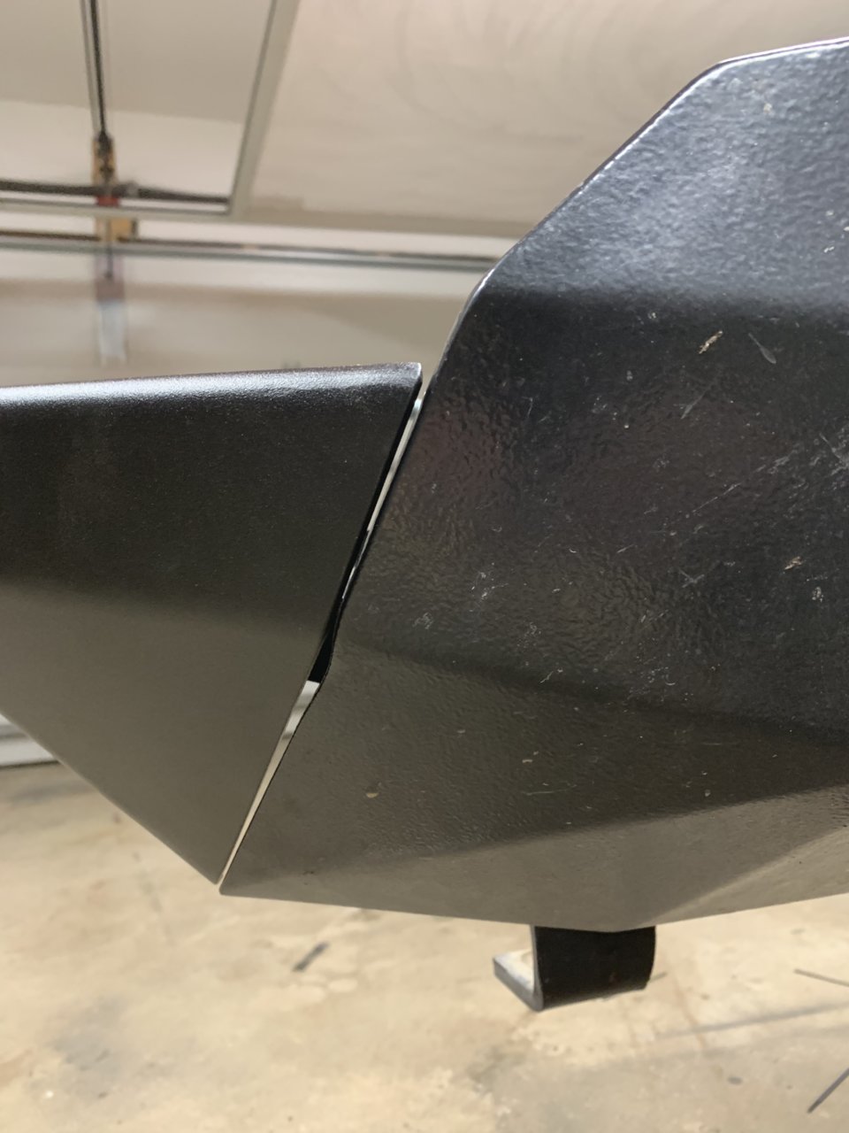

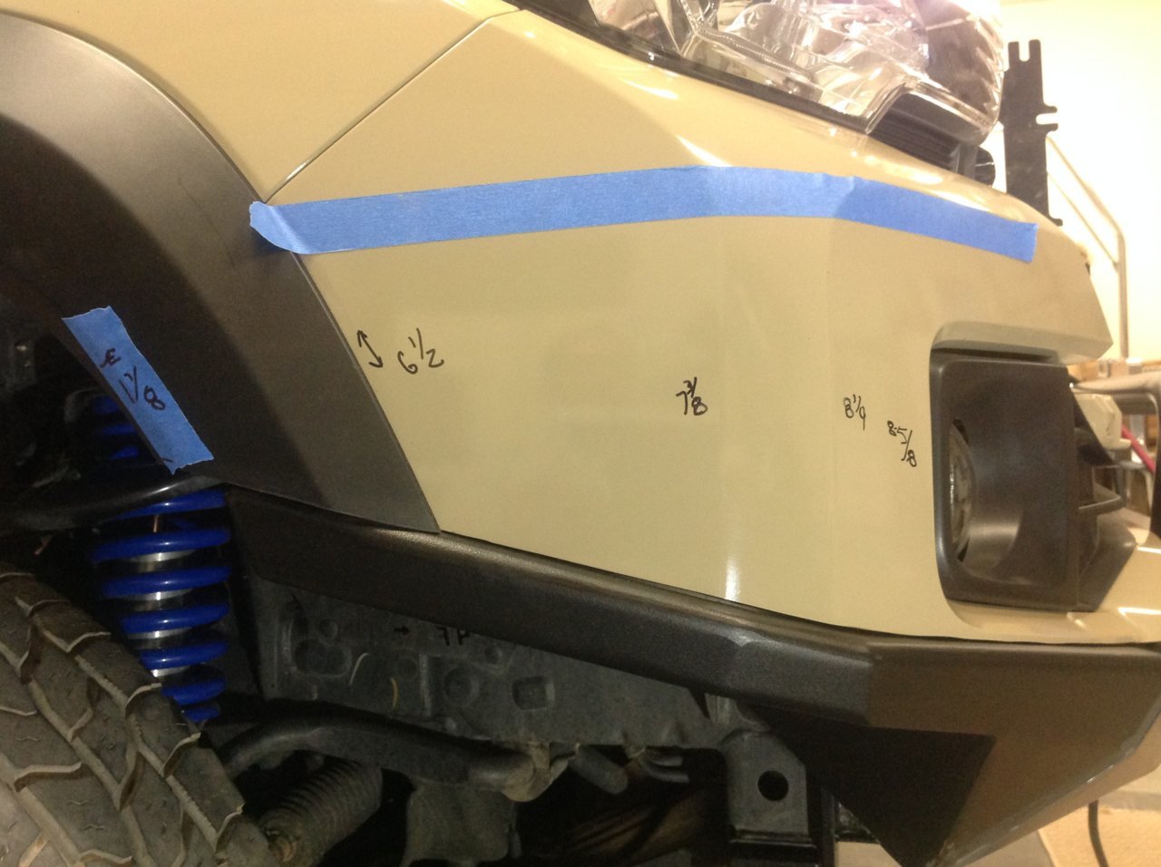

    Well I've gotten to work a couple of more times on this project. We got the passenger side dialed in Thursday evening, took us a lot of mock ups and trimming to get it right. And a 3lb sledgehammer. My original measurements (Taken from the install video) and my actual final cut measurements are very different. I also had to to some grinding on the edges of the Bumper to get even reveal.
    I worked on it today for a few hours, recut the plastic on the drivers side starting mocking up stage 2. I could not get it even close to looking right, tried shimming ect. Was getting frustrated that it wasn't fitting no matter how I shimmed it. I had poor reveal on the seam 1/4" at the top and a 1/2" gap at my wheel well trim with 2 stacks of 3 shims in the bottom.
    I removed the stage 2 and did some tweaking with a 3lb sledgehammer on the flanges upper and lower where it bolts into the side of bumper. And I tweaked the end 8"-12" of the wing so it would fit into wheel well better. Bolted it back up, the reveal is now even, but it's 1/8" gap. I'm planning on welding everything up so that's not an issue. The gap along the plastic is nice. Both sides are Looking Good.
    Next time I work on it, we'll double check everything, see if we can remove complete assembled bumper from truck. If that works we'll be welding the stage 2 kit to the bumper and welding the seams on the face. Than reinstall the Warn winch into the bumper and reinstall full bumper into the truck. If everything works as planned than it's time to remove it, sand and prime and paint with rustolium bed liner paint to match my sliders. Or have it sand blasted and re powder painted.
    One step at a time.
    Hope this helps some of you guys looking to tackle this project.
    If you don't mind an 1/8" gap here or there, than you might just be able bolt it up using a few shims, but I'm wanting to make this look as close to factory as possible. Be Blessed.

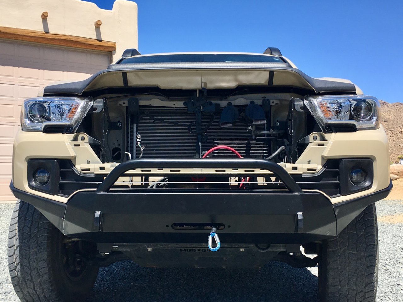

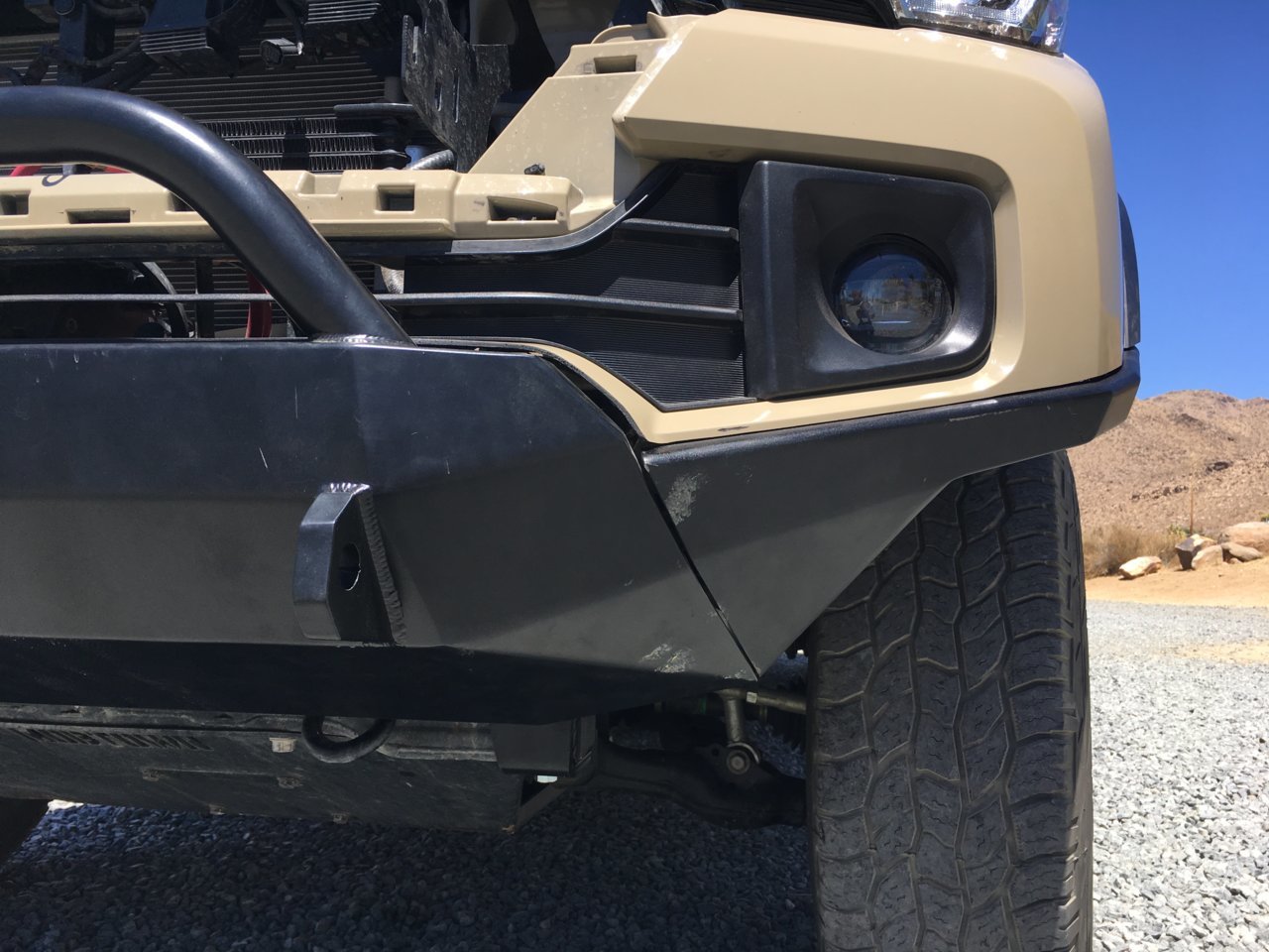

    Finished mine today!
