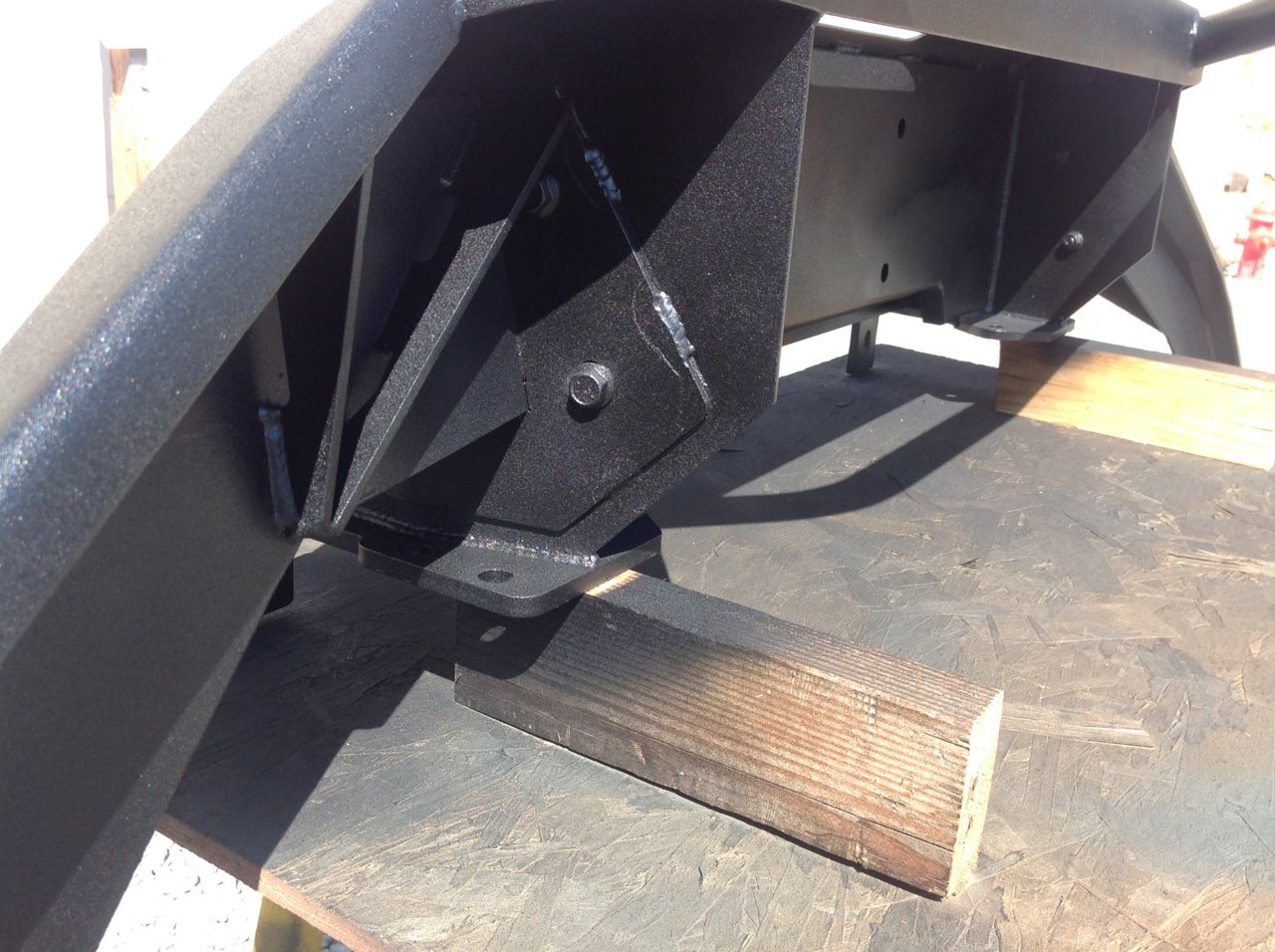

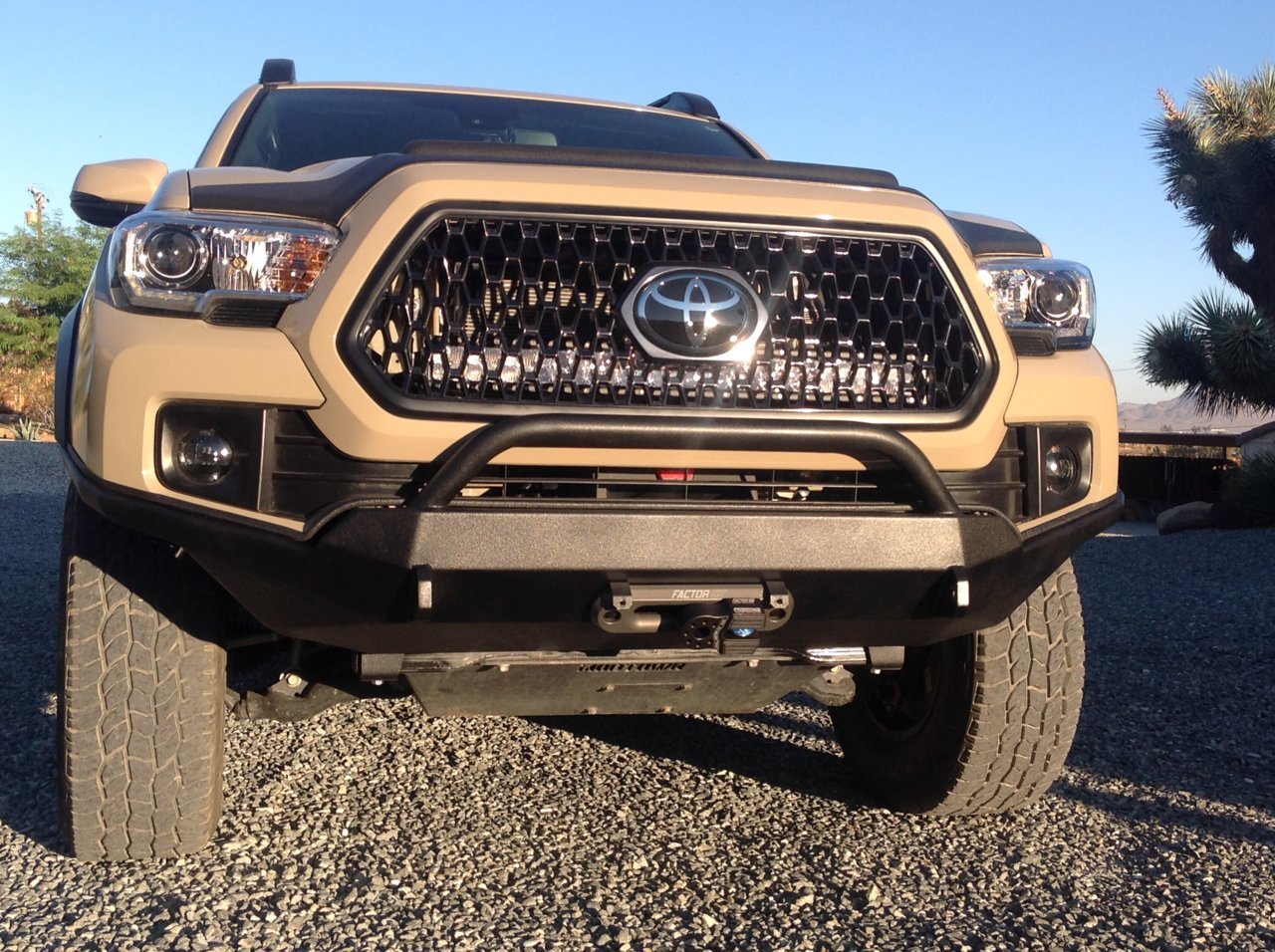

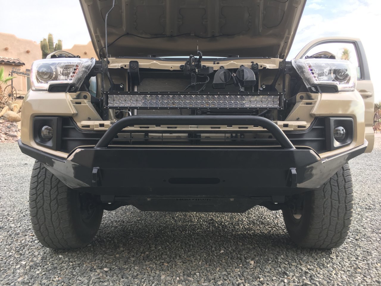

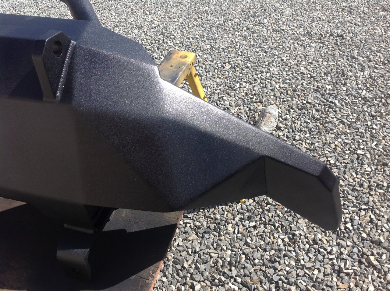

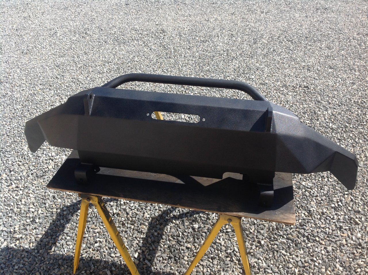

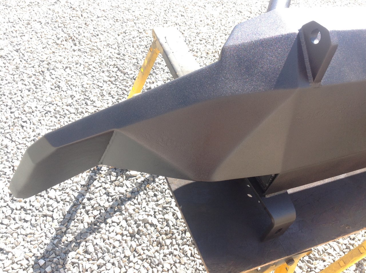

    Well I've been chipping away at it after work this week. We tried welding the face with a nice clean bead and I was planning on leaving them exposed, but the gap on the drivers side would not allow for a clean bead that matched the passenger side. So we tig welded both sides and did a lot of finish grinding. Finish product A+. We also welded the flanges where the stage 2 bolts up. After welding I reinstalled and had to do some fine tuning on the plastic cuts.
    I've now sanded the powder paint off the outside of the bumper primered with rustolium self etching primer and applied the rustolium bed liner to match my sliders. This is easy to repair when the bumper is scratched or dinged in the future. It's not as tough as a good powder paint but it easier to repair and cost me $50 instead of $400. I've had a lot of stuff powder painted and it's really overrated, it all needs to be refinished after 5-10 yrs. living in The Mojave Desert we don't have to worry about rust like most of you all do.
    I'm hoping to make some time this weekend to finish the project. I'll shoot a few photos of the finished product in a few days. Be Blessed.

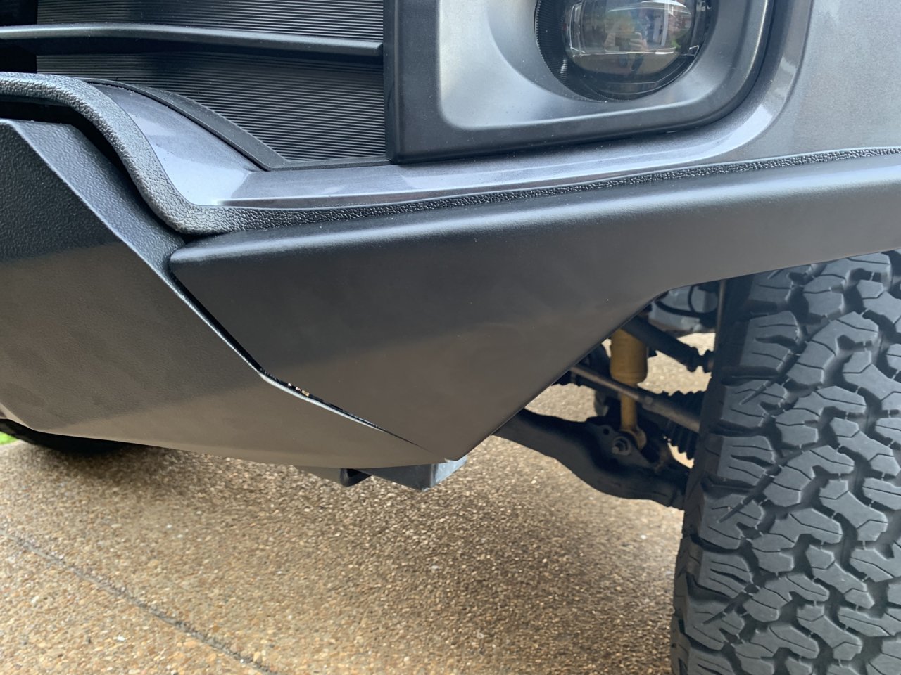

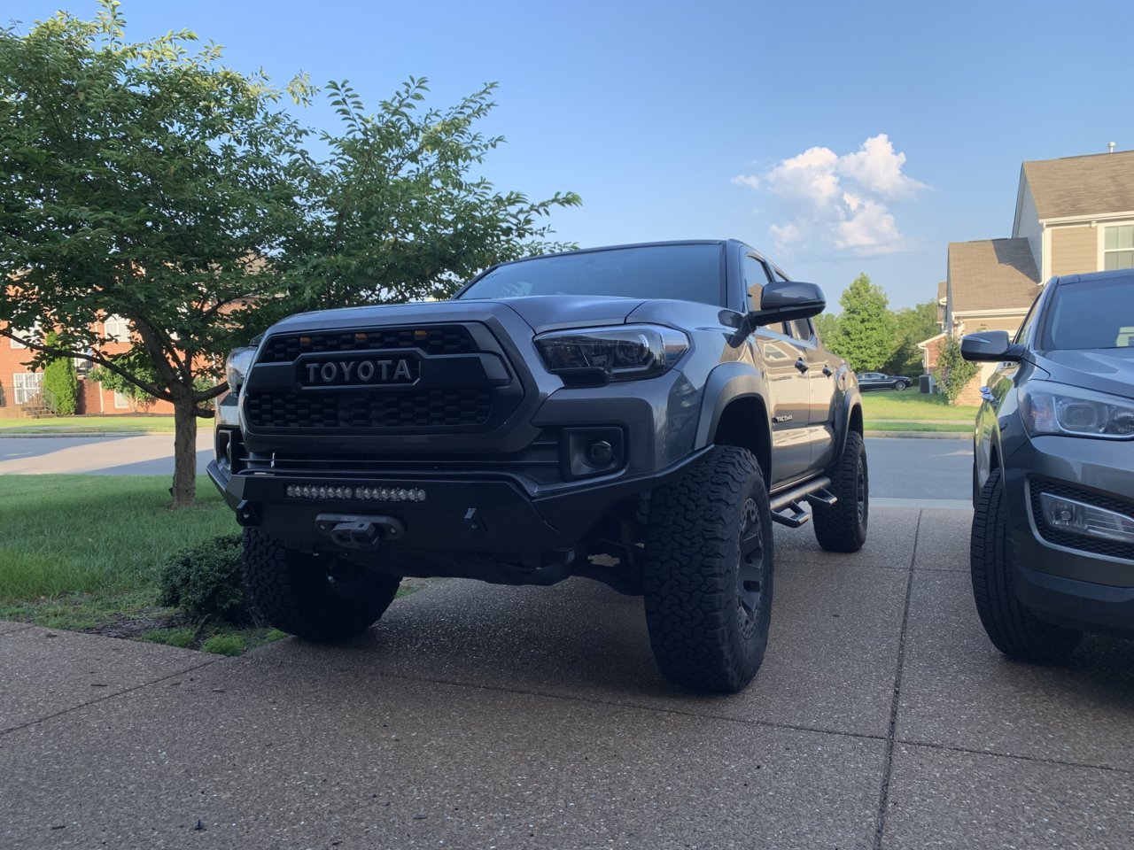

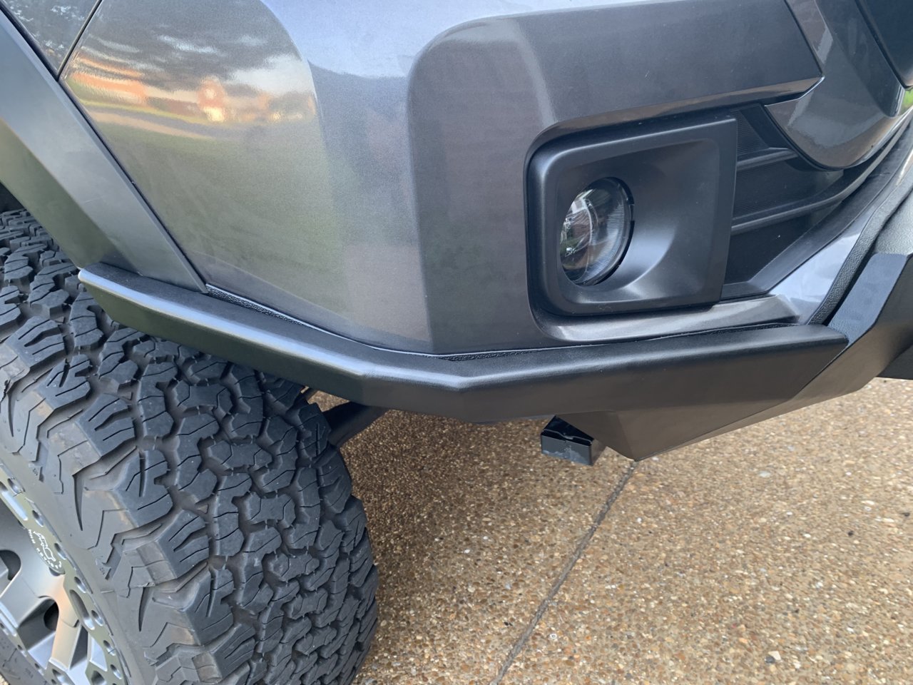

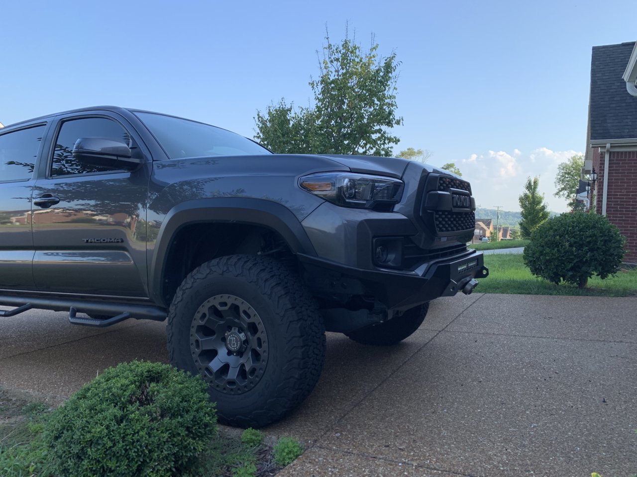

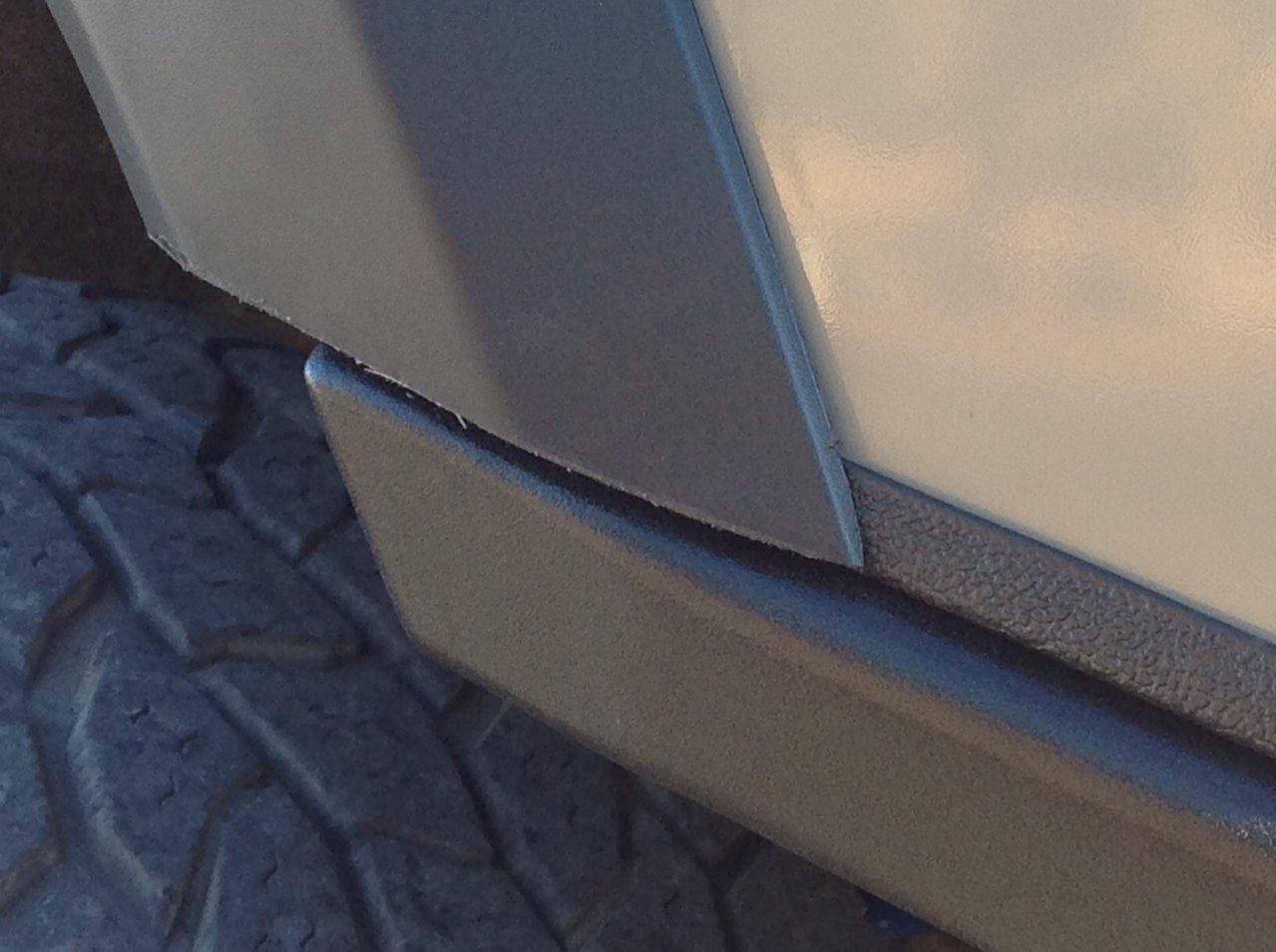

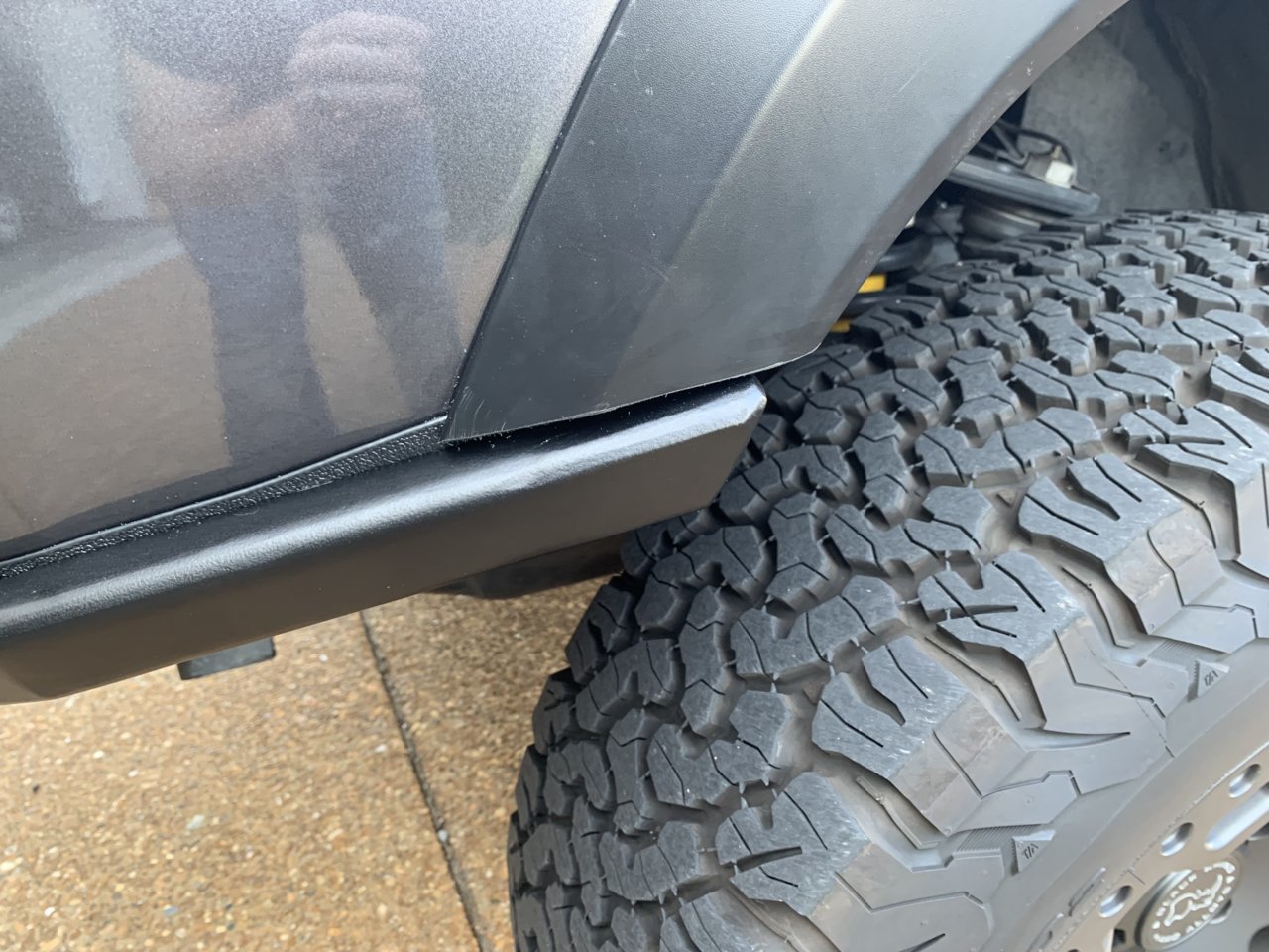

    Well, I worked on this from about 8:00pm - 2:00am'sih. I will say from a distance it looks amazing and I love it overall... BUT when you get up close to see the details it can be a bit disappointing. I am sure some of these issues just come with the territory of getting aftermarket parts while everyone's truck is a little different. I tinkered with the stage 2 sides for a very long time to try and get the gaps minimized while also keeping it lined up but I could not get it to look right. The passenger side looks ok but the driver side is off. I made my cuts and they were damn near exact to what was shown in the video on every single point of reference but when I mounted up the bumper... the stage 2 goes over the entire area and covers almost the entire trim piece in most areas. I also have a bigger gap on the slimline edge on the driver side. I am not really sure how to fix any of this by shifting the bumper, so I am thinking I just draw a line while it is still mounted and then recut everything? Any advice in this area would be great. You can see the passenger side is very overlapped on the fender area but the driver side has a big gap. I will mess with it more today to see what I can do but I am thinking I am going to have to take it off and try and trim more.

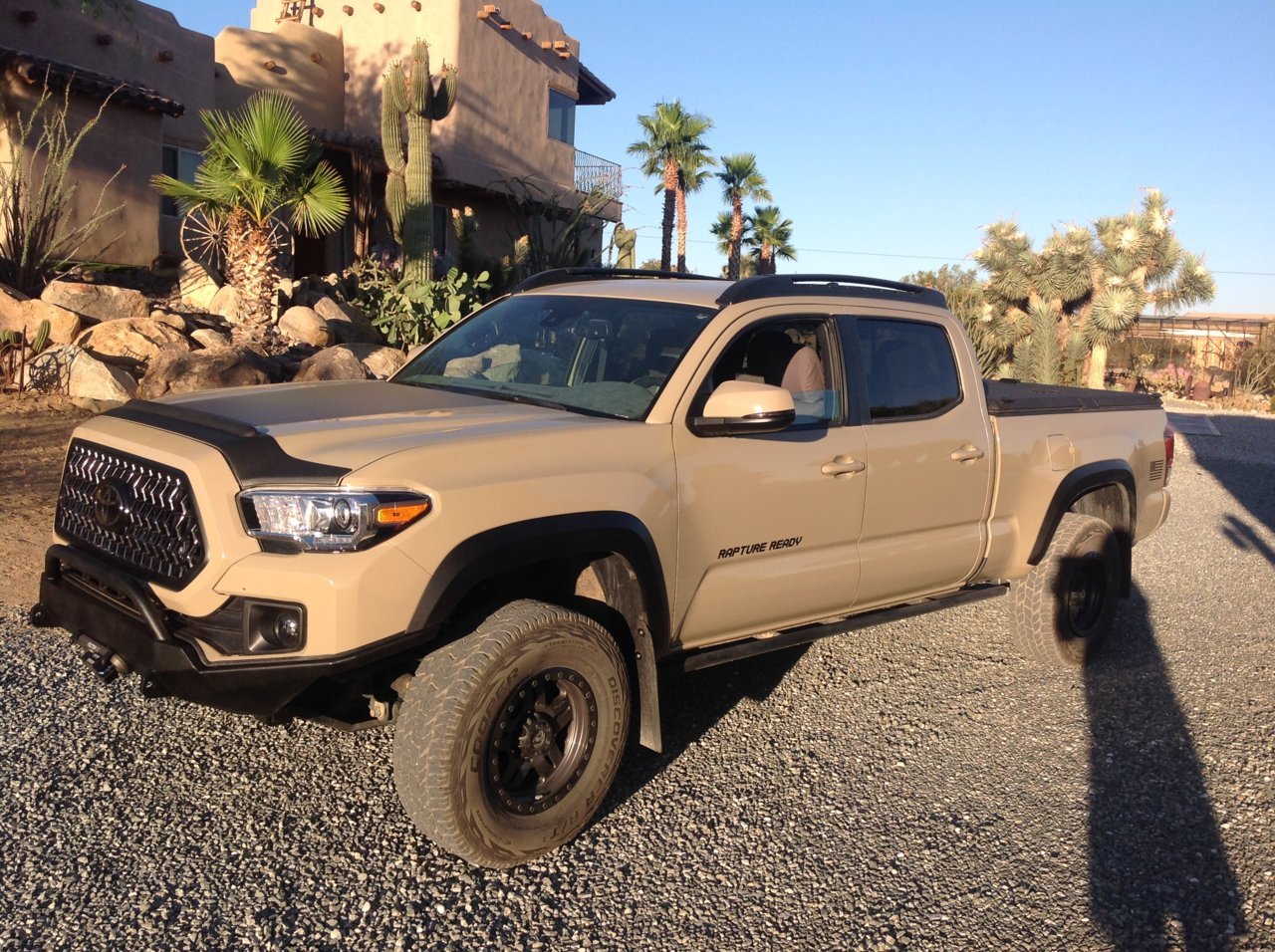

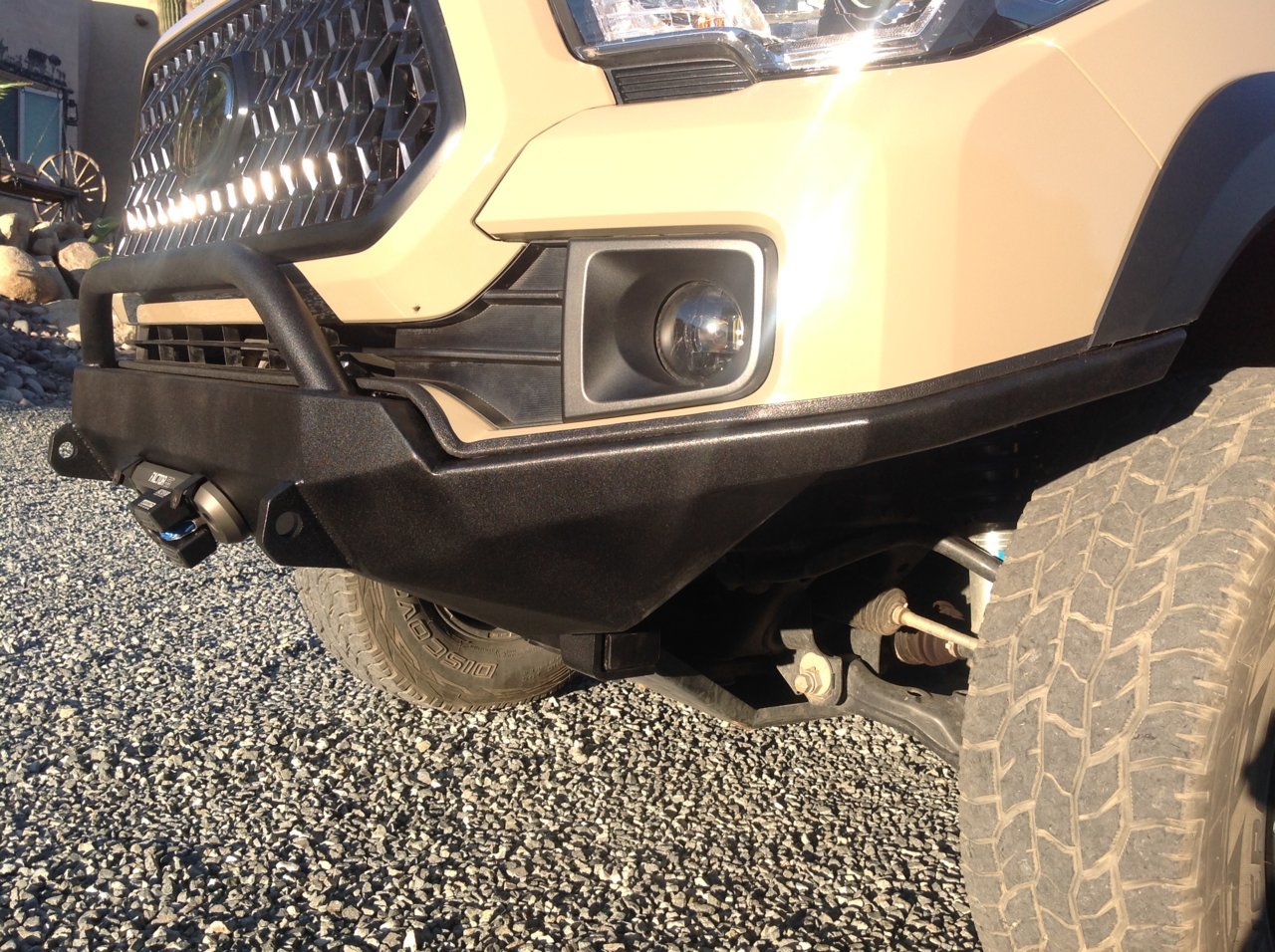

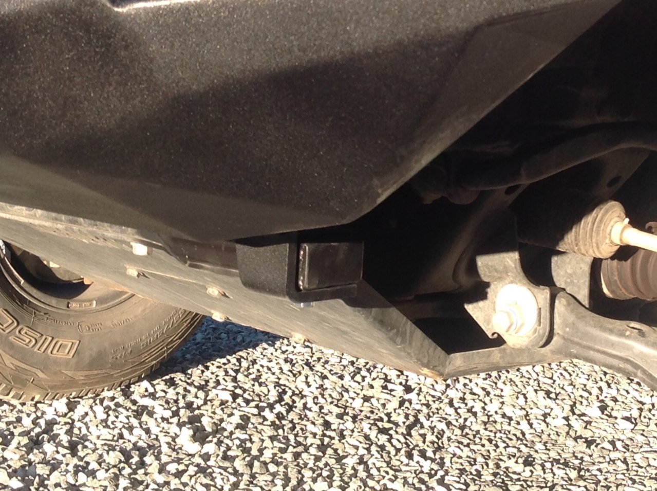

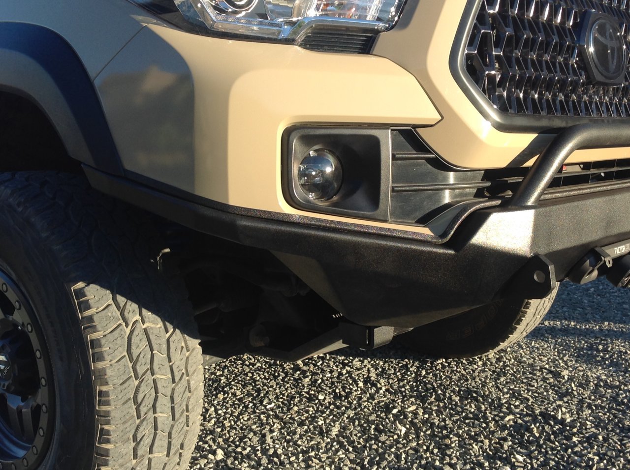

    Mission complete :) I worked late last night and got just about wrapped up. I ordered some kydex to rebuilt the inner fender wells I cut out, that will be later this week.
    I'm extremely happy with the finished product, but it took A Lot of extra work.
    If your planning on installing this bumper at the moment, I would purchase it bare metal, bolt it all up, mock it upon your truck, make necessary adjustments, with grinder and hammer, paint or powder paint it, than install and make final adjustments to plastic cuts on truck.
    Sorry but 1/8" gaps are not ok.
    I'm sure on new systems purchased as a set things will be tighter, but I would still purchase it bare metal.
    I removed, cut and capped the 2"-3" tubing that has the nuts for the lower bumper bolts so it's not sticking out 4" on both sides.
    I also ran the plastic edging behind the fender flares, trimming the front on the plastic flare so the trim would tuck under it nicely, than I backfill the gap under the black plastic flare with silicone caulking to secure it to truck better.
    To the guy that posted before me. You've got to cut your plastic on both sides quit a bit more, the edge trim should sit on top of the bumper, your's is tucked behind the bumper, which is causing the center area to push up away from the bumper. That's why you've got such a large gap along the center
    Peace, Joy and Love. The Greatest Is Love.

    Do you think the best option would be to take and draw a line along the line that mine is currently sitting and then just cut along that line? Or should I cut a little above the line or below? I guess I am not sure what you did to make it so perfect.

    Before you cut your bumper higher I would try lowering the stage two wings. It's hard to tell from the pictures but it looks like you have them at the wrong angle.

    Yeah, you've got the plastic in a bind. It should install from underneath the plastic, not inf front. I see theres also a large gap above the slimline as well. Make sure the slimline fits well within the cuts before bolting on the side wings.

    2017 Tacoma TRD Off Road
    There is not much play available but I got it lined up as close as possible after messing with it for hours.

    About your install.
    I would remove the black edging.
    Mark your plastic with a sharpie.
    Remove the bumper.
    Trim your plastic leaving an extra 1/8”.
    Leaving edging off, reinstall the bumper, keeping plastic on top of bumper, adjust stage 2’s so reveal is satisfactory. Remark plastic with sharpie.
    Remove bumper trim plastic again.
    Remount bumper check all plastic to fit. Make sure plastic is relaxed should have 1/16-1/8” gap.
    Remove bumper install black edging.
    Mount bumper final time.
    Take your time and do it step by step and it’ll look good.
    I’ve got 30 hours in the total job.
    Mounting bumper, stage 2 kit, prepping truck for warn winch, installing everything and wiring winch and light bar.
    Hope this helps.
