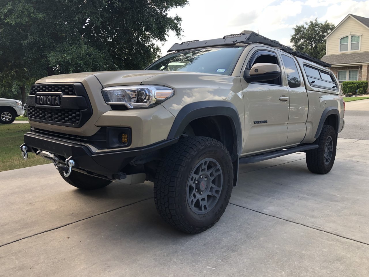

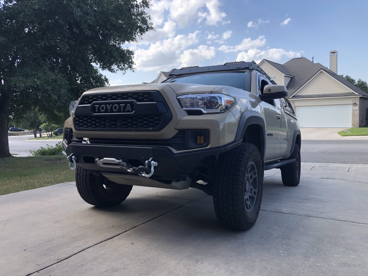

    Little late response, but I bolted a cheap hinged fairlead mount plate holder to mine. Bolted it to the face because I felt like the one that mounts to the fairlead would drag off road.
    Sorry this is about the best picture I have, the hinge isn't really noticeable. [​IMG]

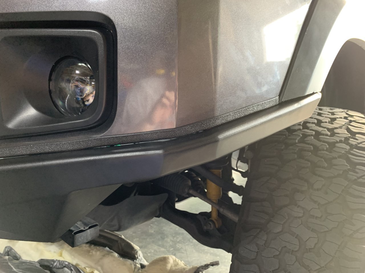

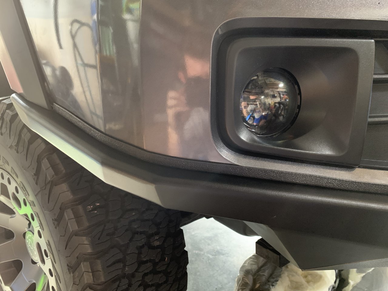

    Is there anything I can do to get that driver side wing to line up better? It fits the top line and the curve perfectly but then just does not follow the same like at the tip at the bottom.

    Thanks for the link. This is the look I'm going for (license plate). So, did you drill two holes in the front of the bumper to mount it? A close up picture would be great if you get around to it....

    Yes. I had already drilled two holes and originally had the license attached with thumbscrews, so I just added this where the thumb screws were.

    What a difference a day, some patience, and some awesome advice from SSO and Sooty can do! Lined it all up again, did some extra cutting, sanding, and shimming to get what I think is as perfect as I am capable of as far as fit goes.A9D7CA0B-58C1-411A-B80F-5483F81273AB.jpg09C90241-4155-4D83-950E-6BBAA184DCA7.jpg

    262
    Nashville
    2017 Tacoma TRD Off Road
    M m
    I followed what he talked about in his post about using a belt sander to make it even and making sure to do some test fits with the plastic a little longer to see where you should make minor adjustments before tightening everything down. Mainly just see how much work he put into it with asking it on and off because it probably won’t be perfect on the first cut. I just left about 1/2 inch more than I should have on most areas.

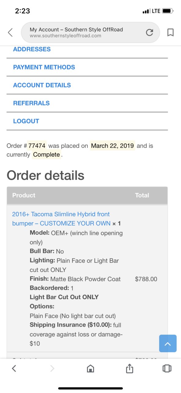

    Dear Joseph, attached is your order's total. As you can see, you only paid $49 for shipping which was 100% refunded to you as promised. If you have any more concerns, questions, I'll be happy to assist you. Extension 3, Lee@SouthernStyleOffroad.com.

    SERIOUSLY?? Like how many mistakes can you make with one order. This is crazy!! I paid a total of $59 for shipping. $49 for the base rate and then another $10 for insurance. Look at the attachment. Do you need help understanding your own invoice? This has gotten beyond ridiculous.
    So like I said, I paid $59 for shipping not $49.
