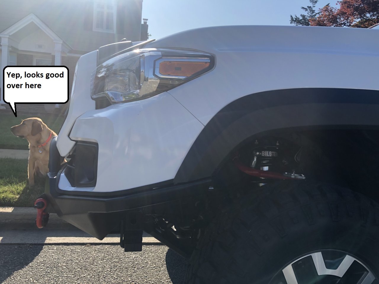

    Finished installing bumper and stage 2. It took about 20 hrs to mount everything and wire up winch and light bar. I also installed a winch power interrupt solenoid. Most of my time spent reading and re-reading cutting directions. I feel confident that if I had to do it again I could do it in half the time. 6FBD821E-FDB7-4FDA-9F4A-CABFE269F23A.jpg3D7A3E35-79E2-4777-9803-893AC9BF5908.jpgF5B8EA8B-55DB-42AB-B2E7-60DBD7BBD33B.jpgA9C0C072-19E2-4C26-A58A-C8C2BA72E63C.jpg2685BE66-E180-41E0-BC27-165C7E094313.jpg12FB55EB-BB3E-455F-BFE7-39F23927F658.jpg

    Looks good but looks like the passenger side is an inch short from lining up with the fender. Is it too short or does it just need some adjusting?

    I didn’t even notice til you just pointed it out. I will obviously be messing with it first chance I get. Thanks for heads up. I can’t believe I didn’t notice this. o_O

    We assure you that each side is an identical mirrored copy of the other. This misalignment is due to slight frame and body differences from truck to truck. Some may be dead even, some may be biased to driver or passenger side. The only way to try and correct it would be to loosen all the body mount bolts and try to rotate the body. I've attached pictures of test fit pieces and the main wing backbone to show they are equal.20190813_103031.jpg 20190813_103022.jpg 20190813_103153.jpg

    I noticed this too. Didn't want to say anything, since it seemed like you were happy with it. Report back if you can get it adjusted properly. I have a stage 2 coming and I'm getting a bit nervous with all of the fitment issues I've seen.

    FYI, it also looks like your grille surround isn't properly seated. Might want to take a stab at getting that situated away as well.

    It was the grille itself. 3 of the tabs were not seated in the slots. I finished the first night right at dusk and obviously a couple of things were missed. The following day I spent wiring winch and light bar and switches. I jumped the gun on posting pics. The good news is that these are minor fixable issues that have been addressed and I didn’t fuck up any cuts.

    The difference in passenger and driver is 3/8”. When it isn’t raining I believe I can loosen mounts and even out the difference. I believe you will be happy with their product. Obviously another set of eyes would have helped. My yellow lab helper is fired

    Out of frame to the left...

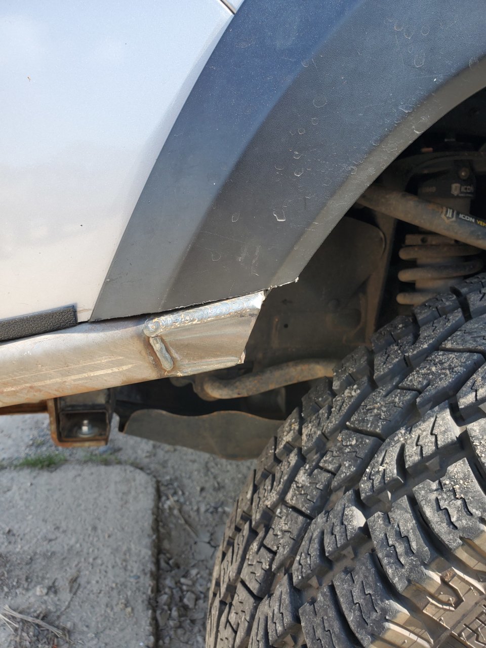

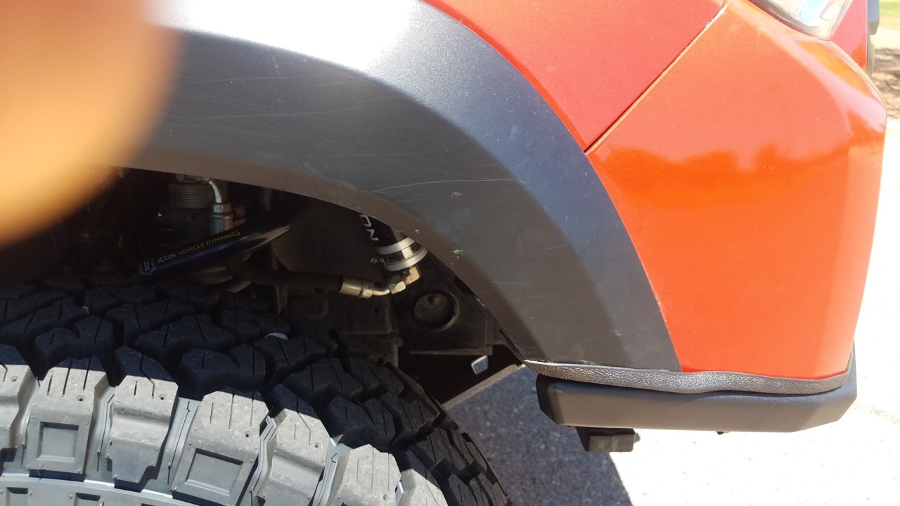

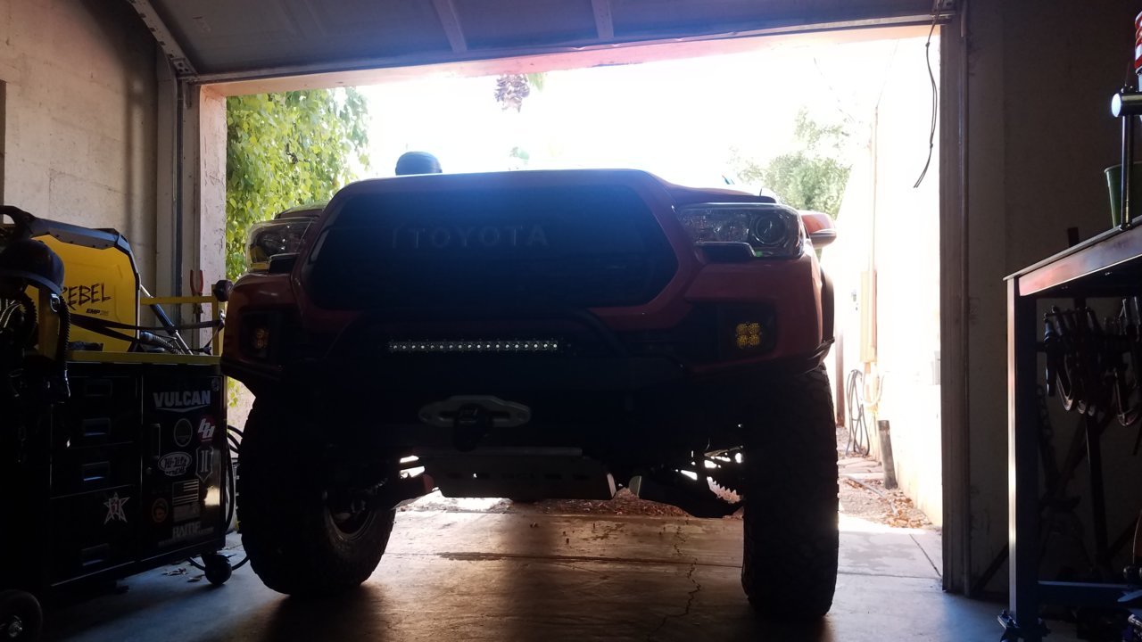

    Got the stage 2 installed this AM. It took about 2 and a half hours and most of the time was me being stubborn trying to lift the entire bolted together bumper on to the truck by myself. I just couldn't rotate it correctly so I just ended up disassembling it and bolting the wings on after the slimline was mounted. Other than that SSO did an amazing job on this one! Fitment was perfect (I needed 0 shims) and the powdercoat matches perfectly. That's really just outstanding considering my slimline has been on the truck for almost three years!!!!!! Aside from looking amazing my there is no more rub on the fender liner while reversing turning and flexing the suspension. Sorry about the pics. It's dark AF in my garage and bright AF outside today.
    20190814_121019.jpg 20190814_121011.jpg 20190814_120947.jpg 20190814_120432.jpg 20190814_121202.jpg 20190814_121326.jpg 20190814_121233.jpg
    I used the oscilator to make the cuts. Worked out way better than the dremmel for me. I dont have the fine motor coordination to keep the little dremmel blade still.
