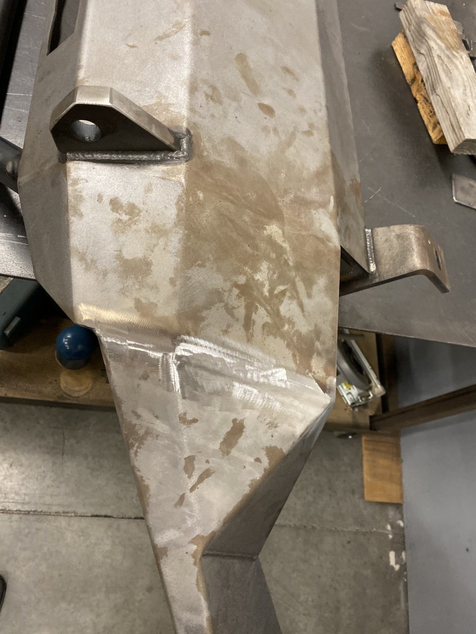

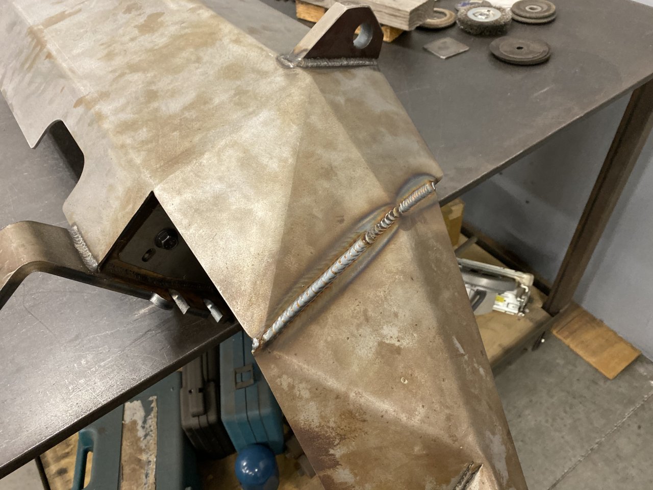

    TRDtacomamr2.
    Same issues with my install back in July.
    Look up post 588,632,641 and 655 when I completed the install.
    1/4"-1/2" gaps are not going to work for me. The only solution was to grind and weld pieces up, to create a 1pc bumper.
    I also had the same issues with the end of the stage2 wings not being even at the wheel wells. Passenger side is 1" shorter on my truck, if I would of noticed that on roughing the bumper up, we could of extended to match when we were cutting and welding.
    Here's a few photos 5 months later everything still looking good.
    I bought a sheet of kydex to repair/rebuild my inner wheel well liners, to keep road debris from slinging into engine compartment. I'll get to that project when business slows down a bit.

    Damn, it looks good welded
    TRDtacomamr2 and GillyLink like this.

    Thank you for the information. Seems we have the same problem. Did sso off-road send you a new piece or anything? I got a new passenger side wing from them that I haven’t installed yet but will be shortly to see if it is right. I welded my passenger wing on for now until I get the time to fully weld it. That looks amazing by the way great job.

    Just made it work to my liking.

    I had my bumper welded to a single piece. Pretty happy with how it came out.
