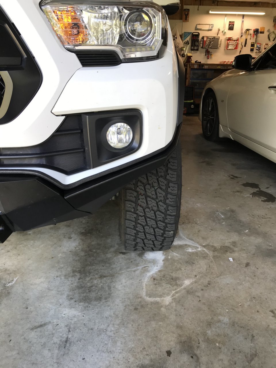

    Had the opportunity to do a stock "face off" and cash for a SSO Slimline Stage 2 with trimmed oem "face"...still haven't put the fender flares and clips and tape back on.
    Of course my stock crash bar wouldn't just come off, it needed some "persuasion" and likewise getting the SSO on my horns required some extra elbow grease. I think I'll have a little bit more trimming on the drivers side for sure, passenger side not so much, but it's on and if anything I've maybe had 0.5mpg loss.

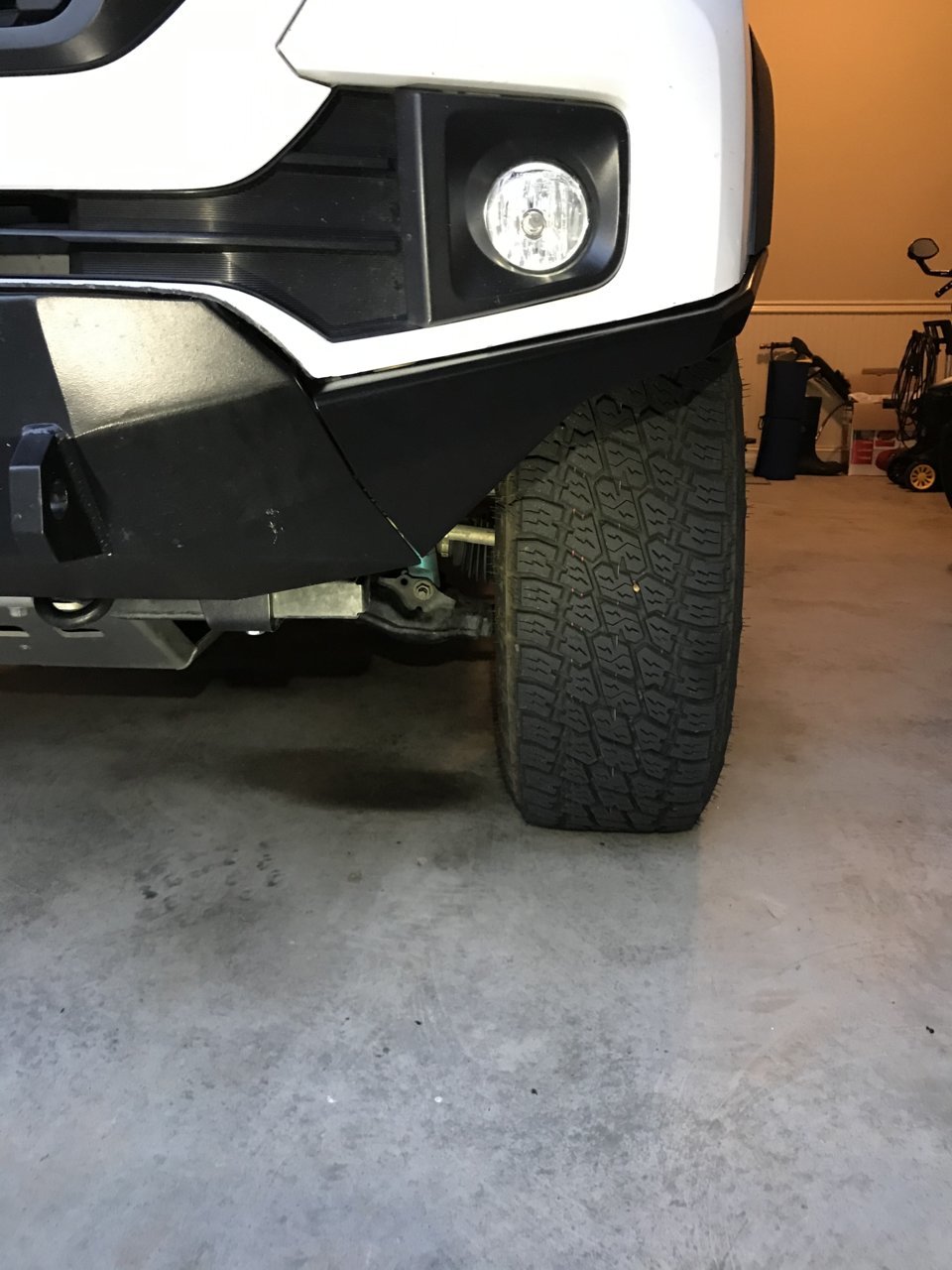

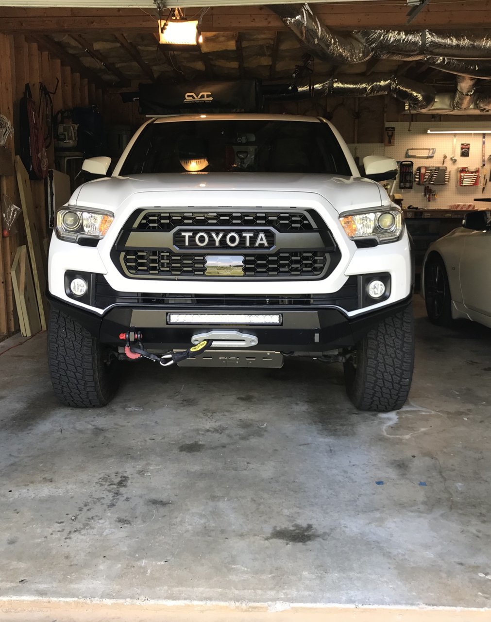

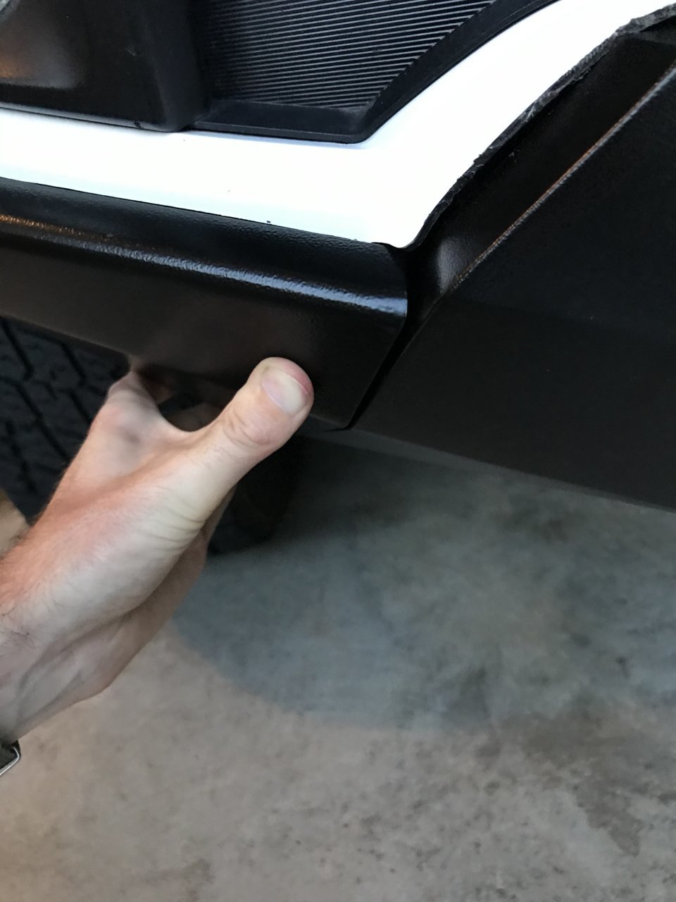

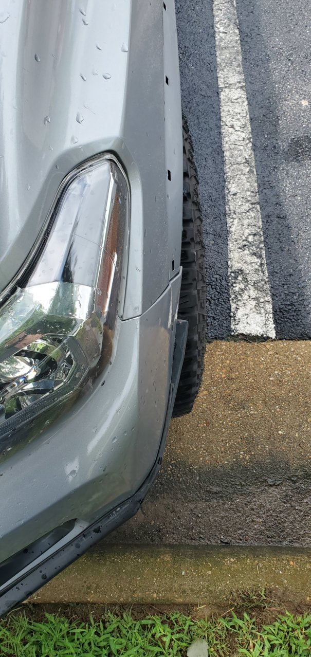

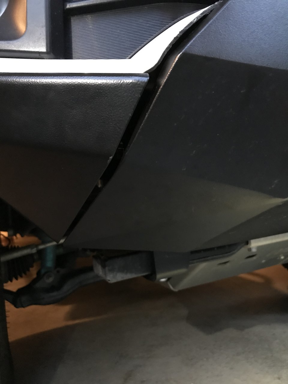

    Has anyone ran into the issue of the passenger side wing not lining up with the fender? I’ve seen the small gaps between the wing and the center slimline, but haven’t seen one that left close to an inch gap when the wing is pushed flush with the fender.
    Gap when outer wing is flush with fender flare:1360345D-E0BF-4F8A-A3F1-EE72D1D95489.jpg
    When the wing is held flush to the slimline, the wing sticks out past the fender flare:787E9C9F-70A6-4C02-AB9F-1D0EB2B9611C.jpg 57A625BA-4A54-423C-BFB6-7FC9A54FB2A3.jpg
    Straight on with wing and slimline matched up:9A7E5B24-0608-408B-99E4-3D5AAFEDB327.jpg
    The driver side lined up perfectly:28E50A5A-0E47-42A4-930B-CF0CC8DC6D3B.jpg

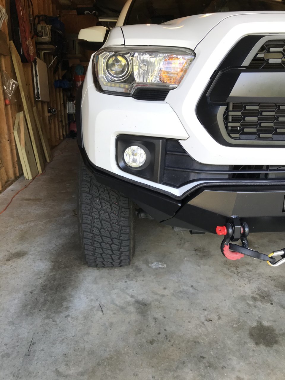

    Has anyone put this stage two bumper on an SR? I don't have fender flares so I am wondering if the wings will stick out.

    FYI, this is my or without the fender flares still not reinstalled...

    calebc Well-Known Member
    Oct 21, 2019
    #308578
    1,056
    Was this an Armagedon kit or a prebuilt Stage 2 kit? Either way, it looks like that passenger side is wrong, either it shifted in the jig (if it's an actual stage 2) or whoever welded the Armagedon kit didn't fit it properly.
  10. Aug 14, 2020 at 10:25 AM
    #950
    TRDridgerunner
    TRDridgerunner Well-Known Member
    Jul 17, 2018
    #259695
    352
    Steven
    GA
    18 TRD OR
    This is a pre-built stage two. I’m currently experimenting with thick washers as spacers in-between the wing and slimline. I’ve managed to get the gap down to about half an inch but it still seems excessive compared to the gaps seen in other posts.

    TRDridgerunner
    Jul 17, 2018
    #259695
    352
    Steven
    GA
    18 TRD OR
    After more cutting and use of several different washer thicknesses to shim the wing to the slimline I managed to close the gap significantly. Took 8 different washers but here’s how she sits now. 6FC5C534-4688-42B2-AB72-5E90B565253C.jpgDriver:56341B5A-942F-43E8-9AE6-3C3D17309CBD.jpg

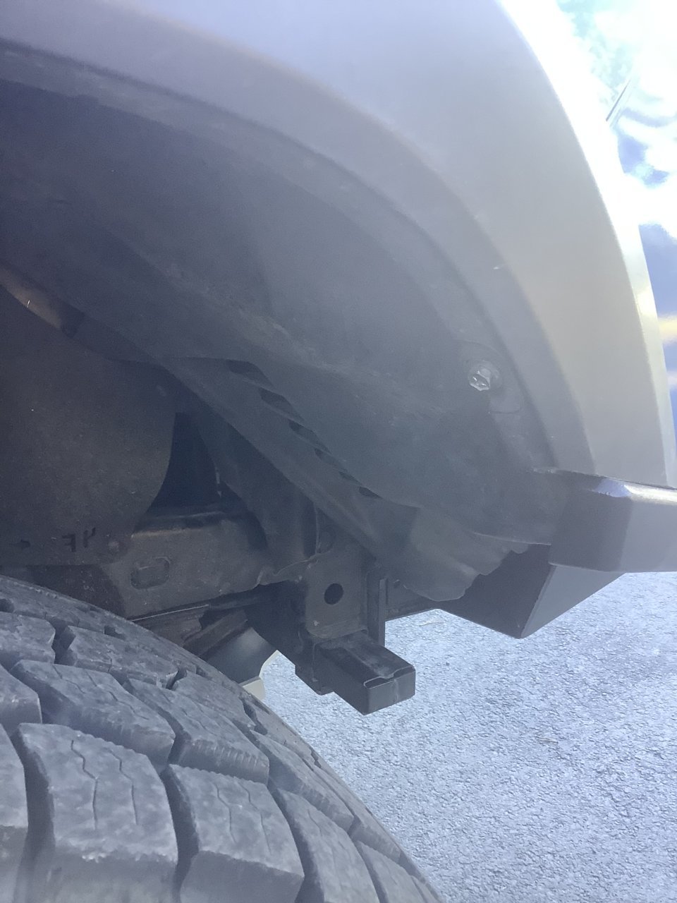

    GladiatorNOT
    GladiatorNOT Well-Known Member
    Mar 19, 2019
    #287171
    631
    2017 TRD OR
    Old Man BP51 coilovers Dakar HD leaf springs Icon Delta control arms TRD Pro rims with Kenda Klever RT 33x10.5 tires Exhaust mod TRD front skid, RCI tranny and transfer case skids Southern Style Slimline front bumper Baja Designs S8 bumper light Warn Zeon Platinum 10s winch 4.88 Nitro gears ARB front locking differential ARB twin air compressor X2 Power 27 battery RCI rear bumper with Rigid SRQ lights RCI rock sliders RLD canopy Dometic CFX3 55 refrigerator TRD Pro grill Front & Rear anytime camera Seat Jackers Diode Dynamics Pro fogs

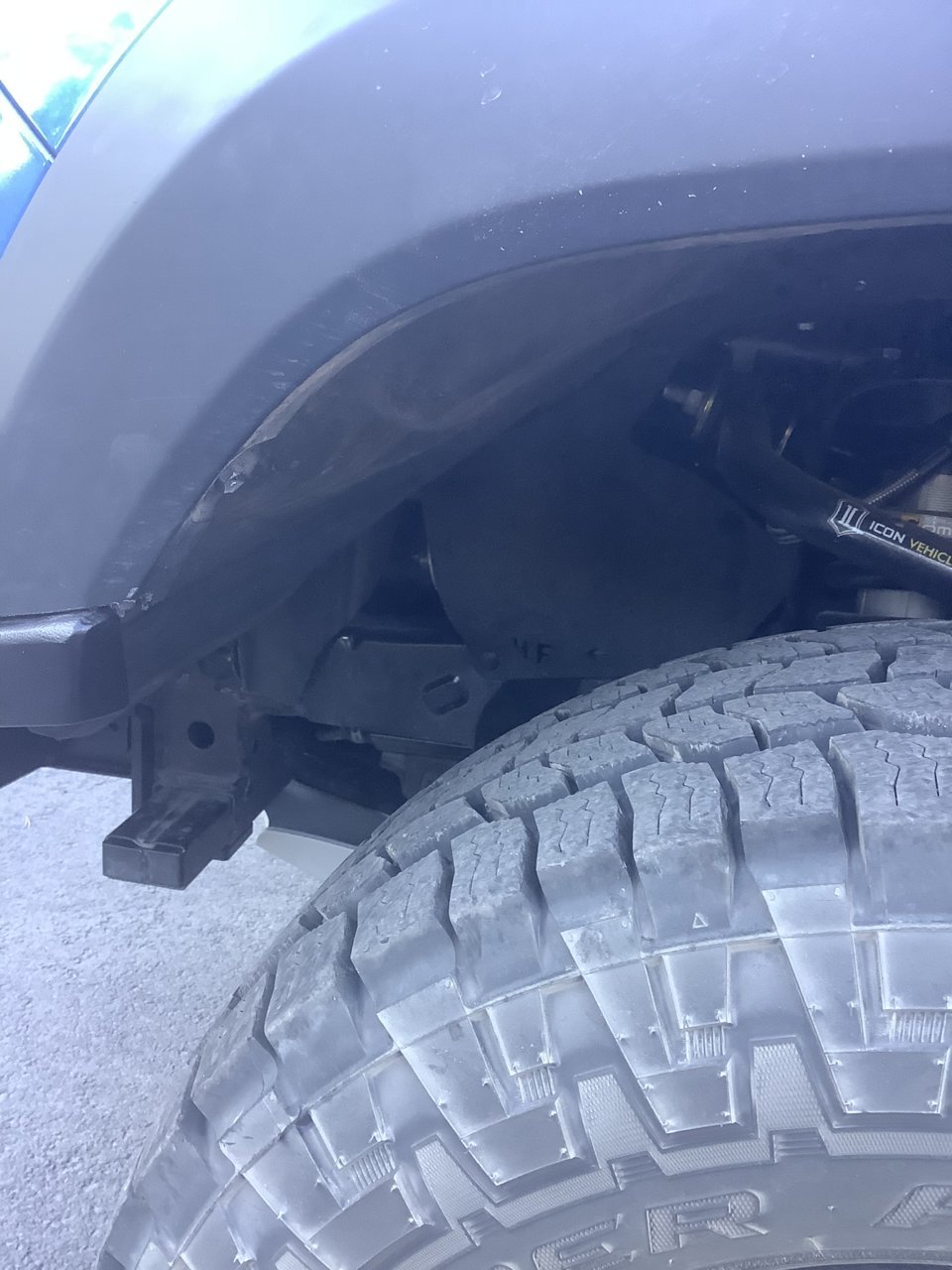

    No reason to cut off the fender liners and expose your fogs, wiring, etc. Just take a heat gun and reshape them. Looks factory and everything is still protected.5C84F806-6659-4DA4-BEDB-CBEBD6268DDD.jpg8570DDF3-56D1-4762-9663-103908C1D972.jpg
