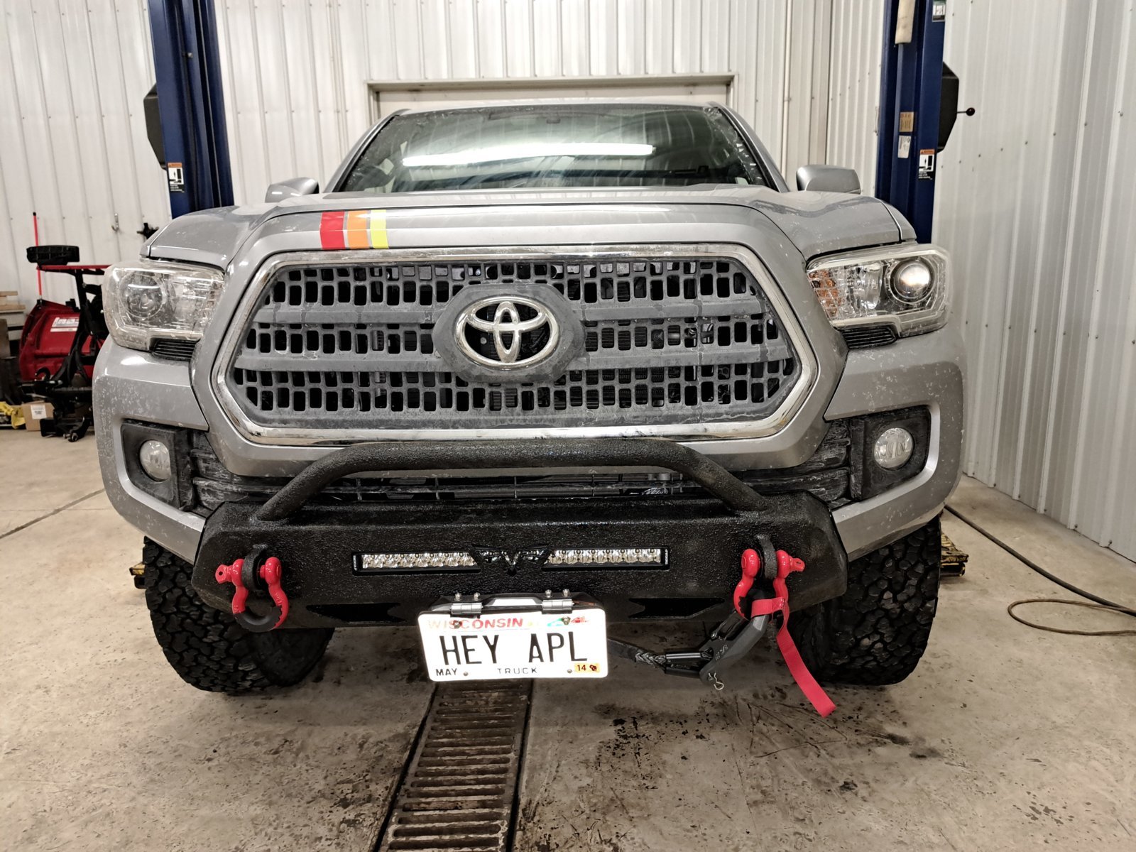

    Harbor Freight Badland Apex 12k. You can't beat the price. They go on sale at least quarterly, I think they were on sale over the 4th. Maybe again Labor Day?

    Do you run this on your rig??

    Yup! Works like a champ. The wireless (included) control is a really nice feature. gets you away from the winch in case shit goes wrong.
    edit: It uses the same bolt pattern as Warn and the control box is setup to remotely mount.

    You can barely see the control box to the left of the Toyota logo and under the stripes. I made my own mount with some 1"x.125" steel bar stock I had laying around, but you can get it at Home Depot/Lowes/any good hardware store. Mine bolts into some existing holes in the radiator support, I may have had to drill 1 or 2 holes, I don't remember now. All simple stuff.

    Different bumper but easy to access the gear release from either above or below. It's in approx. the same place as a Warn.
