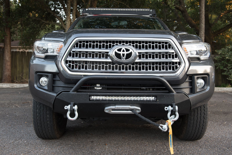

    I'm trying to compare these two three bumpers:
    SSO Slimline:
    http://www.southernstyleoffroad.com/product/2016-tacoma-slimline-hybrid-bumper/?v=7516fd43adaa
    C4 Lo-Pro:
    http://www.c4fabrication.com/product/2016-tacoma-3rd-gen-front-lo-pro-winch-bumper/
    Stingray Lo-Pro
    http://www.relentlessfabrication.co...ngray-lo-pro-winch-bumper?variant=31698457796
    I think they are fantastic, but when presented with a choice between them I'm trying to figure out pro's and con's.
    So far, from this thread I have gathered:
    Cuts to the truck: All three - Bumper only, no metal.
    Winch limitations: All three - No fixed solenoid (without mod).
    Weights:
    SSO Slimline - 55 lbs
    C4 Lo-Pro - 75 lbs
    Stingray - 75 lbs
    +Winch will be around 150-170 lbs total. @JoeCOVA reported about .5" drop from tire to fender after install. Not enough to be concerning.
    Light Bar Support:
    SSO Slimline - Up to 30" (customizable)
    C4 Lo-Pro - 20" or 30"
    Stingray - (20")
    Other Notes:
    C4 Lo-Pro - Additional bumper support brackets option (may work on other bumpers, unconfirmed).
    Stingray and C4 Lo-Pro - Front holes to access the winch controls. C4 is able to exclude these upon request, but Relentless Fab is unable to.
    C4 Lo-Pro - Can't provide powder coat or other finishes from the shop. Ships bare metal.
    SSO - Can provide custom color powder coating.

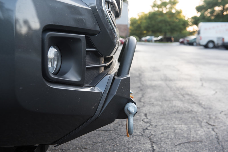

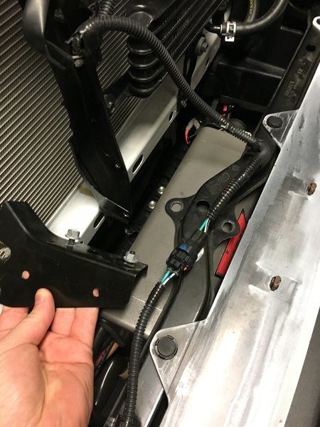

    They are pretty much the same. I think the only real advantage the C4 has is the winch access through the bumper. SSO you have to access it by opening the hood or reaching around under the bumper. I rarely winch so I don't mind the extra hassle though if you have a newer remote winch this is also not an issue.
    The bumpers wont allow the installation of a fixed solenoid winch without additional modification. There is only about 8" of room from the winch mounting plate to the support bracket in the middle. My winch is 9.5" tall and the Warn PLatnium 10-s or whatever is 10.5" about. for both bumpers you will likely need to drill out this support bracket. It was really easy, 3 holes and a light tap with a hammer and screw driver pop it off.
    https://www.tacomaworld.com/threads/2017-pro-plus-sso-bumper.466399/ Post#11
    You can see here that the front crossmember sits right on top of the winch, the bracket I am holding screws into the bottom of that crossmember and is welded into the vertical support next to the radiator. You can see where I drilled.
    I think it comes down to aesthetics. I think the SSO looks more factory and follows the factory lines better.

    Great pic Joe.

    Yikes, thanks for the info. I'm not sure how I feel about removing the support bracket. I'm sure it... supports... something? :notsure:
    I do prefer to have something mounted a bit more firmly to the frame than the grill guards are. But I'm not sure I want to go cutting out more than just plastic.
    Good to know there are options to avoid that. I like the slimline's edges too, looks clean. :thumbsup:

    I wouldn't worry about that metal. It's designed to support the front bumper. Your winch now serves as that, way stronger than that cheap stamped steel...

    It appears to just support that front crossmember/bumper which is now supported by my winch.

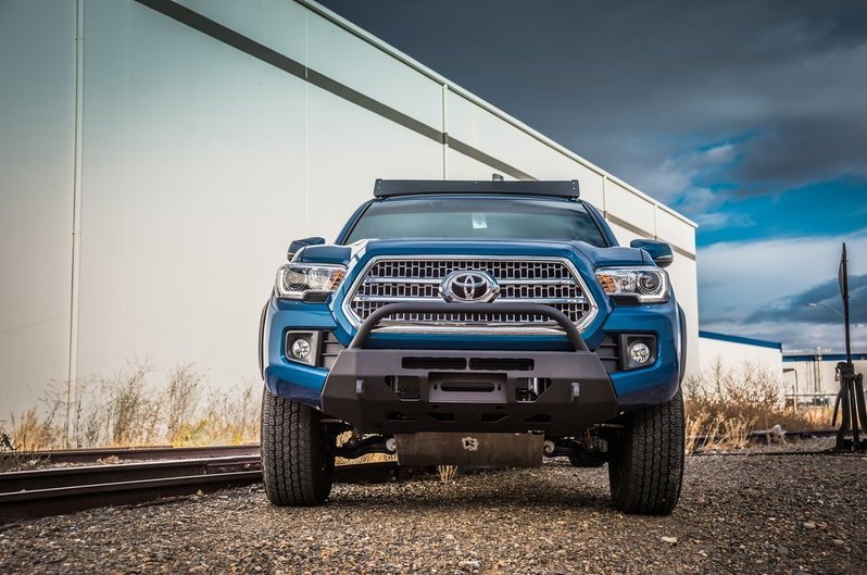

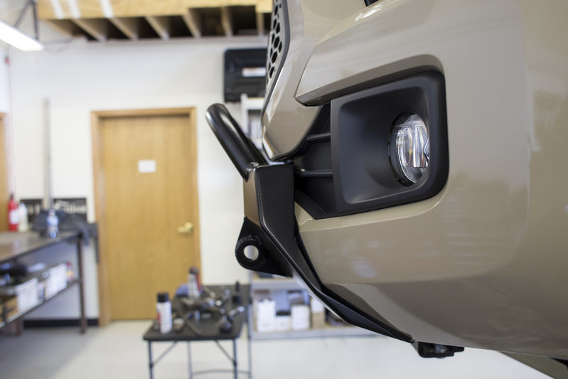

    As described above by @JoeCOVA, that grille support will also need to be modified to fit an integrated solenoid winch into our bumper as well.
    @Kennedyusmc mentioned that ours possibly offers less ground clearance than the SSO version, I would have to disagree. Both bumpers follow the shape of the plastic and don't hang down any farther than the factory plastic so I would imagine the clearance to be the same.
    Really the main differences are aesthetics and the fact that ours has cutouts in the front to access the winch controls and winch line if you need to.
    Also we are coming up with a universal light bar mount that will allow use of basically any brand of light so that will be a nice feature. Also our bumper will accommodate up to a 30" light, not sure how big the SSO goes.
