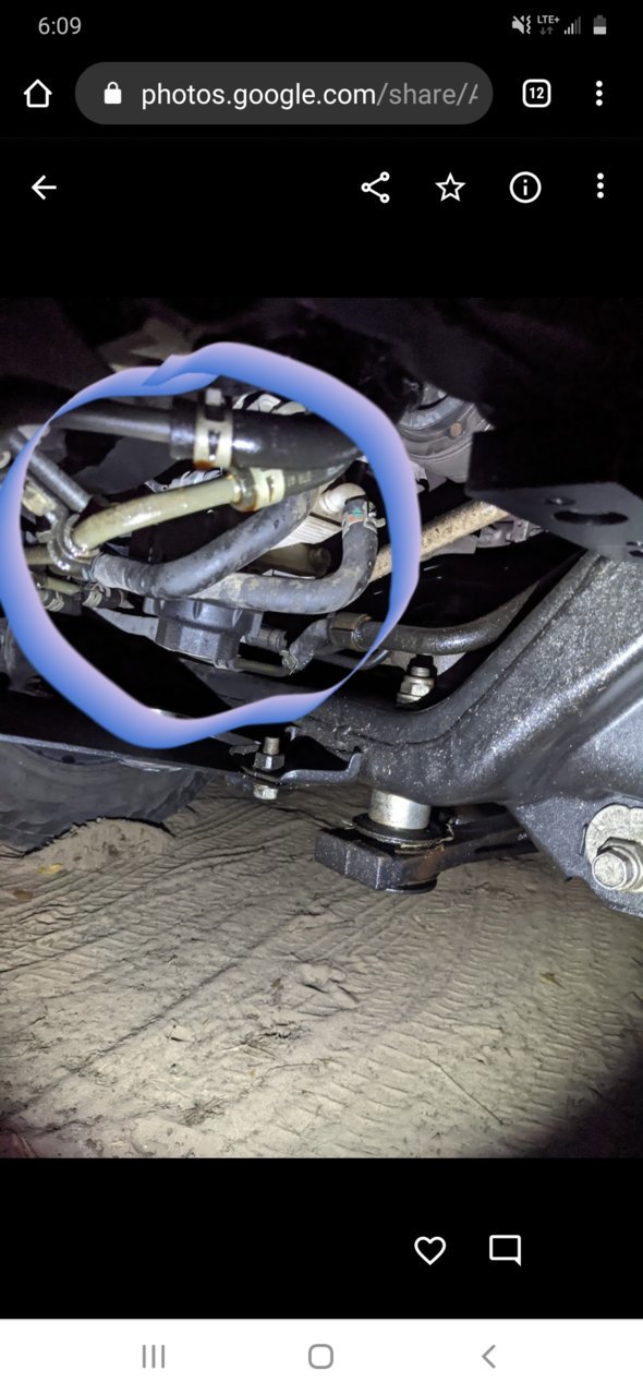

    https://photos.app.goo.gl/FqvwK6j1AETZo3F99
    Sorry for the quality. It's dark out and I don't have a lift so the pictures are a little close. I'm wondering if it's my steering rack or my 4wheel drive. When I switch to 4 wheel and turn the wheel I hear a "thud".

    Could be the transfer case or the rack...
    The pic with the power steering lines is all wet with fluid.20201014_181004.jpg

    Yeah just followed that line. I added a new picture to the file. There's a tear up top in it. But it goes to my radiator still have a good amount of power steering fluid

    That tear is going to be your problem most likely and the pop was the hose blowing. Maybe a blockage caused it to blow out. You'll get a better look tomorrow in the light.
