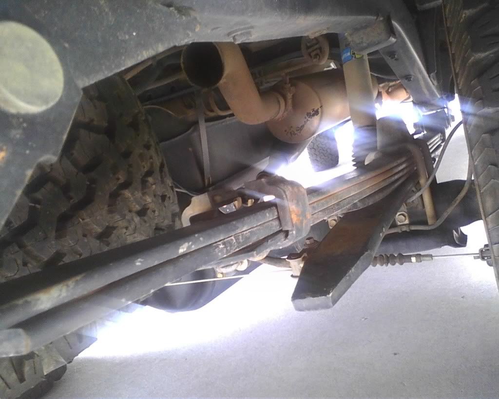

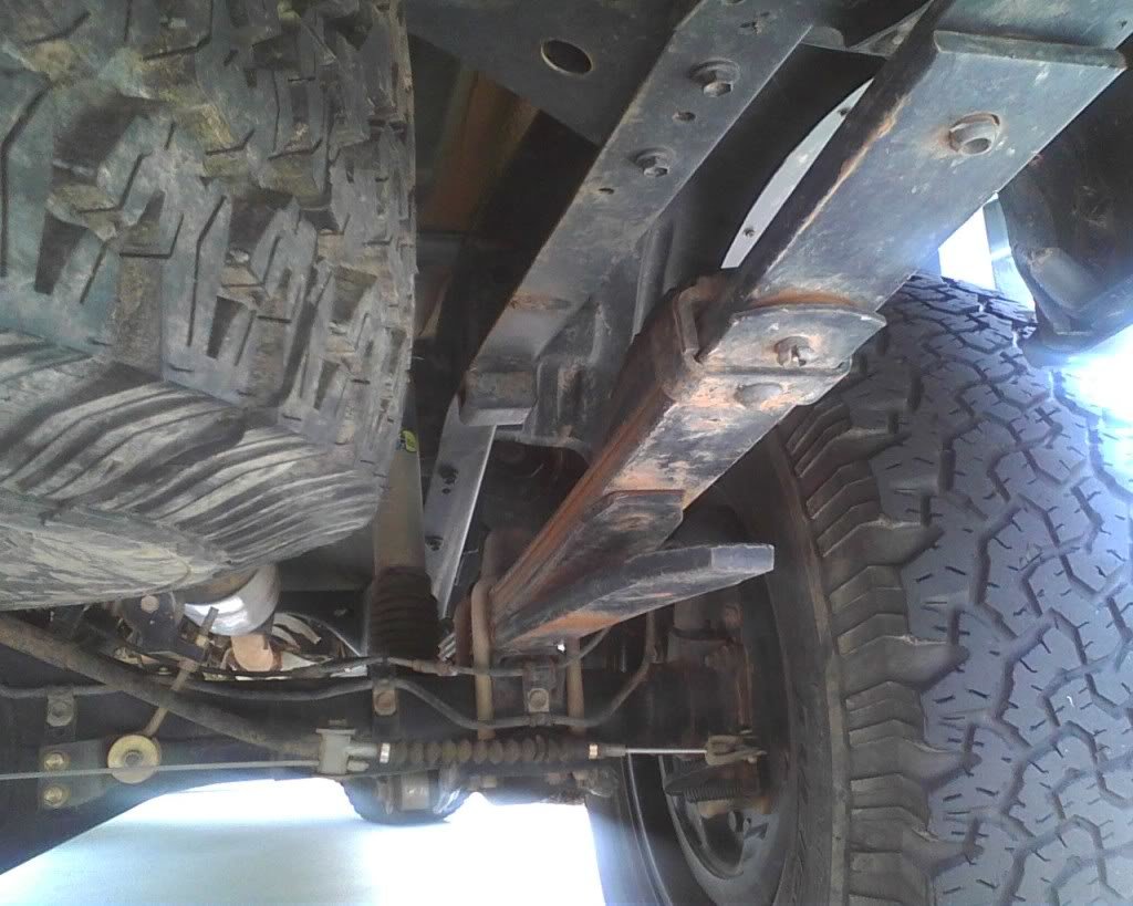

    this picture shows the sag in the rear a good bit.

    hey yall, im seriously considering putting the shackles on this weekend but i dont want to over bend the leaf springs. iv heard they flatten out. and if they are old enough (125,000miles) they might get a negative arch.
    does anyone have any input if the shackles will cause a neg. arch?
    i just dont wanna waste a weekend putting shackles on and then taking them off....
    if you didnt catch it earlier. i have toytec AAL on there now. and its almost 2 years old

    Your truck is not sagging because the aal is worn out, your truck is sagging because the leafs are wearing out. The shackle will only prolong (and probably not very much) the inevitable conclusion of new leafs. You are correct about them being able to straighten out with the longer shackles as well. The shackles allow the leaf to extend further and get flatter when you go over bumps. I'd start looking at new leafs which ever route you go as you will need them soon.
