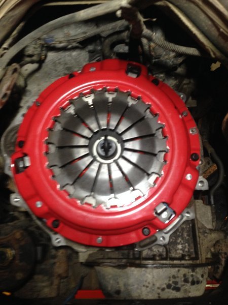

    I had the first mechanical failure in my '06 TRD Sport! The clutch disc separated from the center section! 189,890 miles!
    Ordered the URD stage 3 clutch kit! 40lb flywheel and TOB upgrade/repair!
    2 day delivery, awesome quality, great pedal feel, and awesome holding!
    Excellent experience...as usual!

    How it drive? I went with the same flywheel and tob upgrade but the stage 2 clutch.

    It drives awesome! Pedal feel is "factory"! Haven't slipped or smoked it yet! I'll be pulling my camper in a couple weeks and add to the post at that time!
