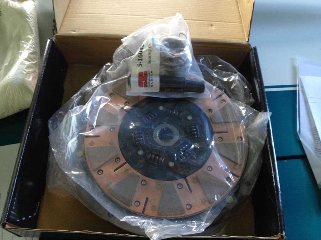

    Stock clutch started slipping at 9,000 miles. Replaced with a Stage 3 Competition Clutch from URD.
    Pedal is quite a bit stiffer than stock and the clutch grabs hard. Harder to drive. Takes some time to get used to. Some clutch chatter is normal until the clutch is broken in.
    Some installation notes: "The segmented bronze ceramic material used on the flywheel side gives the clutch its incredible torque holding capability, while the carbon/Kevlar material on the pressure plate side provides the stock like smooth engagement."
    Throwout bearing and alignment tool are included.
    Bottom line: The stock 1GR clutches are junk so if you have a blower or drive your truck hard it's only a matter of time until...

    After about a 300 mile break in the clutch drives pretty well. Chatter is virtual gone. Grabs solid. Once you get used to the stiffer pedal and how it grabs harder pulling out it's not that bad to drive every day. If you have a supercharged truck your stock clutch is on borrowed time so you'll have to bite the bullet eventually. URD makes their own clutch kits with a beefy hub/disc and pressure plate assembly. I would have gone with that but they were out of stock. They have a Stage 2, 3, 3+, and dual disc option capable of 1000 ft-lbs.
