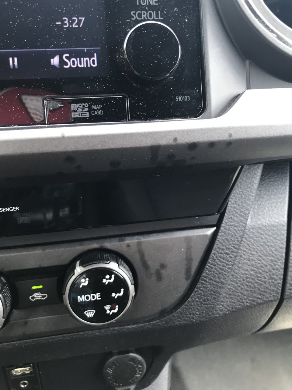

    C7C0E4AF-D0D7-4671-AECB-17F02D6DE34A.jpg Does anyone have any experience or suggestions on removing the stained spots on my interior trim? They were there when I purchased the truck used so I’m not sure what caused it. Any recommendations are appreciated thanks.

    Usually hand lotions, sunscreen, and other certain chemicals will destroy the trim in these Toyota’s. Would suggest replacing the trim piece.
    I’ll come back with a part number
    Edit: obviously try cleaning it first

    Toothbrush, hot water with DAWN. If that doesn't clean it remove the piece. Clean it good. Hit it with a scuff pad. Several light coats of Argent silver spray can.

    Look oil based to me. Baking soda poultice.
    Edit, also, try a product called Dawn Power Dissolver.
