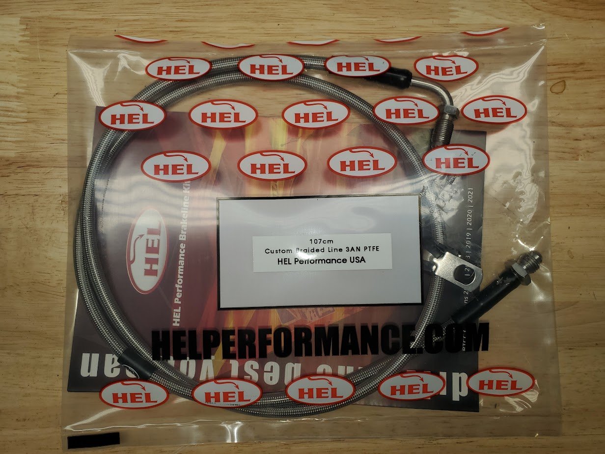

    Anyone aware of a braided stainless clutch soft line for the 6 speed? I see them for the 2.7 and first gens but none for the 4.0. There’s a technafit line that claims to only fit 05-07 6 speeds but I can’t find it in stock anywhere and I’m not sure if it will fit a 13. Has anyone had one of these custom made?

    I had a custom SS clutch line built by HEL Performance when I did my 6-speed swap. I wanted a line that was metric (10mm x 1.0) on one side for the Toyota master cylinder and SAE on the other side since I was using a Tilton HRB. I almost gave up trying to find a company to make me a custom line with those fittings until I found HEL. Their sales rep was helpful, knowledgeable and the turn around was comically fast, all cheaper than factory Toyota parts. They've got a line builder tool on one of their websites but I found it easier just to call and chat with their person 321-804-1101

    Thanks, I already did the accumulator delete and I’m just trying to get a little more feel at the bite point so I’ll give them a call and have them make me one
