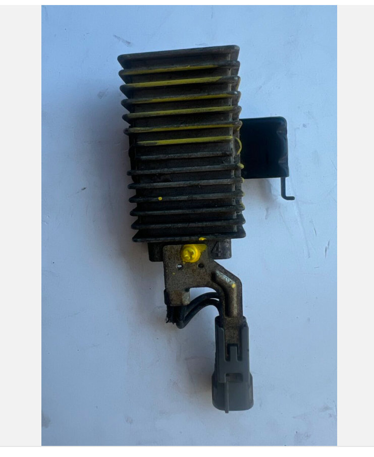

    The fuel pump uses a resistor to operate low speed. When the truck first starts, it operates on high speed for about 3 seconds. Then defaults back to low through the resistor. The resistor is operated by the relay.
    Is the resistor or the relay your issue?
    I don’t know. Maybe. Or it may be neither one.
    I’m just posting how the system works.

    Where is the resistor located on a 2009 Tacoma?
  6. Dec 26, 2024 at 8:52 AM
    TnShooter
    TnShooter The TacomaWorld Stray
    Sep 2, 2010
    #42625
    21,337
    Deogee
    07' TRD Off-Road, Auto
    STOCK
    Down in front of the battery.
    Looks like this.
