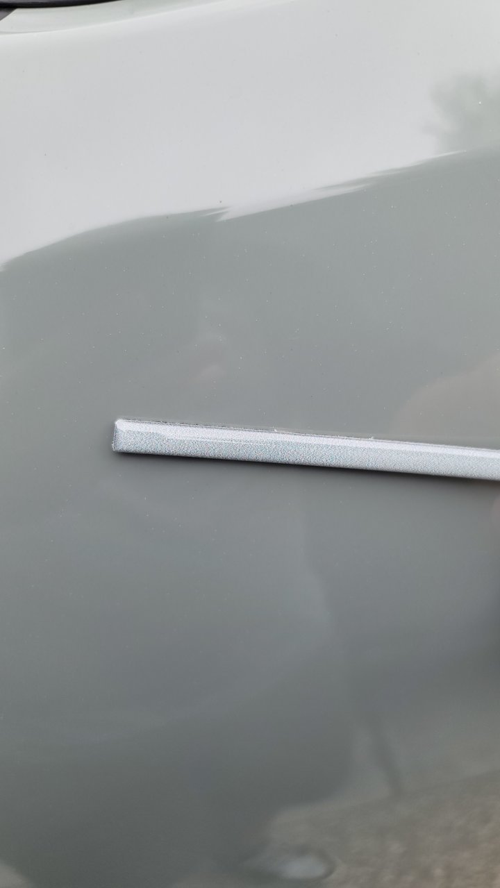

    I wanted to lighten up the interior a bit and saw these trim pieces for sale from Tufskinz. For 20 bucks, I'd give it a shot. I ordered the lunar rock color and the color doesn't look all that correct to me, but not a big deal. The fit and look is great. Subtle, which is what I wanted.

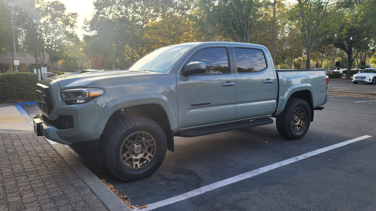

    Hi, thanks! The truck has been a fun project for sure. I think the tires are fantastic for me, which is 99% on road. I never had the LTX AT2s, but I did have a set of Defenders (LTX MS2) on 2 different trucks and the Trail terrains ride just as good as the defenders! They've been quiet, shimmy free and road feel is excellent. I can't wait until snow season starts so I can see how they perform there.

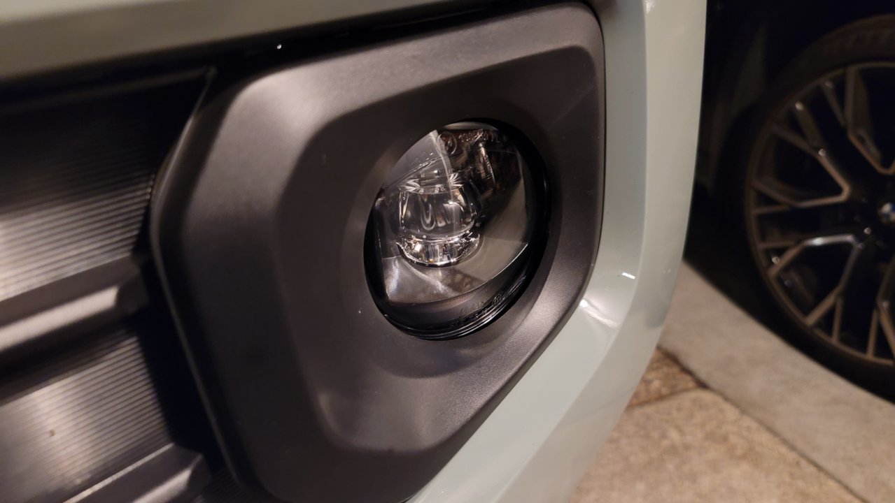

    1. The Amazon LED fog lights were good, but they had to go. The beam was just a little too wide and scattered for me. I could adjust them lower, but they didn't have the nice sharp cutoff I saw on 'good' fog lights. After going through all my options, I decided the OEM LED fogs were the best bang for the buck. They were inexpensive ~ $120, and the beam is perfectly cast with a sharp cut off to not blind drivers. I do the fog install from top of the engine bay after removing the grill, I found it's the easiest and fastest way.

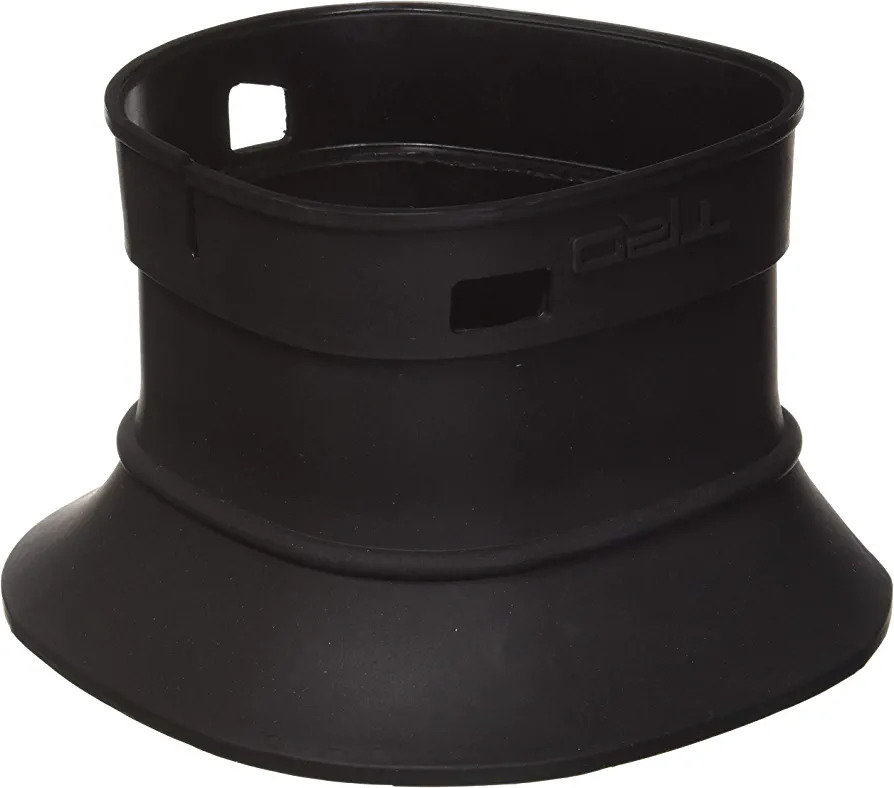

    2. This is something I wanted on my first 3rd gen, but didn't get to install. The TRD air filter - it looks like a re-branded K&N which is fine for me. In contrary to other folks, I noticed not a single difference over the stock paper filter. No noise, no 'quicker throttle' - nothing. I think a lot of folks get that placebo affect when they install something that costs $$. Personally for me, I bought it for the convenience of re-using the same filter.

    Installed the intake flow accelerator today. Good time to check the air filter (was clean as the day I installed it)
    The accelerator does nothing. Absolutely nothing btw.

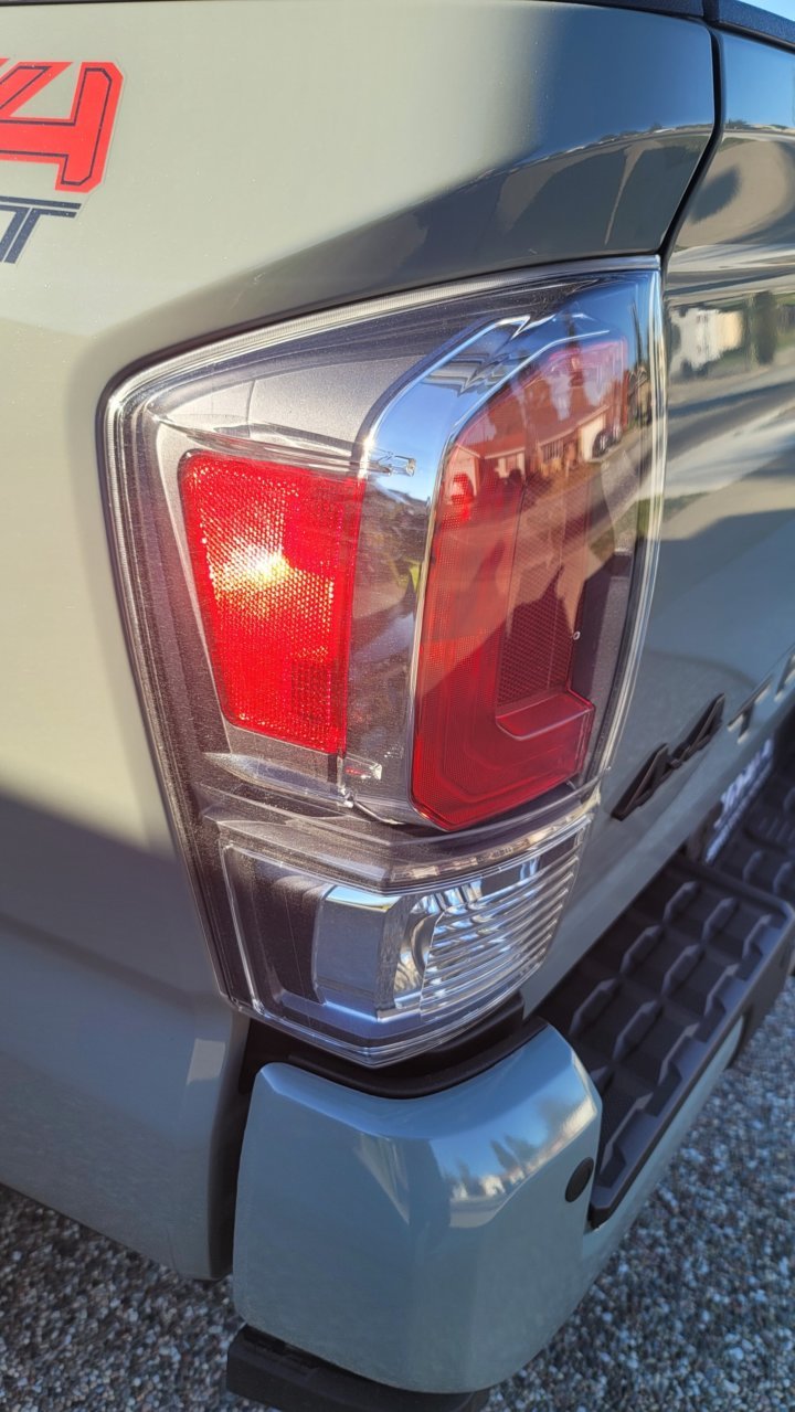

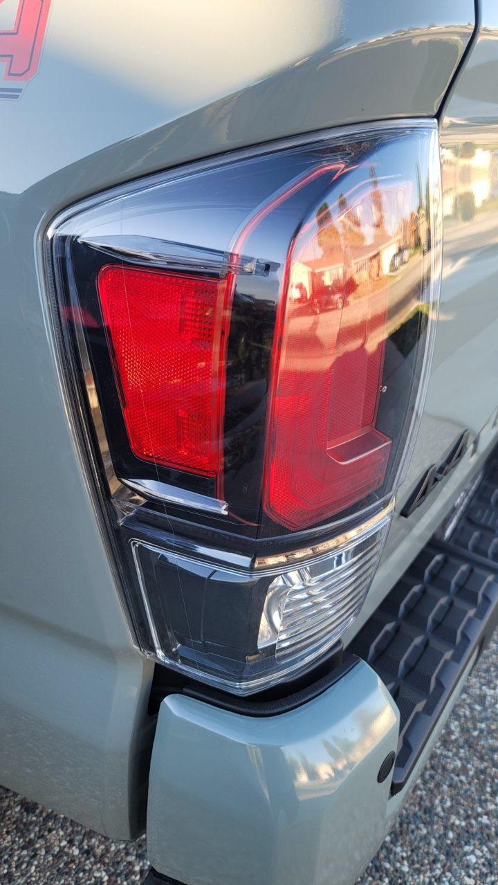

    I like the current tail light design, but hated the chrome strip on it. It clashes with Lunar Rock IMO. I decided to get the 2020+ TRD Pro tail lights. Shipping from Toyota was quick since it really came from about 30-miles away.
    Before/After

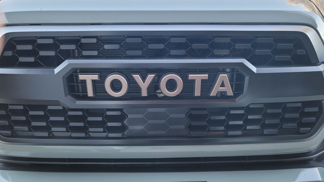

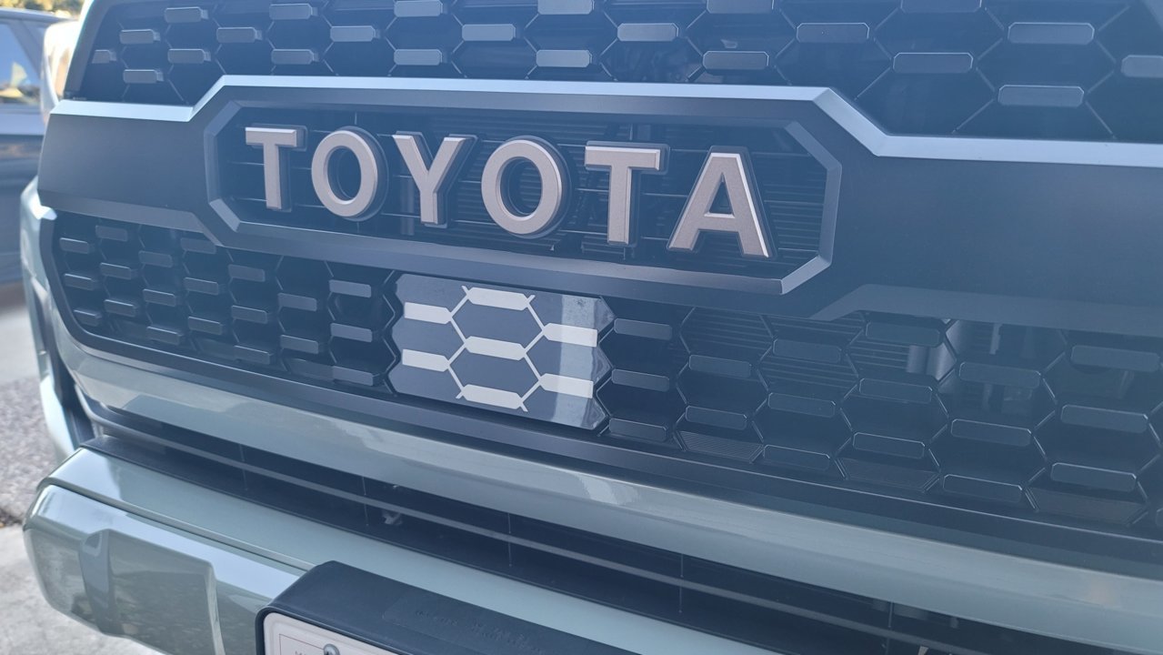

    Having purchased an OEM grill, I was always kind of bothered by the non-OEM garnish for TSS. It kind of stuck out like a sore thumb and colors were off.
    A member here was selling an OEM one , so I bought it and installed it. Much better looking!
    Before :
    After :

    This is the situation I am in too...I want an OEM garnish as well, even much more now that I see the difference in your pics!

    I paid $150 for a used one, which functions exactly like the one I took off, but it looks so much better!

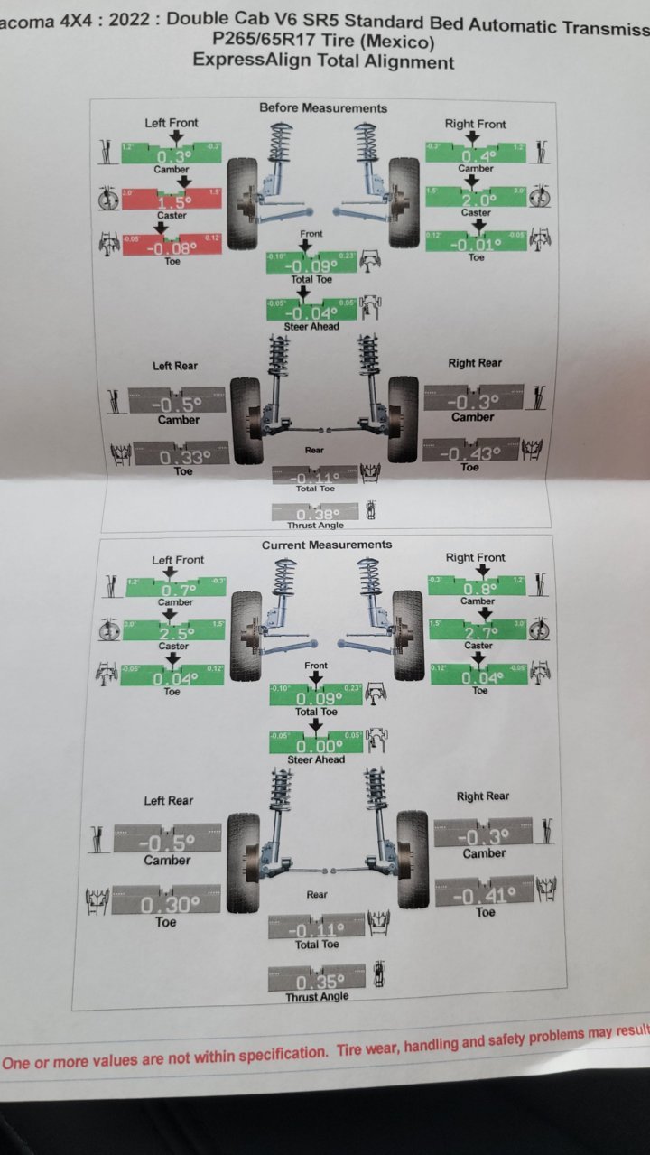

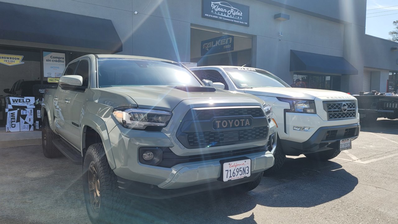

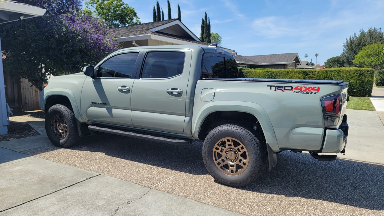

    Having had my suspension on for the last 8K miles, and everything has been perfect. I decided to get a maintenance alignment to see if I can get more positive caster, and make sure everything was OK. I've driven the truck over some rough terrain over the last season. I made an appointment at my fave 4x4 shop here in the SF Bay Area (Klean Ridez) and they were able to get me +2.5 of caster. The truck immediately felt more stable on the highway and the steering feel too. Very nice.
    While there, I told them I was debating on getting a 1/2" block in the rear to give my truck a slight rake again. My front has been lifted 1" on Fox 2.0 and leveled out. Turns out he had some TRD Pro 1/2" blocks take offs and I had them throw in on for me for a very reasonable price.
    Now with the 1/2" rear blocks installed!
  12. Apr 29, 2023 at 6:58 PM
    #32
    stan23
    stan23 [OP] Well-Known Member
    Jun 20, 2014
    #132351
    2,449
    stan
    Santa Clara, CA
    2025 DCSB TRD Sport 4x4

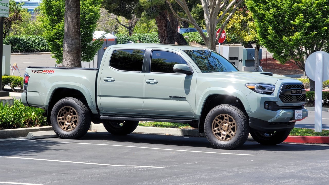

    Here is a better picture of the Fox 2.0 suspension with 1" lift on the front and 1/2" TRD Pro block installed on the rear.

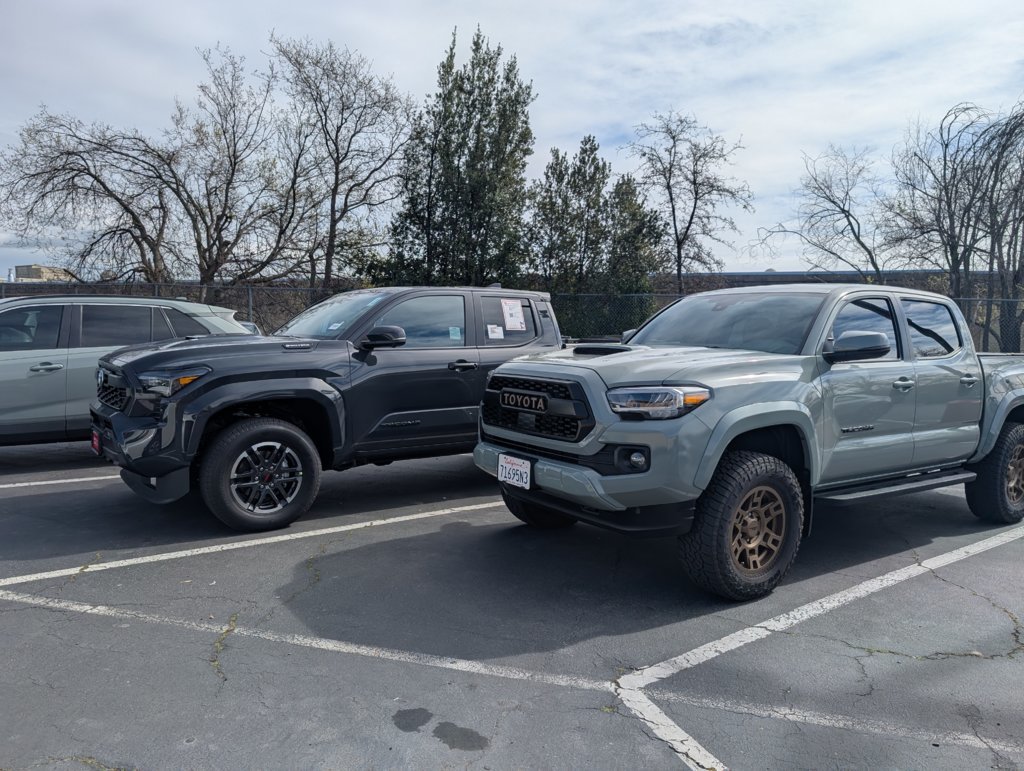

    Well, bittersweet day. The 2022 Lunar Rock Tacoma has been traded in and I now have a 2025 Underground Sport Hybrid.
    I loved both of my 3rd gens, but wanted to try something new, and the 4th gen was just the ticket. I considered the Ranger Raptor, but price was a bit higher and the moonroof was not available which is a big thing for me.
