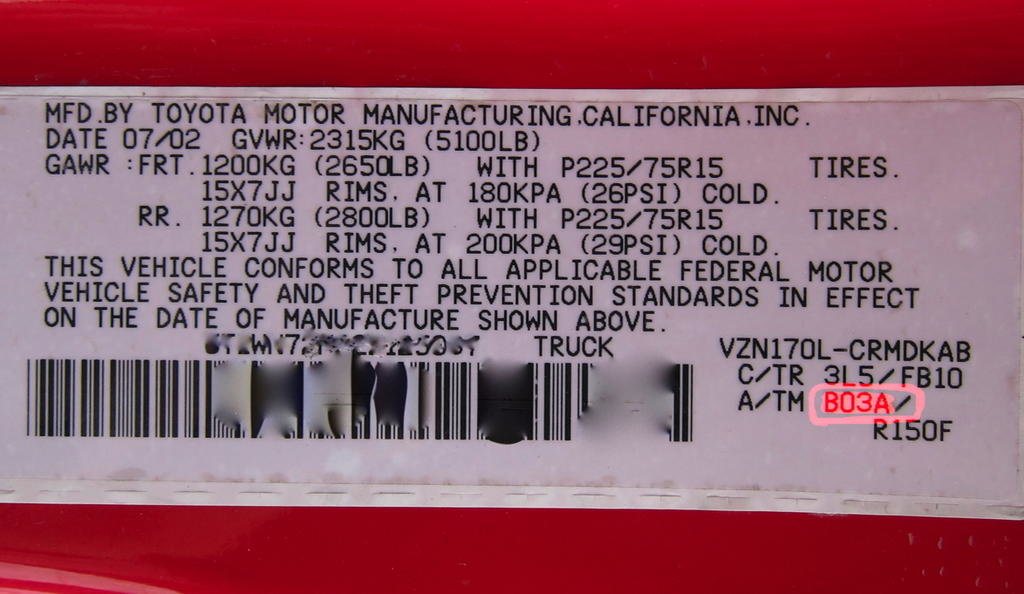

    look on the VIN sticker on the door jamb. the code will tell you which gearing you have. here is an example:

    Mine is the same as yours B03A.
    • B = 8" ring gear
    • 03 = 4:10
    • A = 2 Pinion, Open
    So, is this the problem with my up hill acceleration?

    honestly it shouldn't be. that's standard for most of our trucks. BUT if you were used to the smaller tires then you would notice differences, I'll bet the previous owner put the smaller tires on thinking it would save mpg or make it easier. for 4.10 ratio the 31" tire is pretty standard across the board for most brands/models of trucks nowadays.
    you may need stronger springs later on to deal with the added weight, or at least an AAL. moving up to the Tundra brakes will help stopping the added weight as well. but those are future plans ;)
