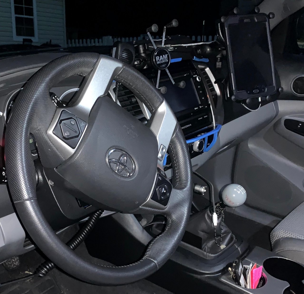

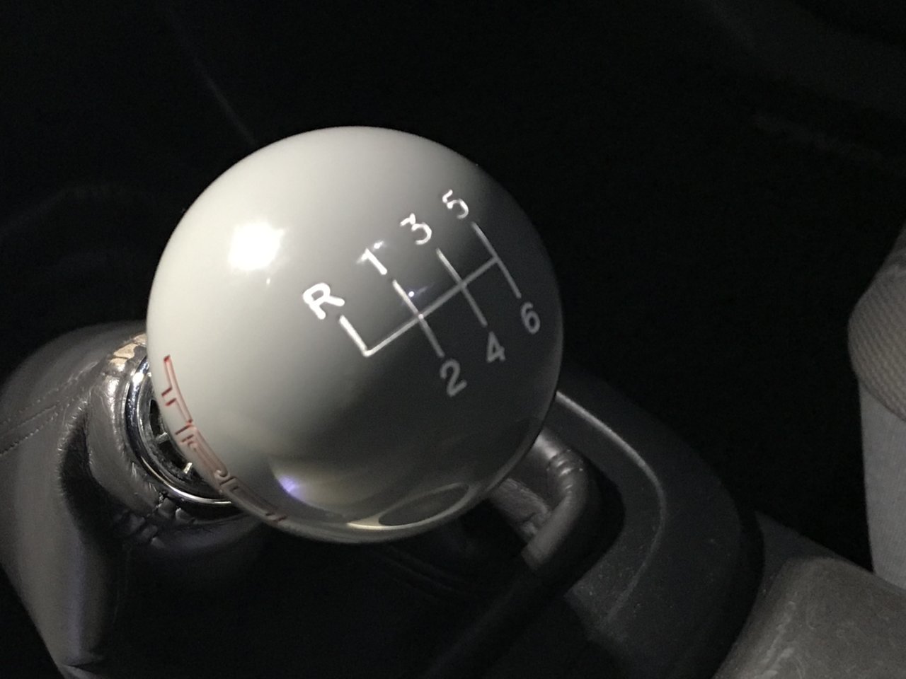

    Buy a TRD Quickshift kit and replace that old stick! I just did mine and I LOVE it. Here is the install video I made:

    I had the same problem when I did my trans swap. The shifter was broken. I changed to the TRD quick shifter and it came with a full new shifter assembly. All is good now.

    And don’t forget to buy this as well. It is amazing.

    That loose connection you are referring about, is the inner stock rubber isolator is worn out. the upper shifter tube is filled with a rubber compound and the bottom part it is put into place before the compound sets. exactly how Toyota does it, I don't know - but you get the gist. it is done for noise and vibration reduction coming from the transmission. This is a good idea in theory, horrible for long term practical use.

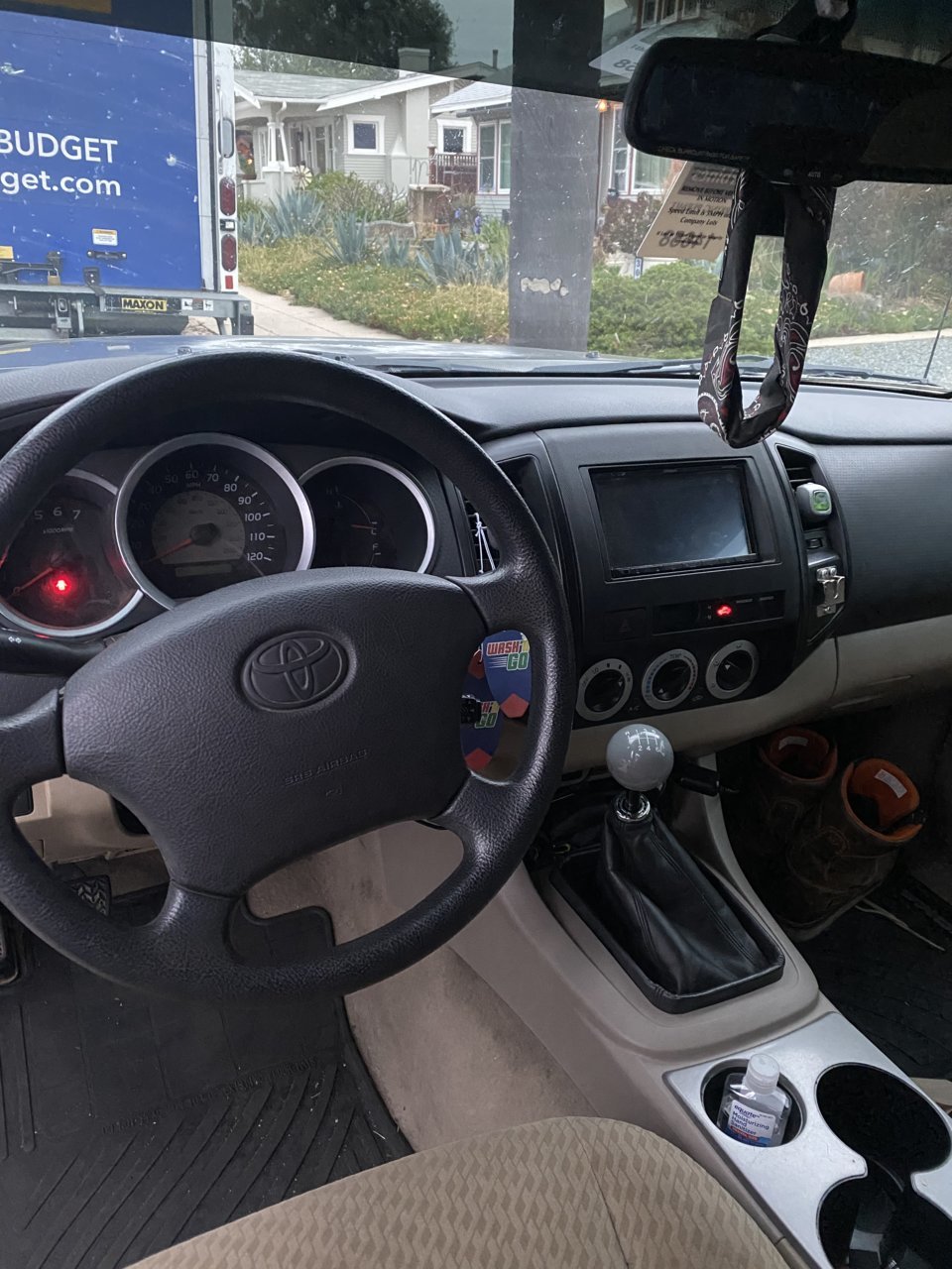

    I love the bottle of hand sanitizer. That’s where I put mine as well. COVID. Ugh.

    Guys, Thank you for the feedback. I will do the TRD quick shifter. RedTaco68, thank you for the video. Just what I needed. And agreed about the TRD HSBH "Hand Sanitizer Bottle Holder". Incredible foresight on the part of the TRD design team. Cheers.
