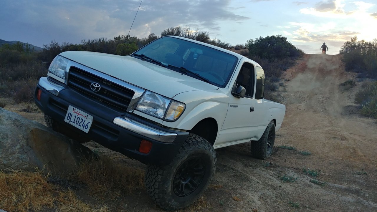

    What are all your thoughts? I'm going for a mid travel setup up front and eventually plan for an under-bed shock relocate in the rear and some newer leafs to get the most flex out of it. If anyone has recommendations for rear setups I would love to hear about those options as well.
    Here's a pic of the truck for good measure:
