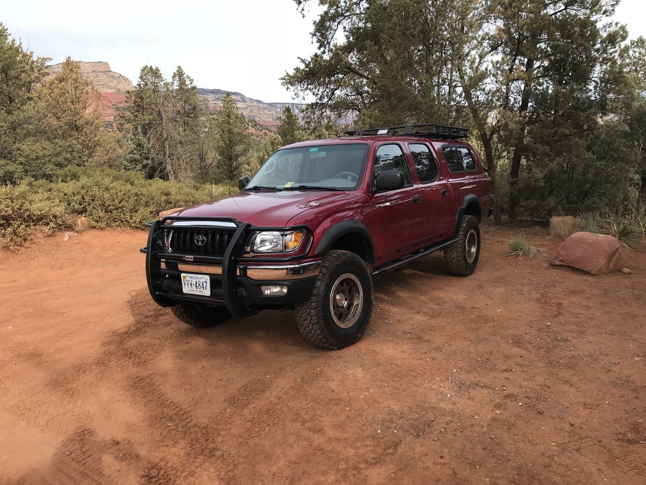

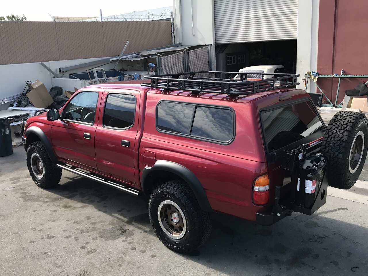

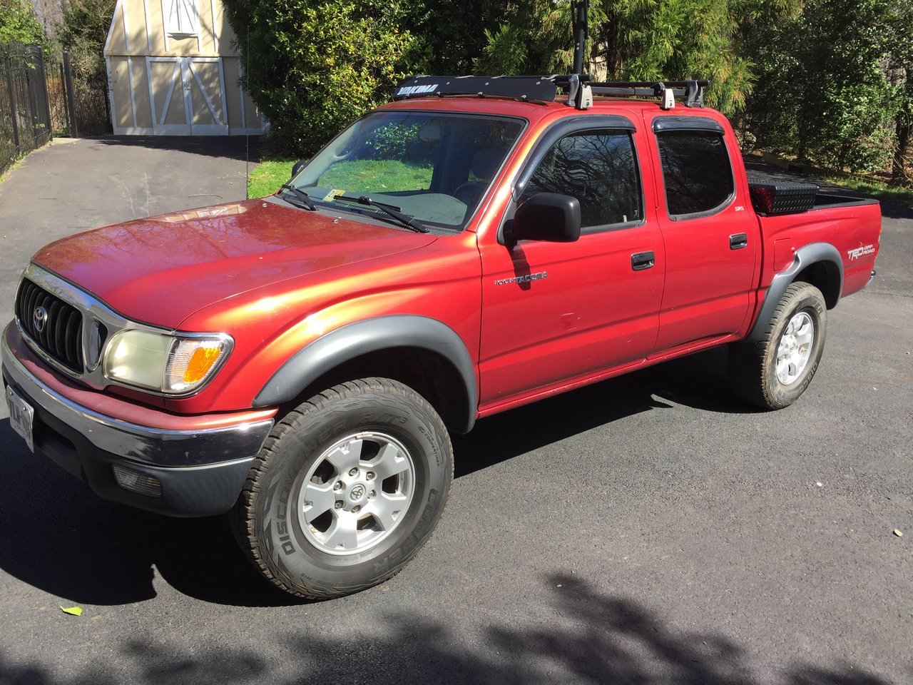

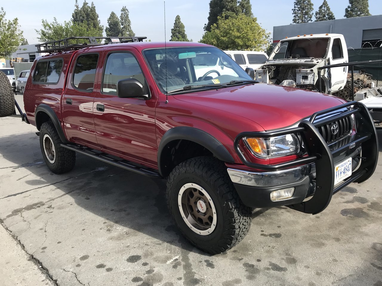

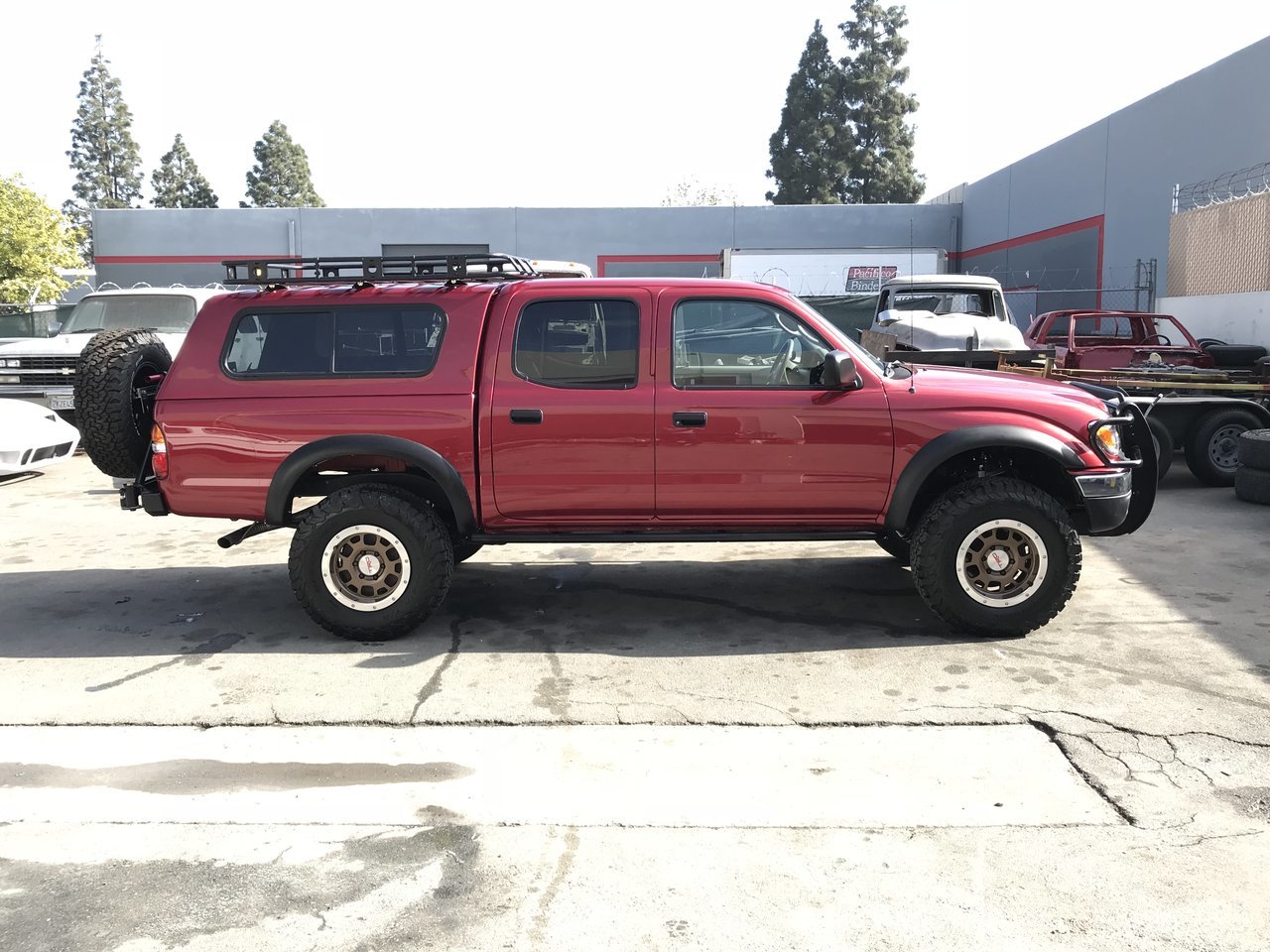

    Rusty as of January 7, 2018:
    How Rusty looked when purchased:

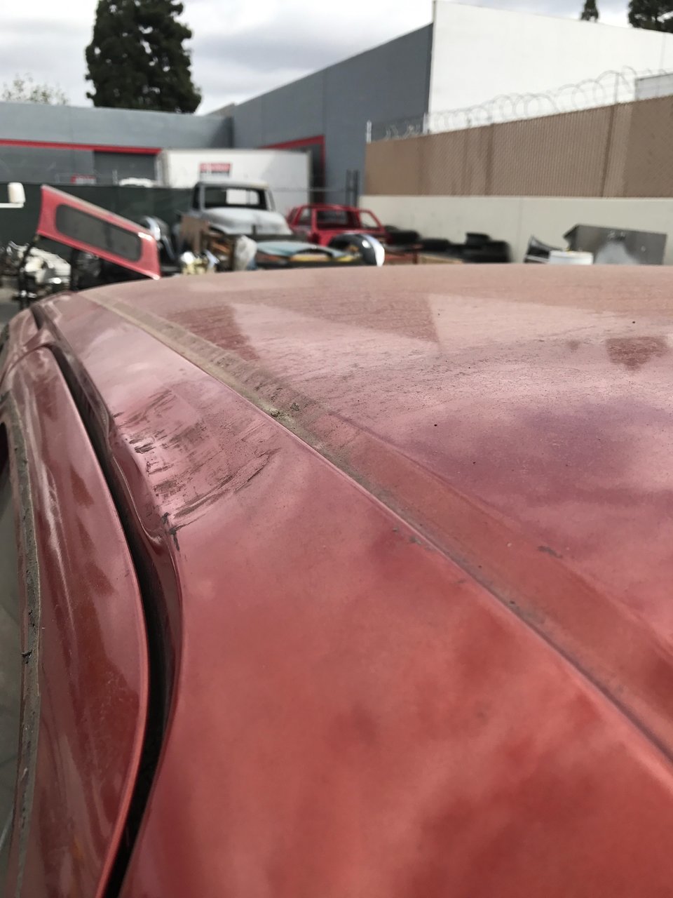

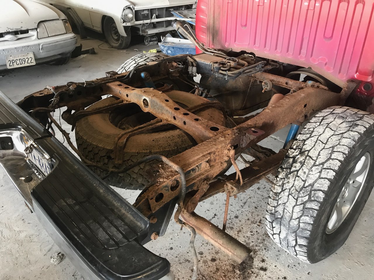

    Meet Rusty, the no longer rusty 2003 Double Cab Off Road. I bought Rusty in April of 2017 with 50K miles on the odo, had a clean Carfax and ran great. Rusty had some light scratches but no dents (that I could see - turns out there was some damage under the Yakima roof rack).
    The problem was the frame. The details are in this thread but the short version was, frame completely compromised and was never sealed by Toyota so not covered by the extended frame warranty. My brother has a shop in So Cal and I shipped the truck to him from my home in Virginia. For the next 4+ months I sent him parts and he did a full frame replacement and upgrades to most of the truck, turning it into effectively a new vehicle.
    Here's what's in Rusty right now:
    Base:
    - 2003 Tacoma Double Cab, Off Road
    - LX SR5 Package
    - 3.4L, Auto, Tow Package
    Suspension:
    - Front: Total Chaos Upper Control arm kit, Fox 2.0 Coilovers
    - Rear: Icon Vehicle Dynamics Add-a-Leaf kit, Icon Vehicle Dynamics rear shocks
    Armor/Recovery:
    - 4X Innovations Rear Plate Bumper / swing out tire + jerry can + Hi-Lift 48" jack
    - Low Range Off Road Gas Tank Skid
    - Skid Row front skid plate
    - Stubbs Welding HD-SKO Sliders
    - Westin 40-0905 Grill Guard
    Drivetrain/Wheels/Tires:
    - OEM rear E-locker
    - 16" TRD Beadlock Simulated Wheels
    - BFG KO2 Tires - 265/75/16
    Interior/Electronics:
    - Pioneer AVHX3800BHS 2-DIN Receiver
    - Polk Audio db651s Front Speakers
    - Pioneer TS-G1345R Rear Speakers
    - Proclip iPhone Mount
    - Backup camera
    - Refinish faded dashboard
    Exterior:
    - Innovation Camper Shell
    - Smittybilt 40505 Roof Rack on shell
    - Repaint Impulse Red Pearl(3P1) - 4 coats of clear, paint shell to match
    - Rhino Line bed
    - New headlights / turn indicators
    - New OEM grill / bumper
    - New windshield
    Rust Repair:
    - Frame from a CA based 2004 Tacoma DC OR
    - New Spindles
    - New drive shaft
    - Replace rusted rear diff (from donor frame truck)
    - New OEM brake dust covers
    - Replaced fuel tank
    - New OEM rotors
    - New brake lines
    Rust Prevention:
    - Frame has two coats of POR-15
    - Underside of cab / bed has two coats of POR-15
    - Frame rails have Eastwood Internal Frame Coating
    - Back of replacement OEM bumper has two coats of POR-15

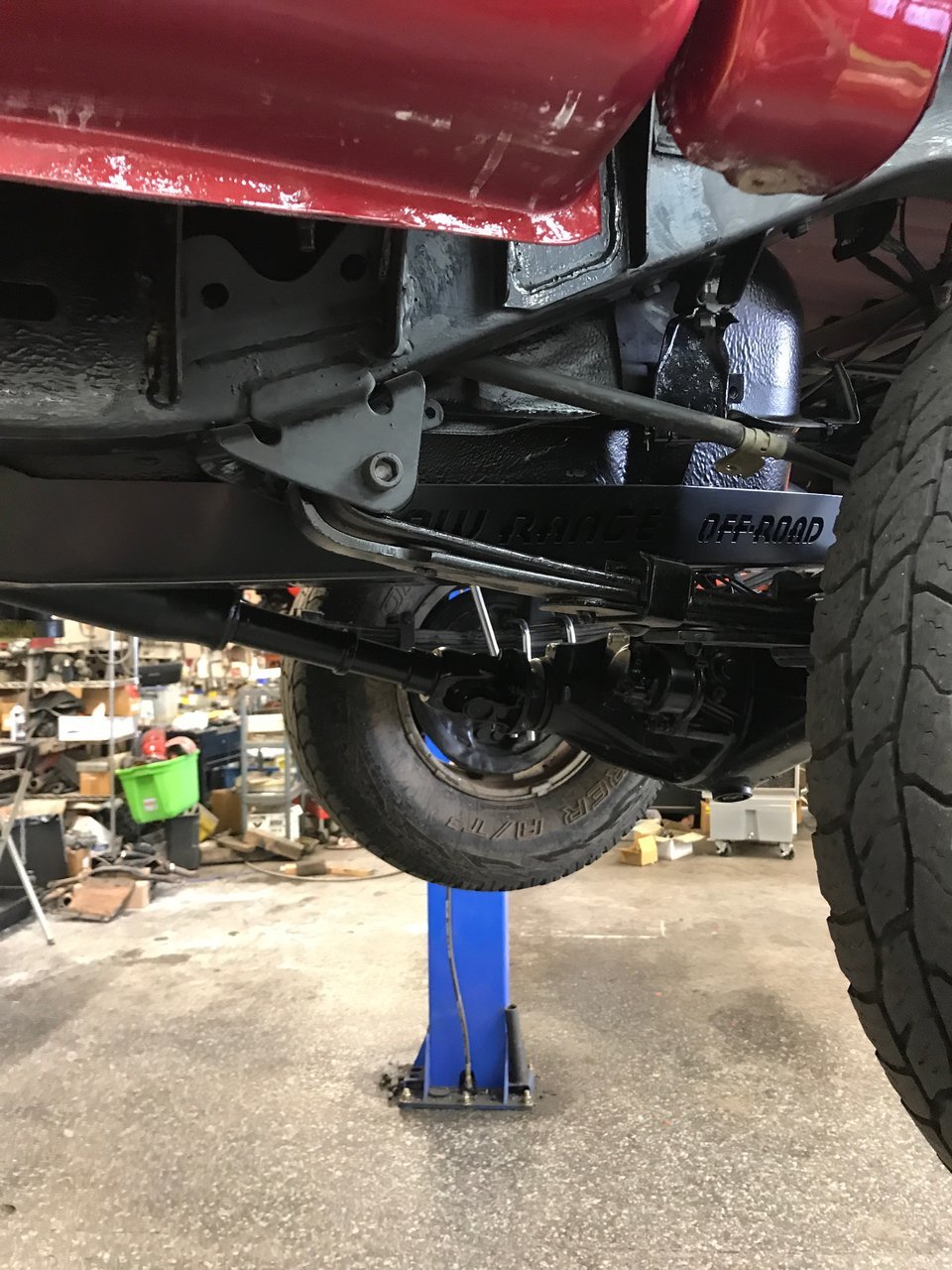

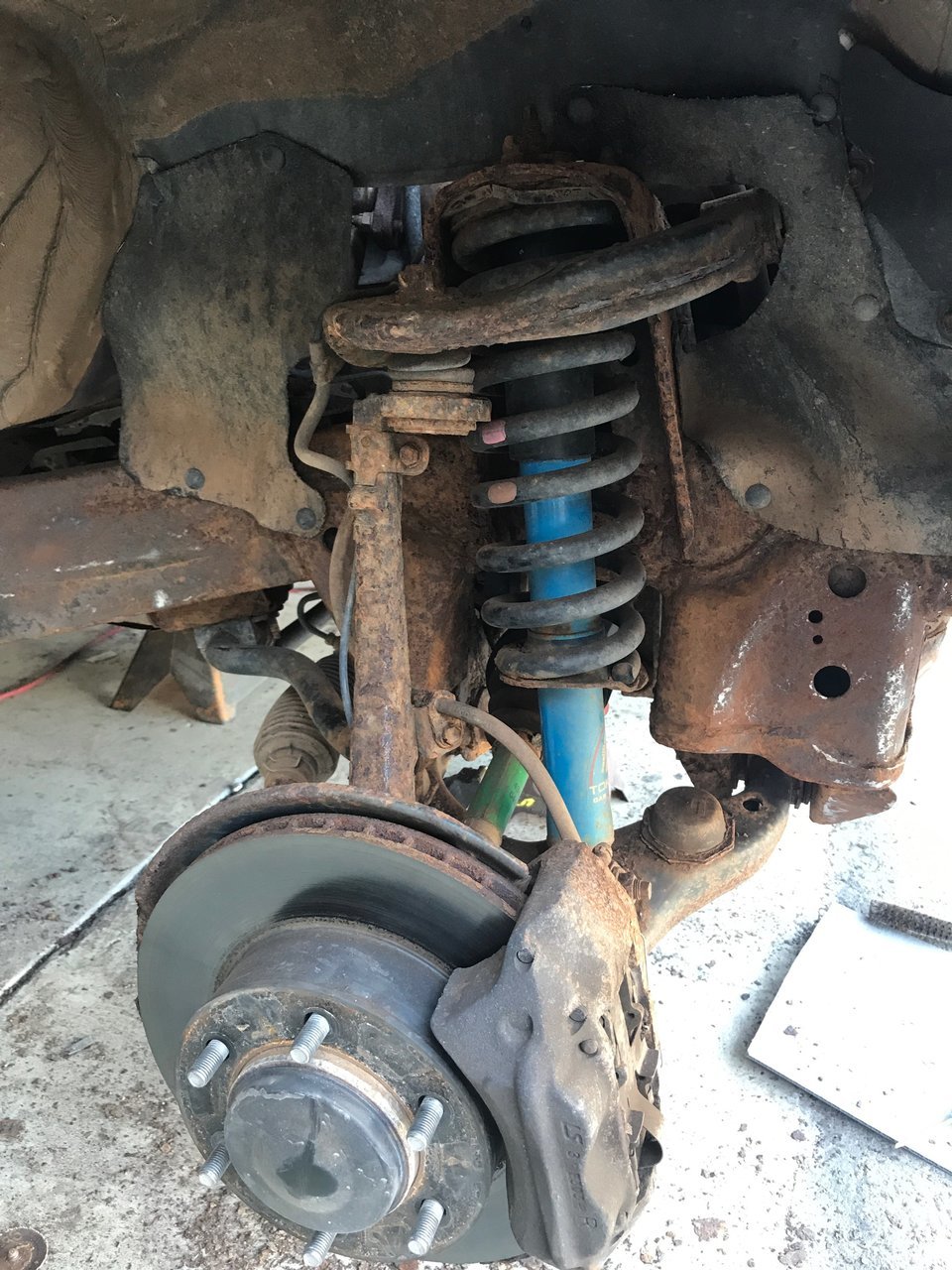

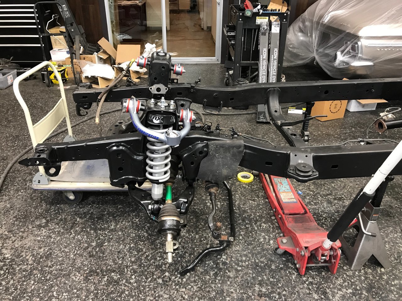

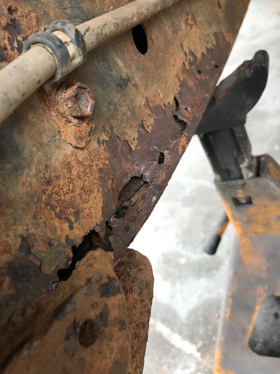

    Curious how bad the frame was? Look at this mess:

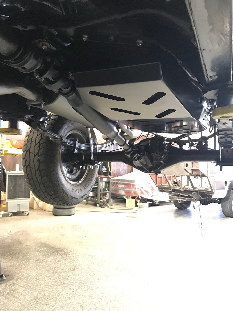

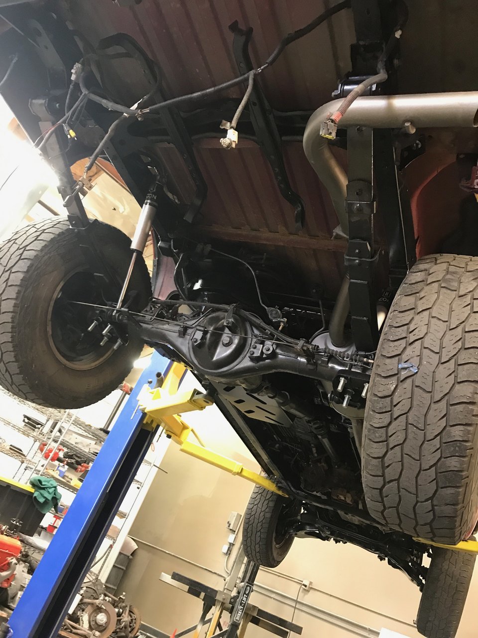

    It was... bad. This is how Rusty's underside looks now (still old tires/wheels in these shots):

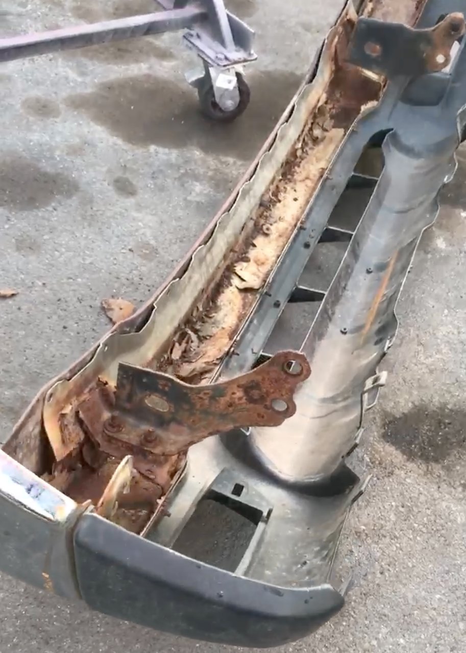

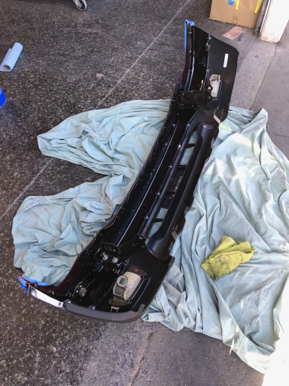

    When we removed the original front bumper we found just how bad it was rusting (from the back of the bumper out):
    My brother decided to mitigate this with some POR-15 on the back inside of the new replacement bumper before it was installed:
    Something you may want to consider if you replace your OEM front bumper and live in the rust belt.

    Glad to see you are now enjoying your truck :)
    whoa! at the bumper bracket O_O
    You know the frame rust is really bad when even the bracket is this rusty!
    Glad you got a rust-free frame

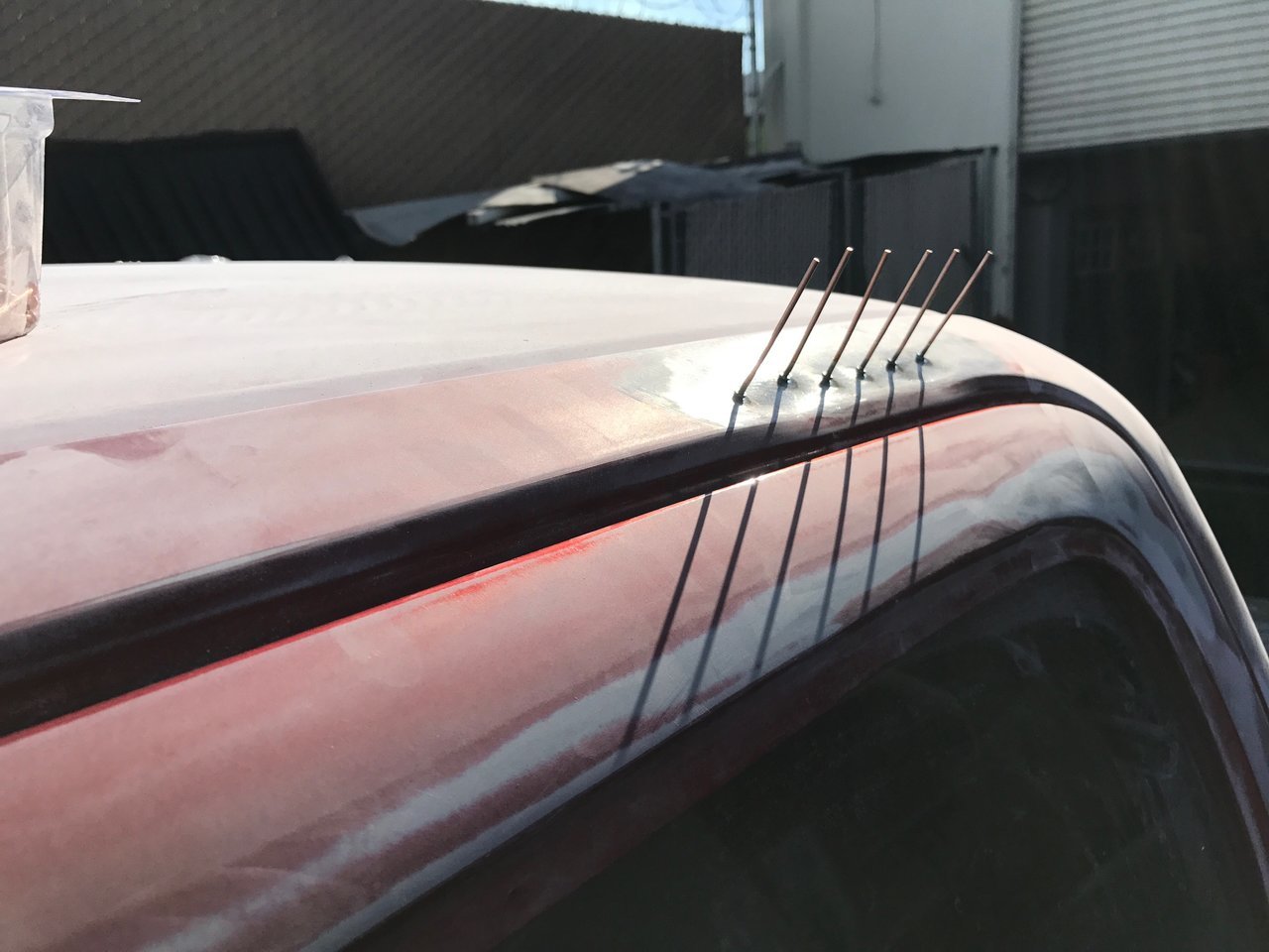

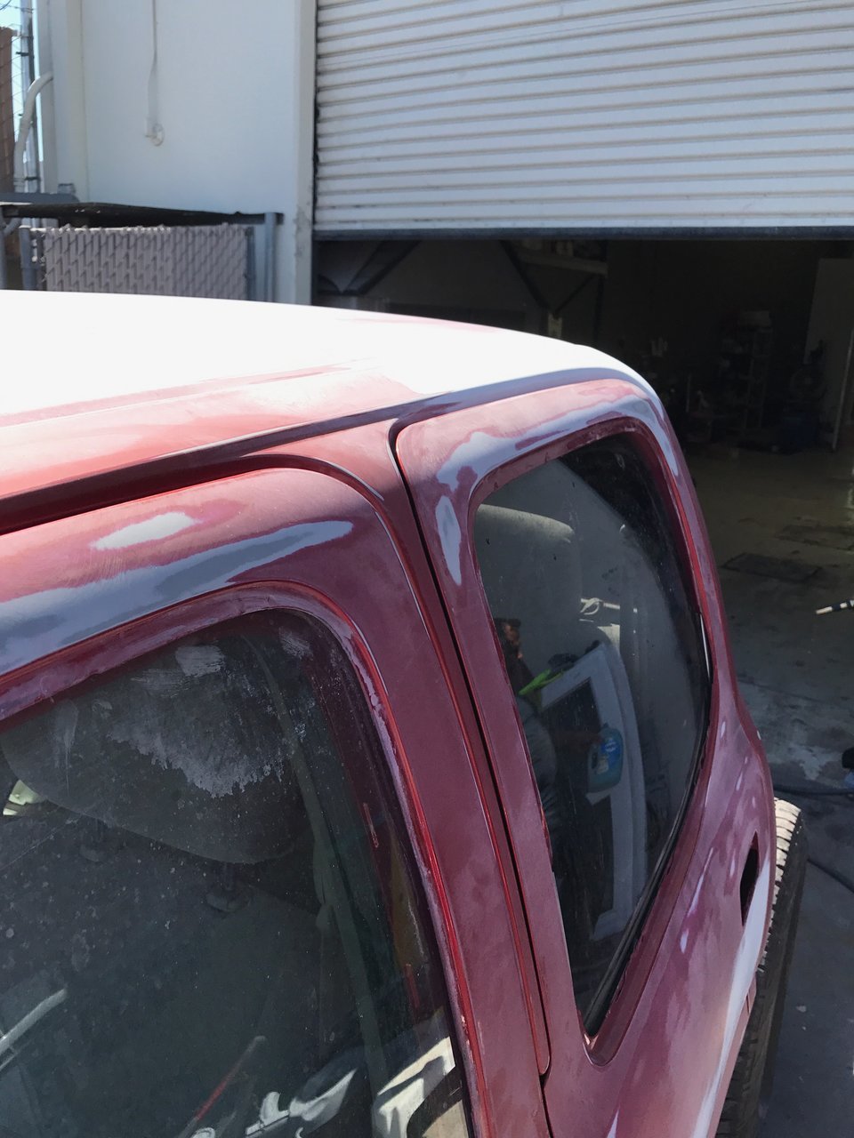

    My brother runs a pretty high end shop - for a paint job like this without any dent repair the cost from him would be in the $5K range if the jams didn't need to be redone (same color). In this case there was some other damage that needed repair. The original roof rack had been overloaded and managed to dent in the roof just above the roof rails:
    That required some body work:
    That $5K estimate is because he does primarily high-end restoration mods - I just got lucky getting it into his shop. You can probably find a local shop that can do it for less, depending on the quality you want. This has 4 coats of clear and multiple color sanding sessions.

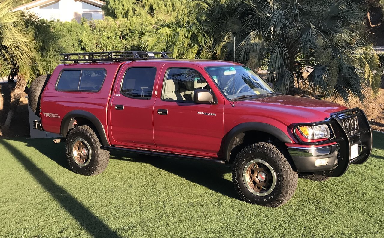

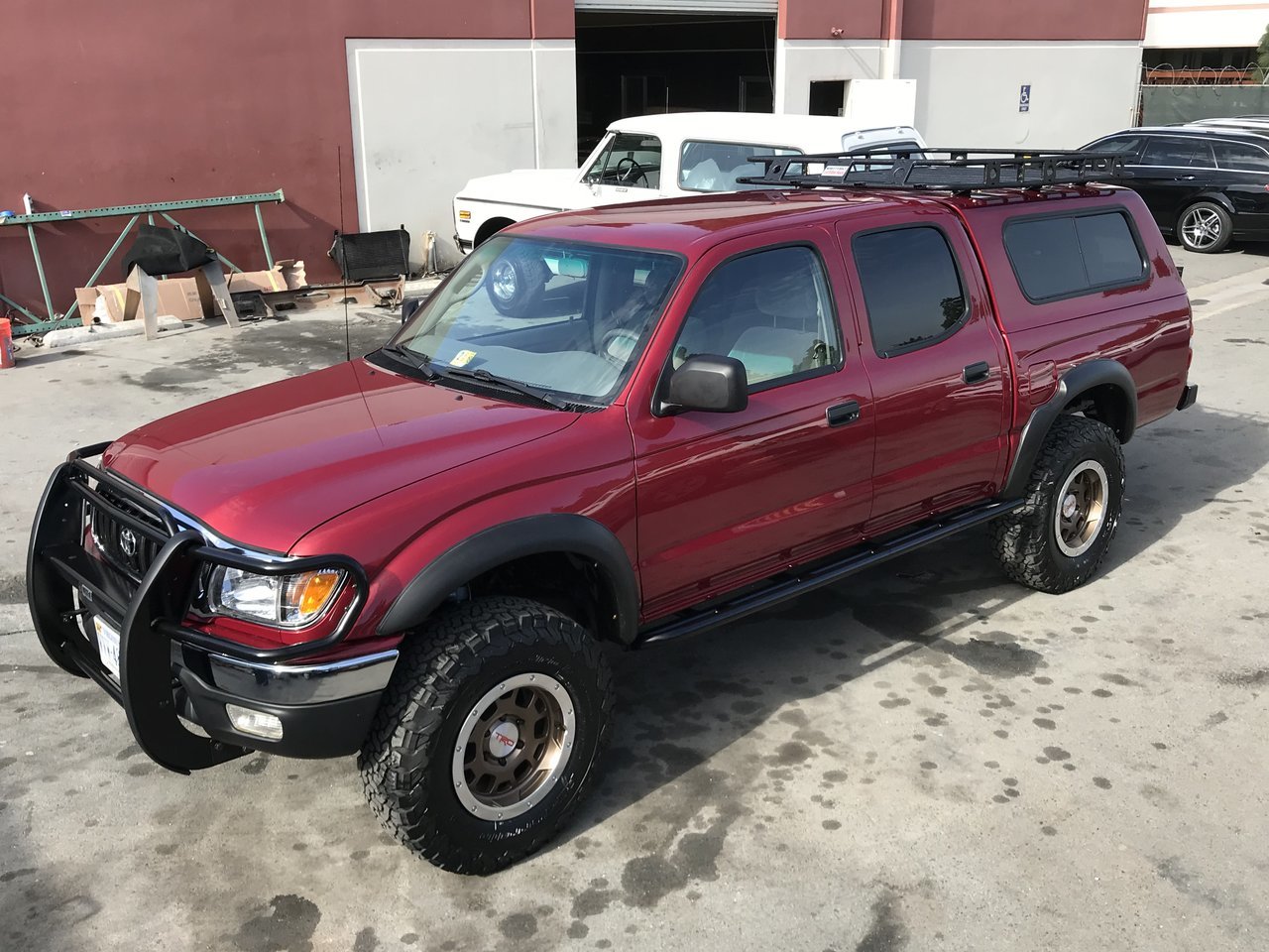

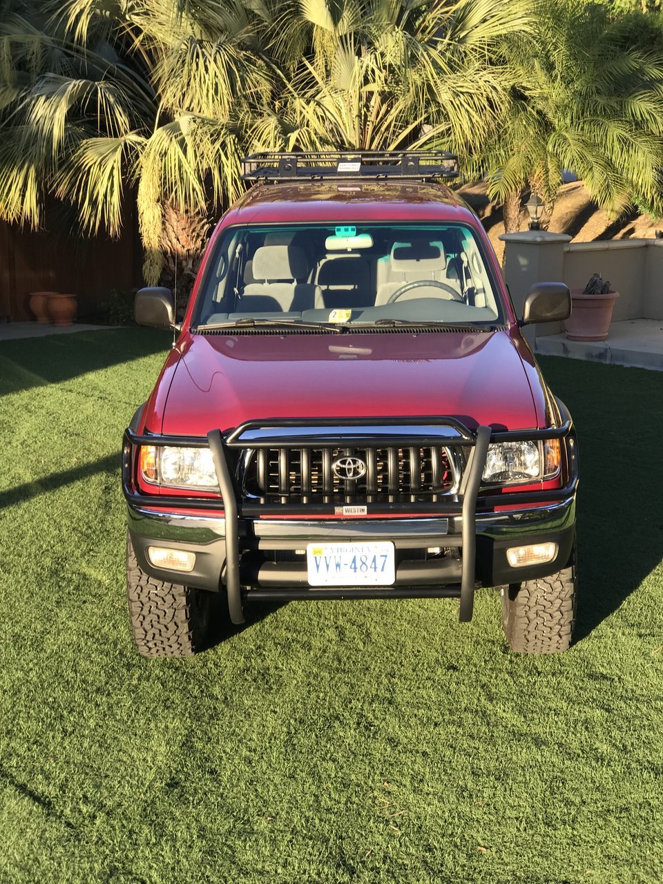

    Got the decals and badges on. Rusty is ready to drive across the US.
    9511B9CE-92E0-48CC-847F-D33128F83A81.jpg 612B438A-1EA8-4DEE-A7E5-C09CE7DD0938.jpg 040193CC-4066-4D94-BD5B-043A60F851E2.jpg 0EB086D1-57B1-4AF8-BDD6-212AFAD065B3.jpg

    Took this after navigating the 1+ mile off road trail to Devil’s Bridge in Sedona AZ. Not a very difficult trail but hilarious to watch the guy in a stock (and brand new) Ford Explorer following me. Dude tore the bottom of that new truck up and gave up about 1/8th of a mile in. Must have been a rental.
    SwampYota likes this.

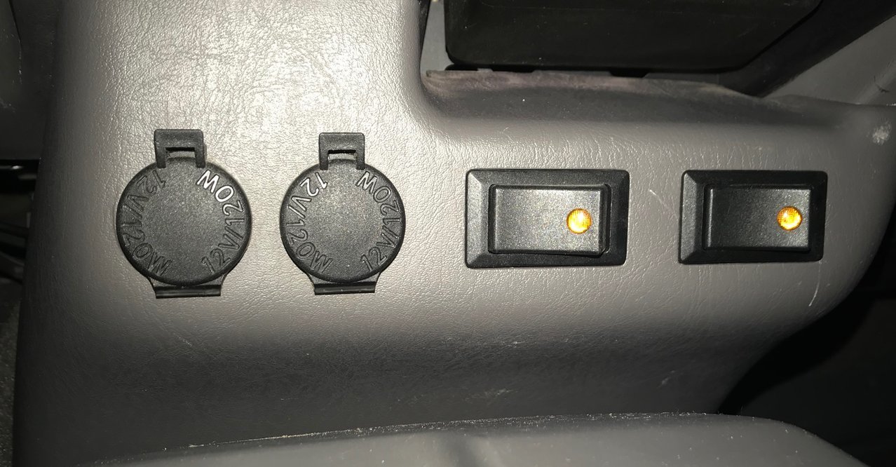

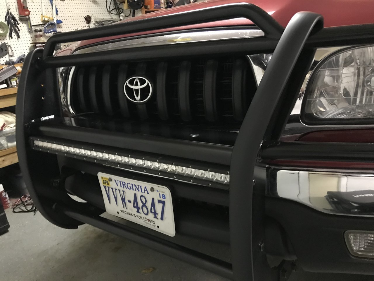

    Added a 32” light bar (got in a swap, no branding on it) and some switches that plug right into the two factory blanks I had. Super bright light.
    3CA8FD89-2FF5-4D0A-BDBF-37015C397CBE.jpg 6D302AF8-54A8-4F2A-9661-AE5504D8C334.jpg
