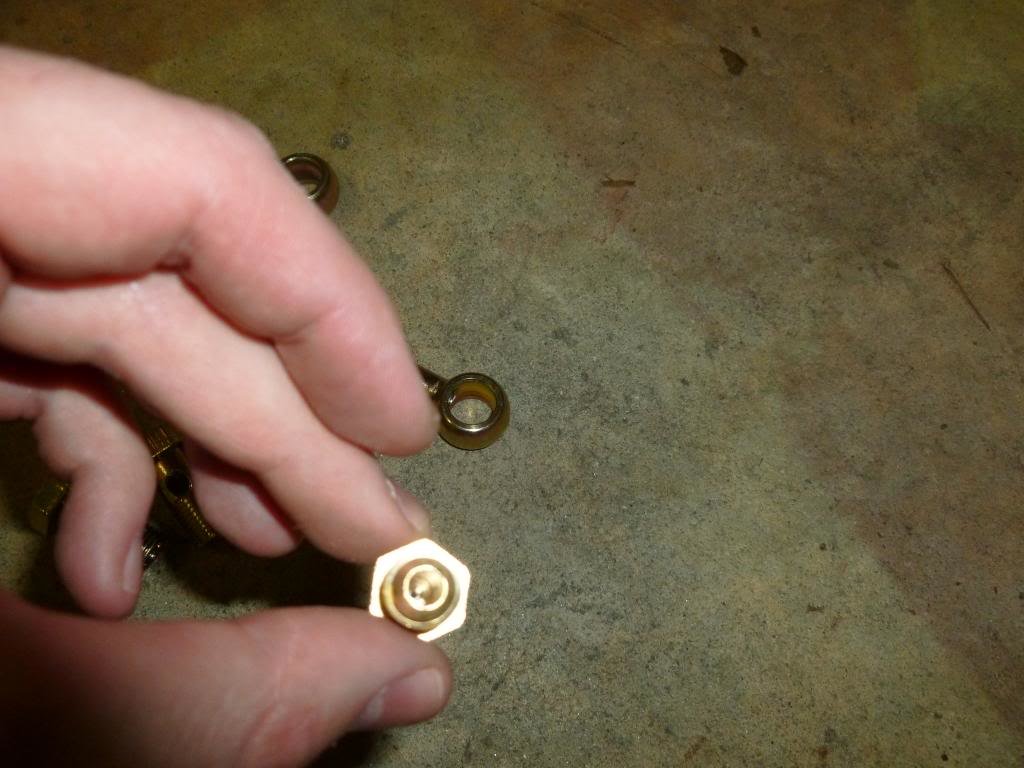

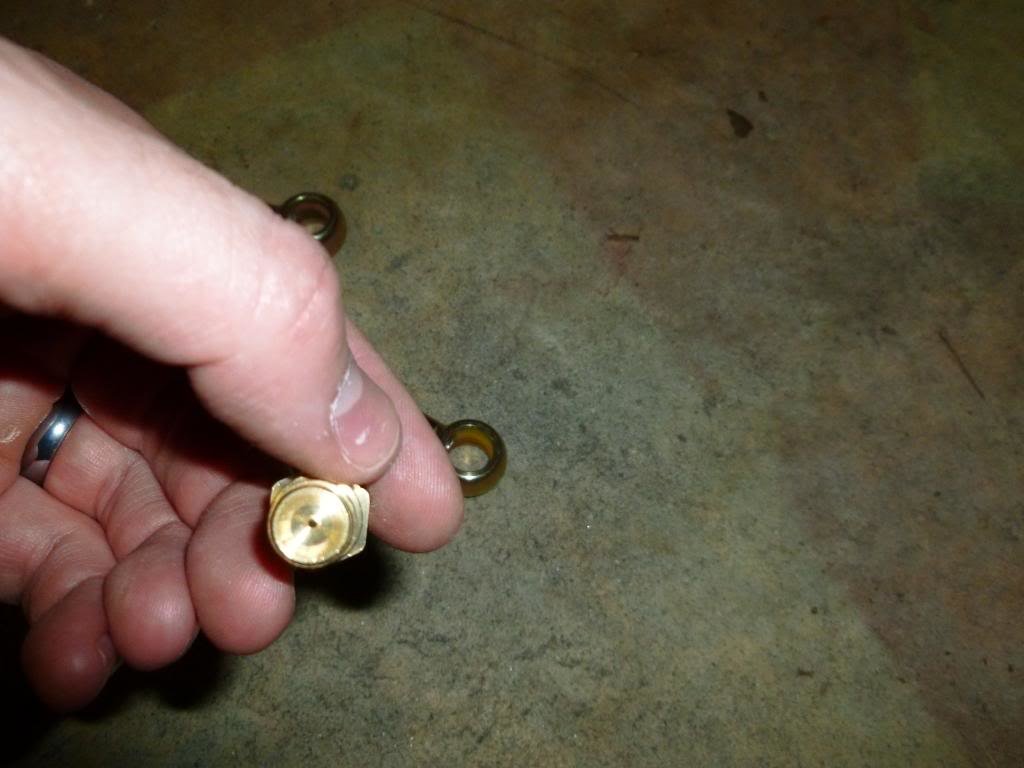

    So I started going through the kit and mapping out the install in my head.

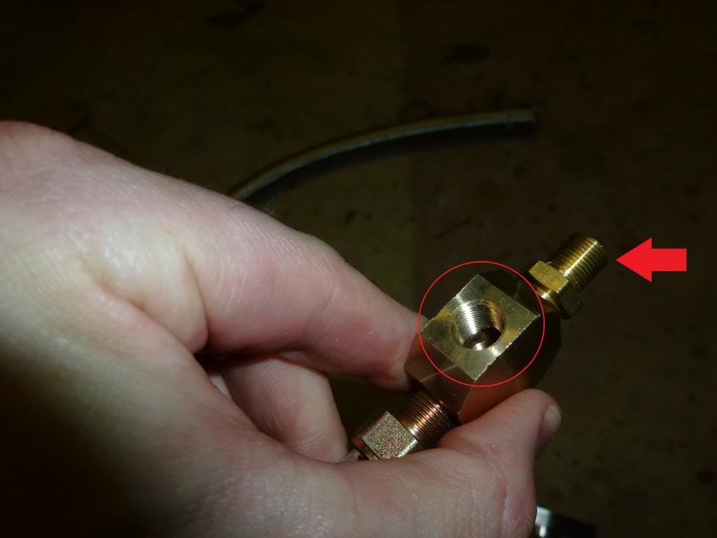

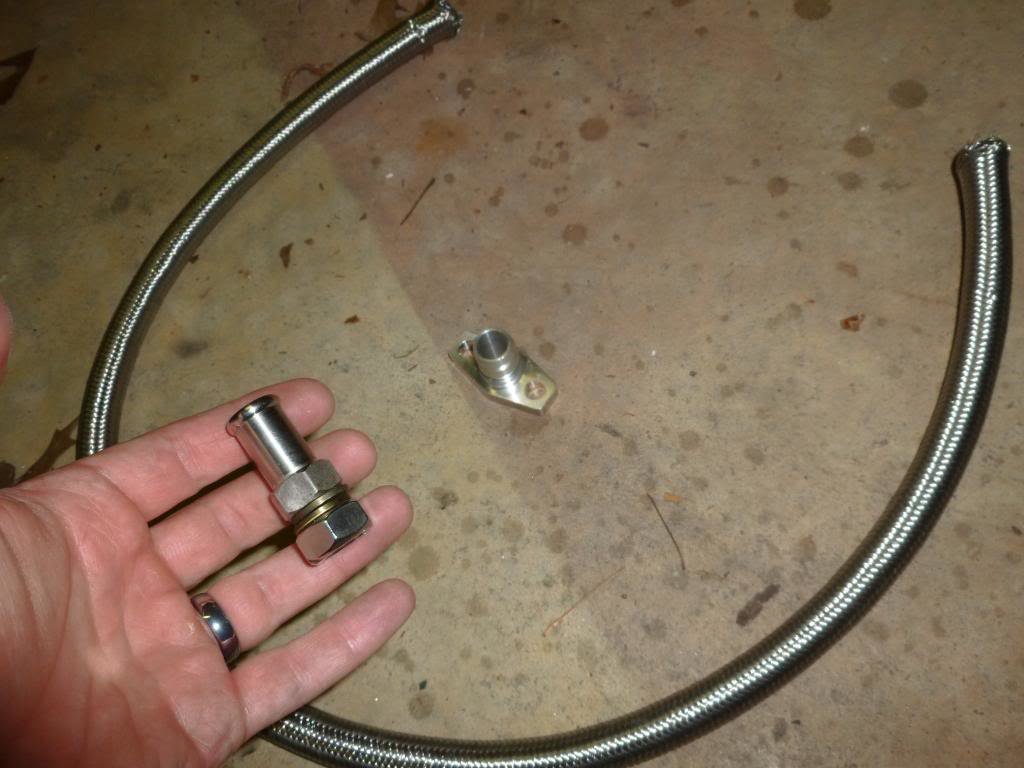

    Good news is the oil feed is not via a plate located between the block and oil filter. Bad news is the install instructions I got said to use a plate (and has a picture of said plate installed). The oil feed looks to come from the oil pressure sensor but there are no instructions on how to install so we're going to have to figure it out ourselves (I emailed CxRacing for updated instructions but not holding my breath. Not the best customer service, not because they are dicks, but very understaffed).
    Other good news is they provide water feed pipes, I just need to purchase some hose and t-fittings.
    Pics bellow with commentary:

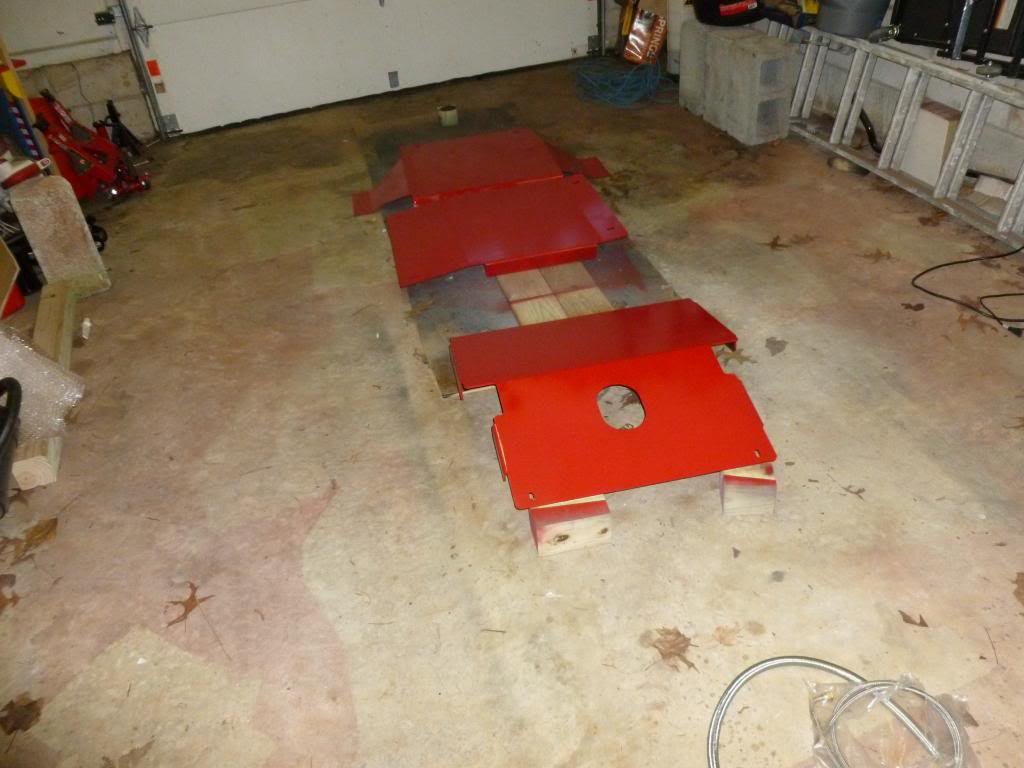

    First, skid plates are ready to mount. Ill have to drop the front axle to get the oil pan out for the drain line so these will have to wait.
    Oil feed manifold for the oil pressure sensor??? I dont like guessing so CxRacing better have new install instructions coming out soon :mad:
    All fitting are hand tight but no fitting for one of the holes (I guessing thats for the sensor) and the fitting marked with the arrow is pass through so Im guessing that threads into the block...

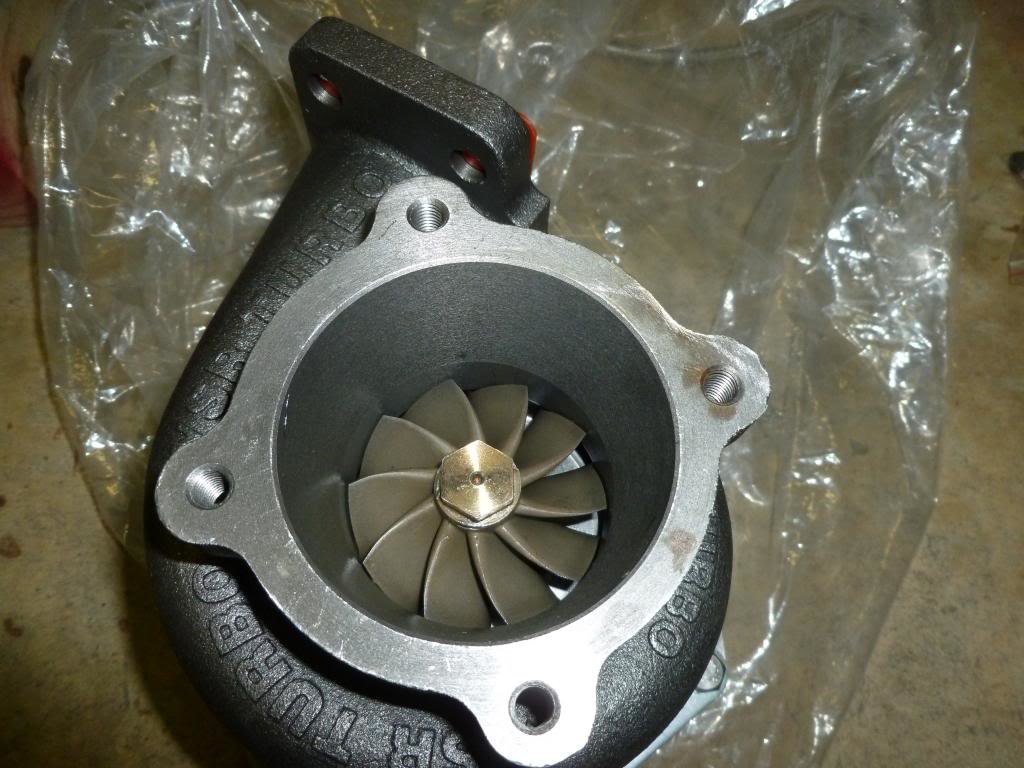

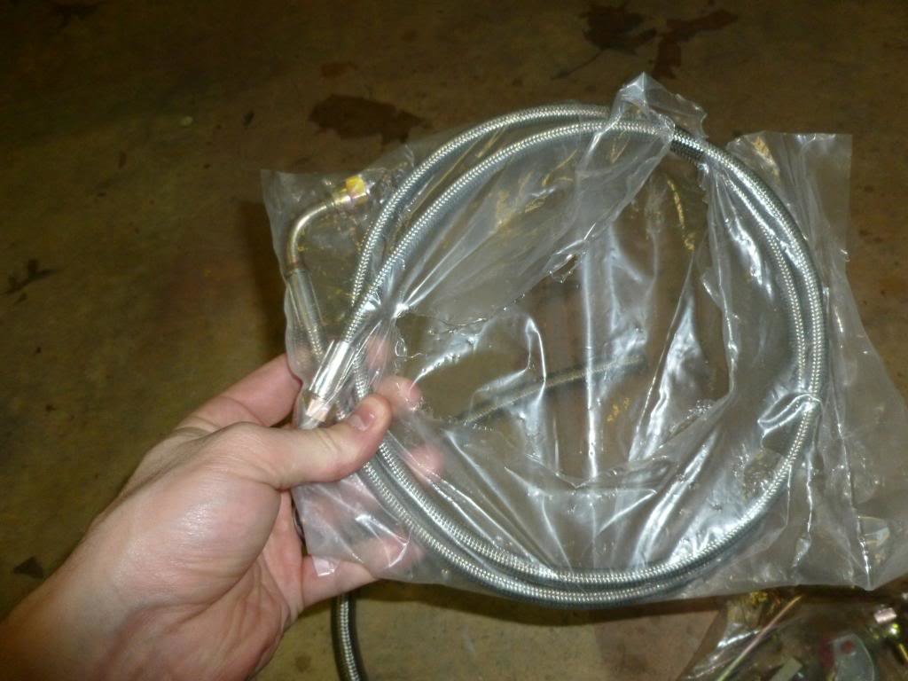

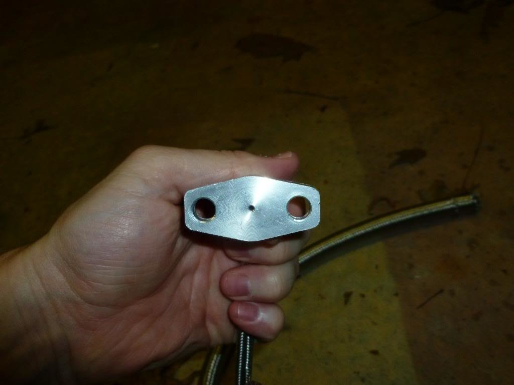

    Here is the oil feed line and turbo attachments (I think they provide two in case you want to attach the oil feed on the side fitting but Im not sure. Not really sure what it could be for other than that :notsure:):
    Pin hole (I was really worried the would screw this up but looks like they know what they are doing)
    Second fitting? Large hole:P1020497_zps64ff0567_7cd45bd141d4a2a6f7a90a7ef9ad858c6169572f.jpg
    Small hole:
    Oil drain line with turbo fitting and oil pan bung
    Water feed pipes (I was so happy when I found these tonight :p). They were not mentioned in the install instructions:

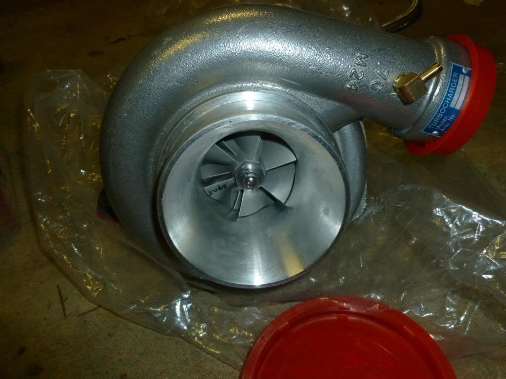

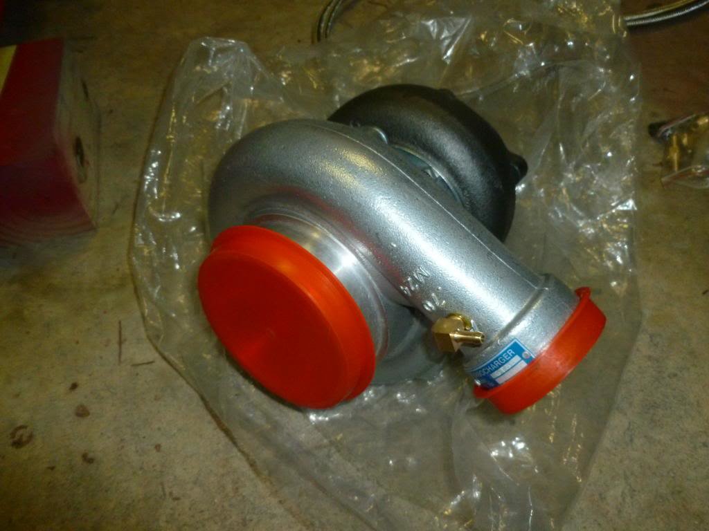

    And more turbo pics just because. Hand is there for comparison. Its a good size snail
    4" intake to 2.5" output
    Hot side
